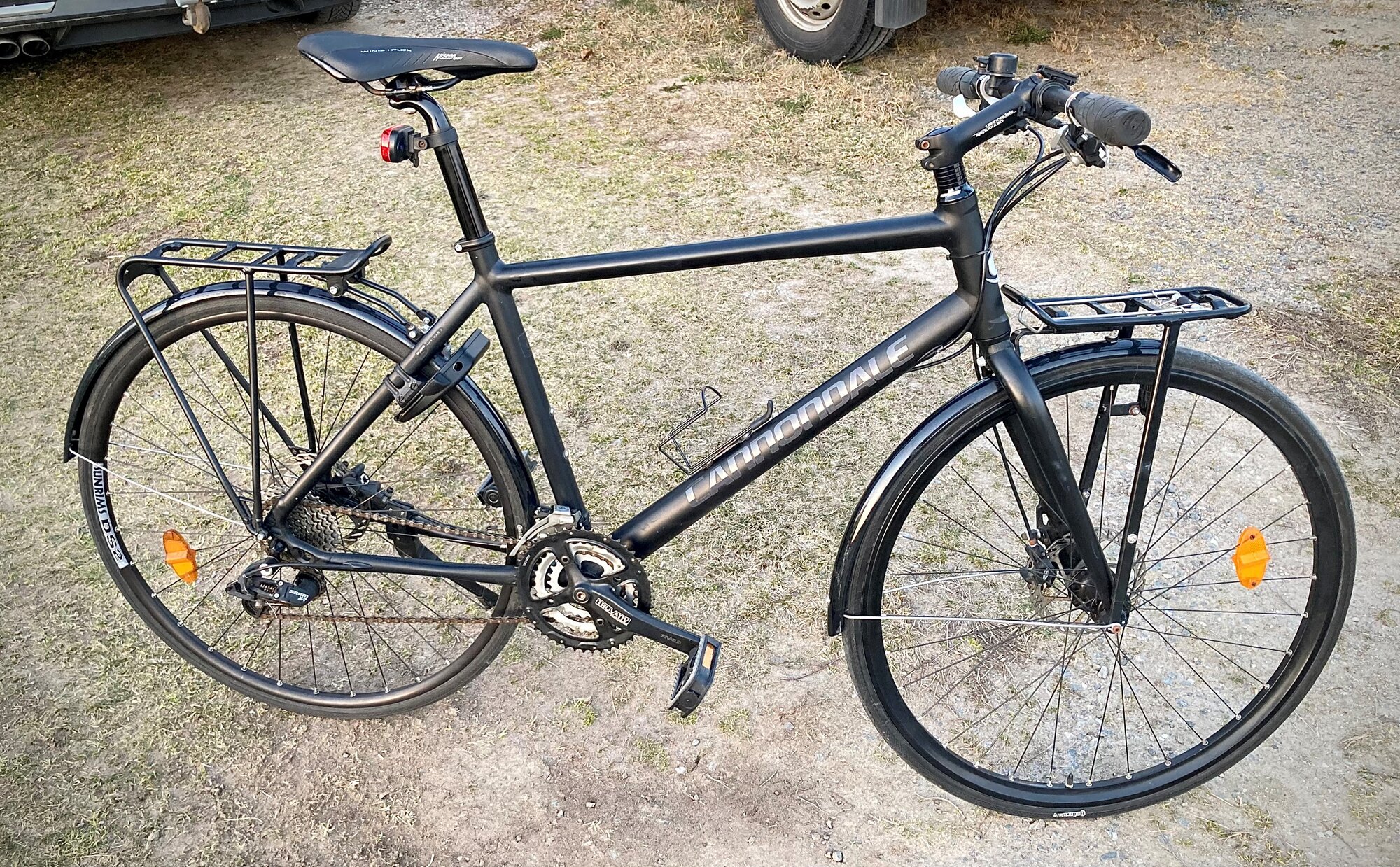

Nice! What kit are you going with?The victim has been chosen. A bit of TLC on the brakes and a new chain, then on to electrification.
From my present design choices I am looking for a kit with a 28" rear wheel motor, somewhere around 750 W and as weatherproof as I can get it, from any of the major brands. Preferably a direct drive motor, otherwise a geared one but I am still not convinced about gears for 25-28 mph continously. Since I am hoping to be able to locate a kit from within the EU, options seem somewhat limited compared to the plethora of Aliexpress or Amazon ads. I could go with any of the latter but customs, taxes and shipping delay are discouraging. Also I imagine any guarantee issue to potentially take ages.Nice! What kit are you going with?
I have not yet found a complete ebike that meets my wishes, and those that come anywhere close start around $5000. There is a reason this thread is in the DIY and kits section.Buy a complete ebike and go from there.
Go to eBikes.ca. The motor simulator has more than a few motor options. Many available from sources other than them. You can set your desired expectations and include a number of battery choices to experiment with. Some better quality direct drives are well suited to staying dry. See their YouTube vids for additional details on water intrusion when setting up kit wiring.From my present design choices I am looking for a kit with a 28" rear wheel motor, somewhere around 750 W and as weatherproof as I can get it, from any of the major brands. Preferably a direct drive motor, otherwise a geared one but I am still not convinced about gears for 25-28 mph continously. Since I am hoping to be able to locate a kit from within the EU, options seem somewhat limited compared to the plethora of Aliexpress or Amazon ads. I could go with any of the latter but customs, taxes and shipping delay are discouraging. Also I imagine any guarantee issue to potentially take ages.
Yes, I have used that simulator and also the trip simulator to verify performance against my needs. Several motors meet them, but I find it a challenge locating European sellers. Buying a kit from Grin or eBikeling overseas is an option but not top of my list because of added customs, taxes and shipping. (Also, eBikeling motors do not seem to appear in Grin simulators, not surprisingly.)Go to eBikes.ca. The motor simulator has more than a few motor options. Many available from sources other than them. You can set your desired expectations and include a number of battery choices to experiment with. Some better quality direct drives are well suited to staying dry. See their YouTube vids for additional details on water intrusion when setting up kit wiring.
I agree. I'm building a budget ebike that might cost $500.I have not yet found a complete ebike that meets my wishes, and those that come anywhere close start around $5000. There is a reason this thread is in the DIY and kits section.![]()
