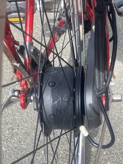

I am considering alternatives for the Shimano Nexus 8 IGH I currently pair with a Bafang BBS01 mid-drive on a converted Breezer Downtown with horizontal dropouts. I was contemplating either Enviolo cargo or Shimano Nexus Inter-5e. Both appear to be stronger and able to take mid-drive torque. Are there particular issues with mounting the Enviolo? I seem to recall reading somewhere the action of shifting tends to pull on the hub which can loosen belt tension but my frame doesn't have a frame break to mount a belt and I don't want to use the Veer split belt so I would use a standard chain and sprocket. All advice much appreciated.

Update: I emailed Evelo and Workcycles who both sell models pairing a mid-drive with an Enviolo hub, and from their replies neither use a gear sensor with an Enviolo hub.
So it’s been two weeks since the bike was converted and I’m getting used to the shifting technique, I pause pedaling to upshift, but I find I can downshift at any time. This is very helpful when I’m climbing a progressively steeper hill and I want to do small adjustments of my cadence without needing to stop pedaling

Hi Al, I used a gear sensor when the bike had the Nexus 8 IGH installed, is that what you mean? With the conversion to the Enviolo Cargo CVT I had the gear sensor removed and so far I haven't noticed any problems.

Time to swap out the studded tires so after work today I took off the back wheel, which involved unhooking the two shifter cables from the manual hub interface, but on reassembly wouldn’t you know it I couldn’t get the ferrule end cap for the cable housing on one of the cables back into place. After much fiddling and cursing the shifter now works, but the ferrule is still not seated in place and the cable is tugging it around the spindle. Hopefully shifting won’t be affected so I can ride the bike to the shop tomorrow morning.
I wanted to learn how fiddly getting the back wheel off might be in case I had to change a flat at the roadside, ah well, it did give me an opportunity to replace one of the axle acorn nuts with my Thule internal hub hitch adapter nut.
Time to swap out the studded tires so after work today I took off the back wheel, which involved unhooking the cables from the manual hub interface, but on reassembly wouldn’t you know it I couldn’t get the ferrule end cap for the cable housing on one of the cables back into place. After much fiddling and cursing the shifter now works, but the ferrule is still not seated in place and the cable is tugging it around the spindle. Hopefully shifting won’t be affected so I can ride the bike to the shop tomorrow morning.
You should be able to pull the tire of the non-drive side, leaving the cables attached. I have a Nuvinci hub sitting in its box. The sucker is Heavy. The five speed Nexus would be better. With power I do not need little increments. I do not like heavy bikes. I rode my three speed coaster brake today. It has a heavy duty chain and is a blast to ride.
The bike shop was able to get the ferrule back into place right away and I was shown where it was sticking, all good again. Swapped out the front tire, the bike feels great now it’s back to regular touring tires.
