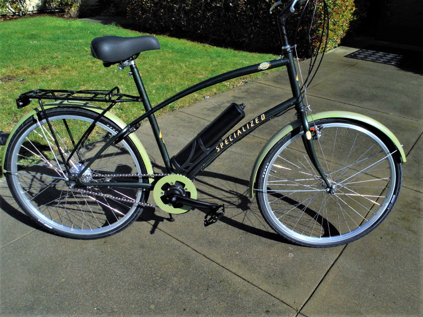

I just made this one. It has a perfect Nexus 7 with built-in roller brake. The bike is 25-years-old. I used the super strong KMC e1 chain. They are hard to come by but worth it. I stripped off all oils and then used MucOff C3 dry ceramic lube. It is amazing how much crud comes off of a brand new chain. It will stretch by the second week as part of break-in. Because the rider is older and lives on a hill, I used a 36-t narrow/wide ring.
