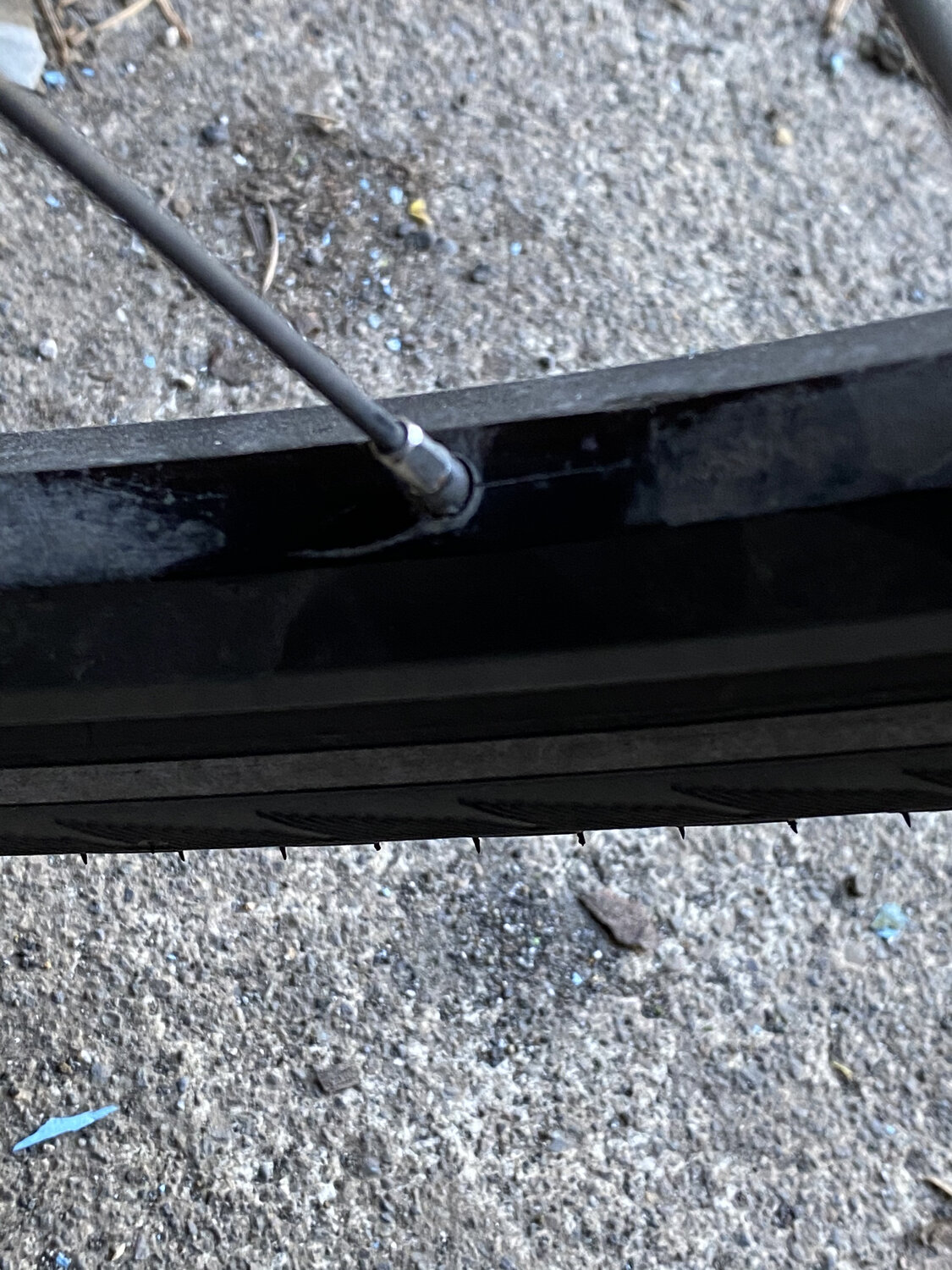

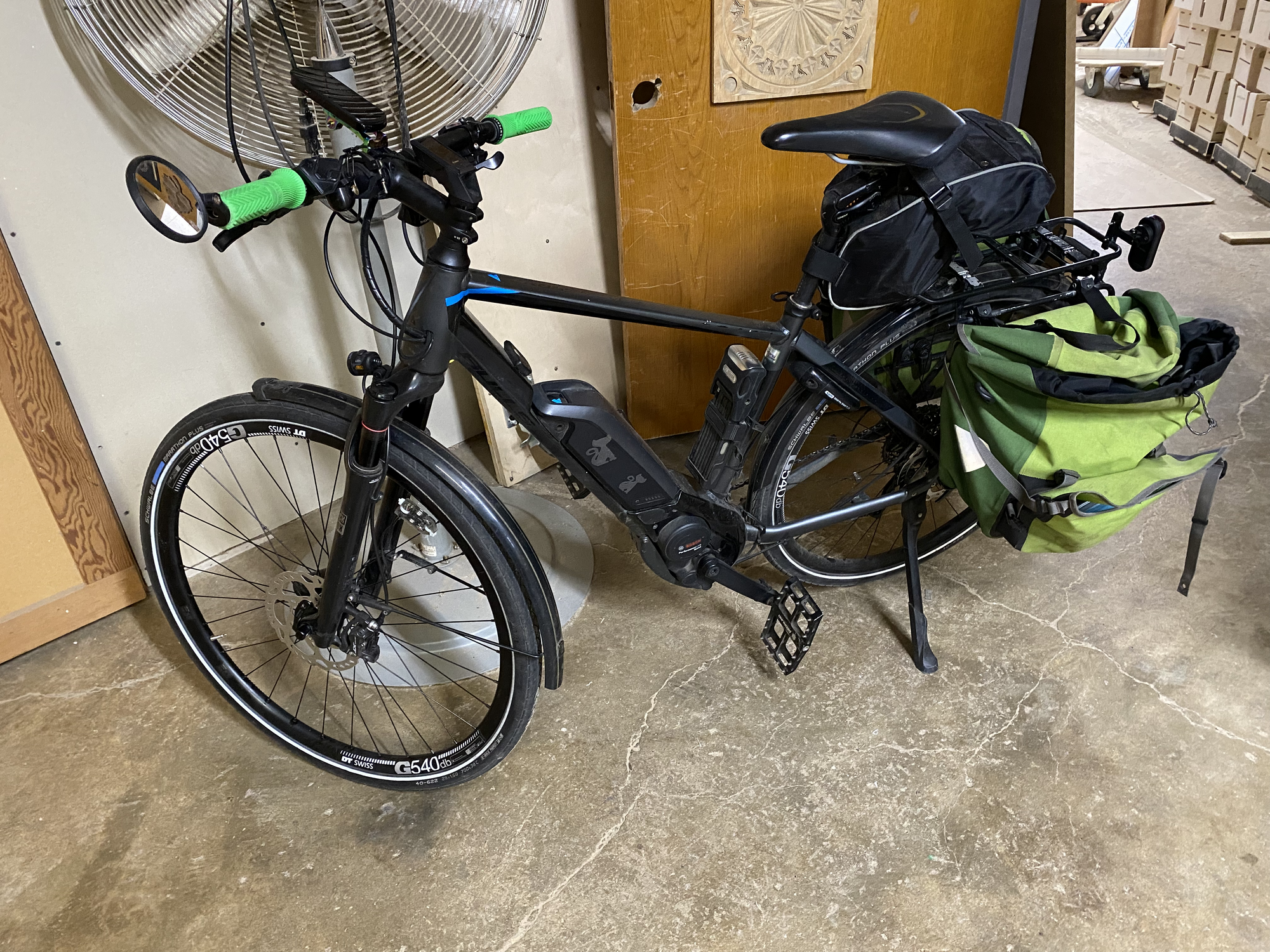

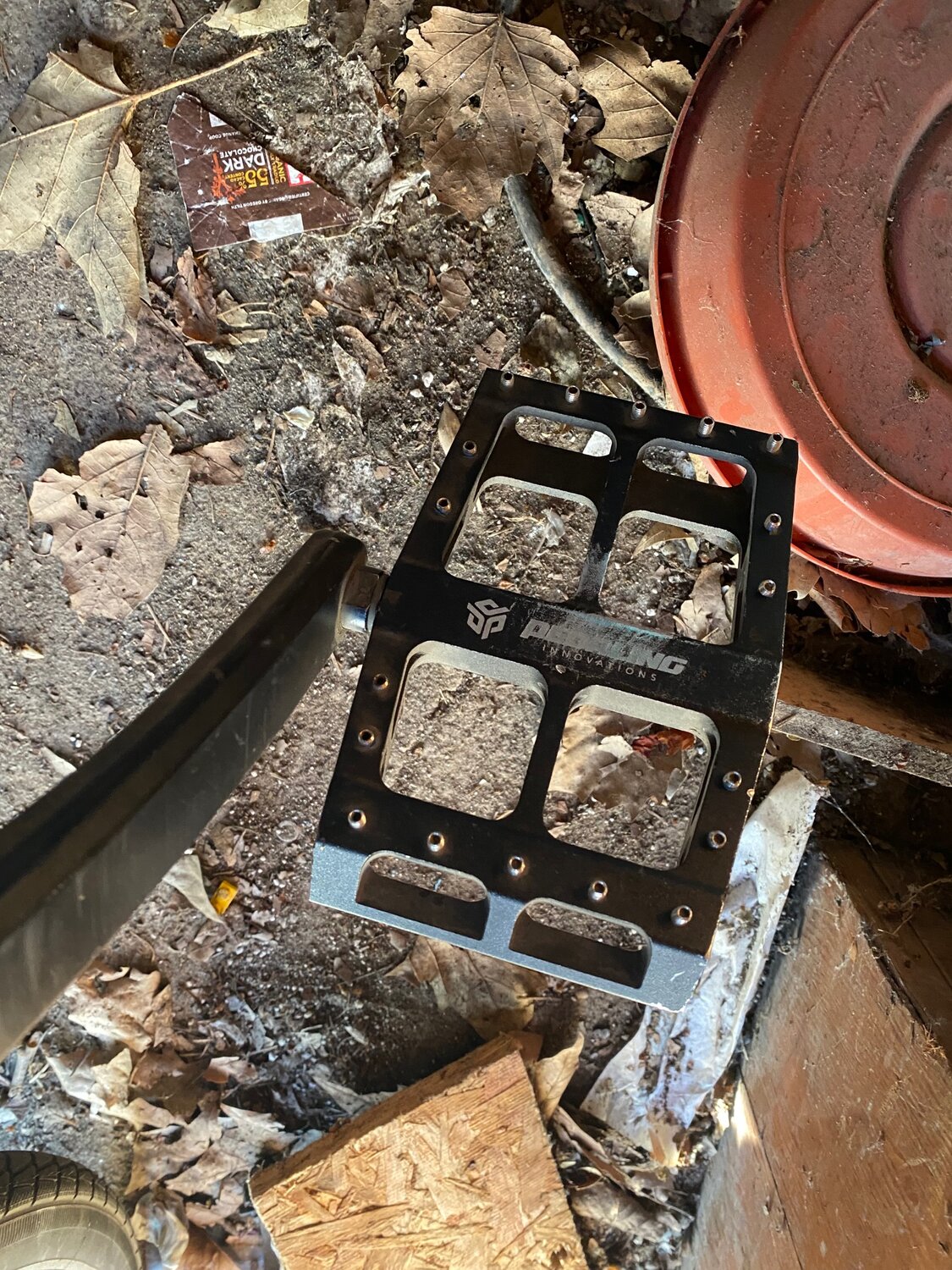

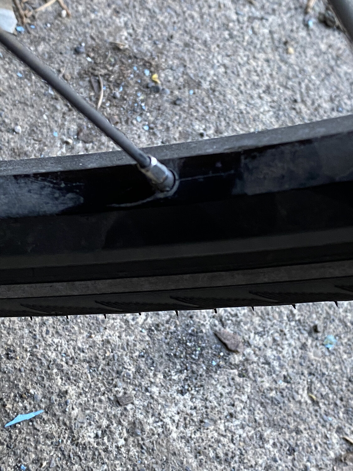

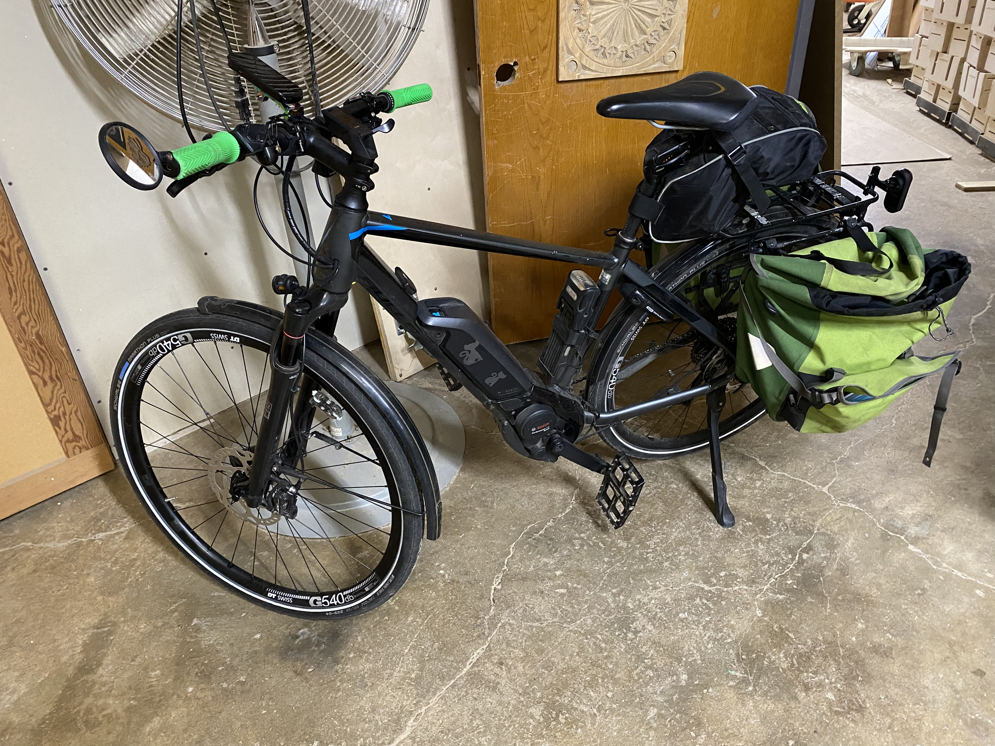

Got over 9000 miles on my bulls crossover. about 1.5 years of riding. got great life out of the Schwalbe Marathon plus about 8000 0n the front I screwed the back up so I can't know how long that would have lasted. on the 5th chain and the shifting is getting a little clunky.one shifter cable cause there was no practical way to lube it so I replaced it. headset bearings were not sealed and after months of riding in the rain they were leaking rusted grease. rear wheel rim had cracked after 9000 miles shop said it was just normal wear and tear. but it was a cheap rim. I was hearting a clicking sound I could not find out what it was. Mechanic found it the pedals are all sloppy. well about 8000 miles on them rain and shine so they need rebuilt but that's only about 20.00. second set of hand grips just replaced those cant complain about that life. I ride every day ifI am not injured and there is no ice or snow on the ground. I got 156 miles this week and I got 6000 miles in a year.

i.e. the spoke thing: a few day ago I hit a hole & tore the nipple right out of the rim.(panic.´ my motor wheel
is ruined´) I had some small grommets for leather work, After slightly widening the inner hole with a dremel,
I mashed 2 male pieces of grommet together with J.B.Weld after roughing surfaces. Liberally coating the
inner surfaces with glue, I pressed the grommets into the hole. As luck would have it a new nipple fit snugly
into the grommets & onto a new spoke. I tightened it up & let the glue cure, & viola´ good as new.

Well I rebuilt the peddles and I think one the sloppy one was missing a bushing. or it fell out when I was removing the bearings. hard to know but they are back to good now.
