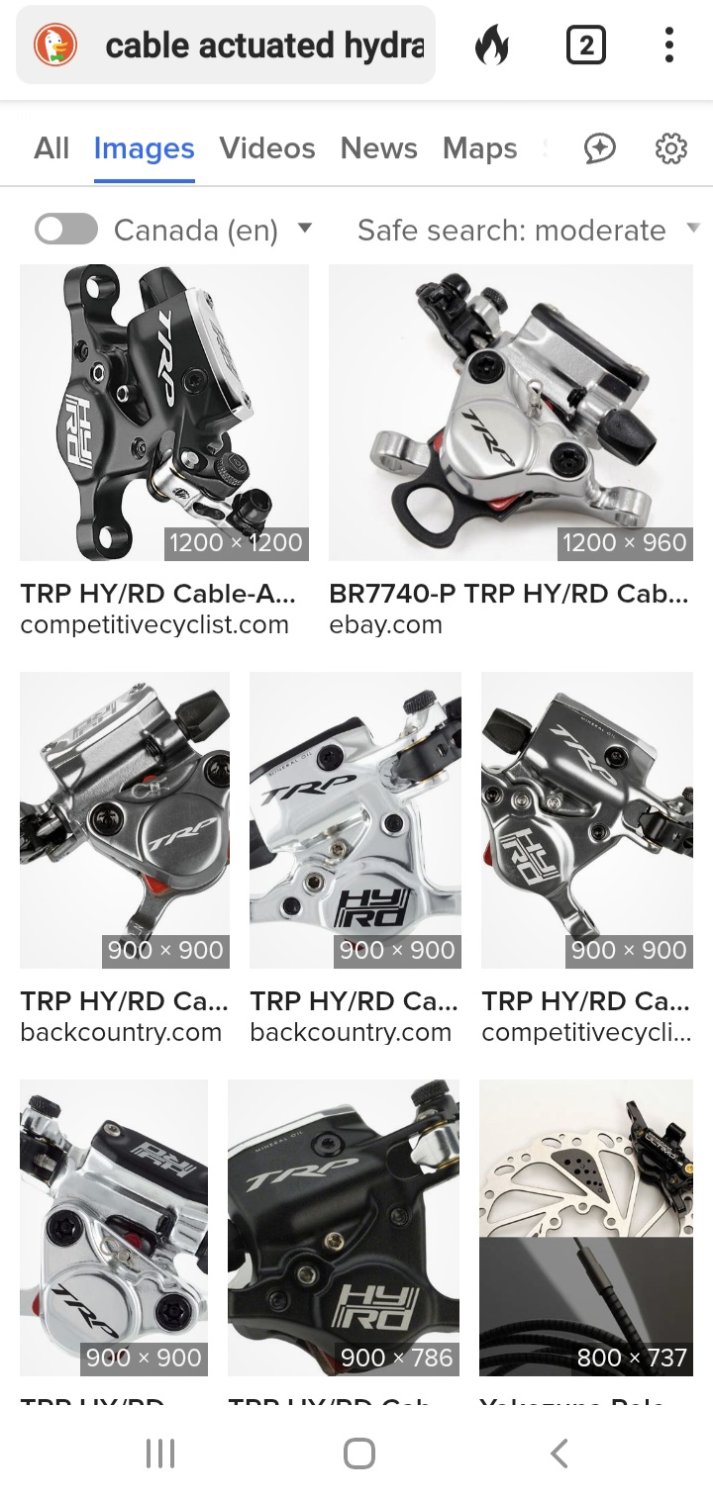

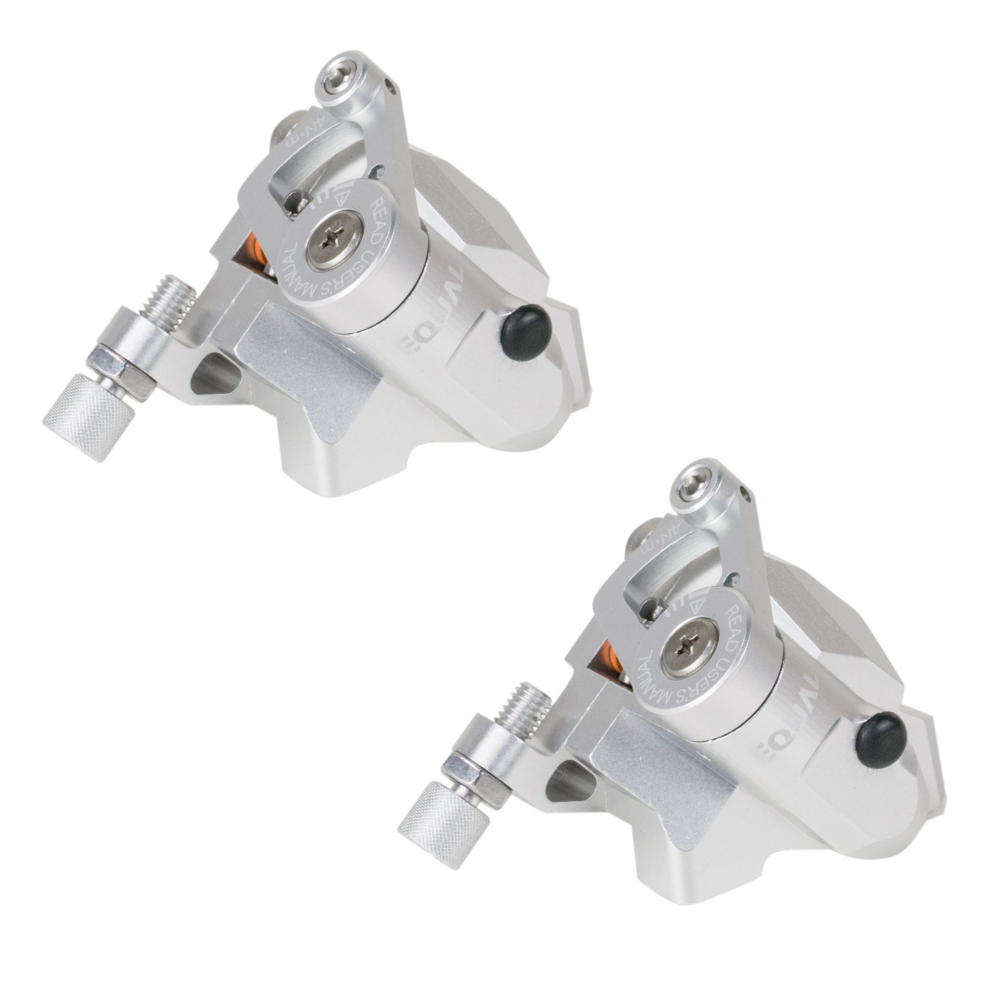

There are cable actuated hydraulic calipers available that can vastly improve your braking,..
You can probably upgrade your rotor to 180mm with a caliper bracket spacer, then upgrade the brake cable to a low stretch, low friction cable (expensive version of a regular brake cable) and install everything into your current brake lever assembly.
Apparently, the cable actuated hydraulic calipers work Very well.

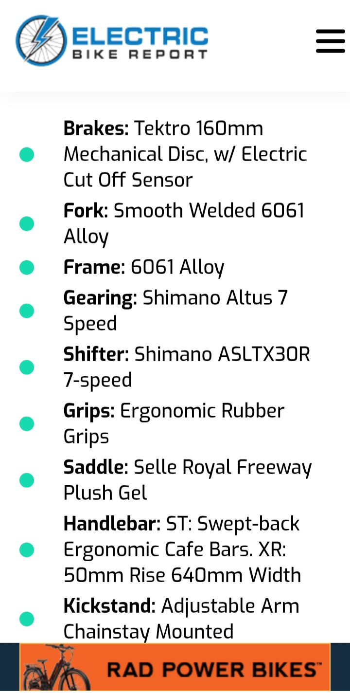

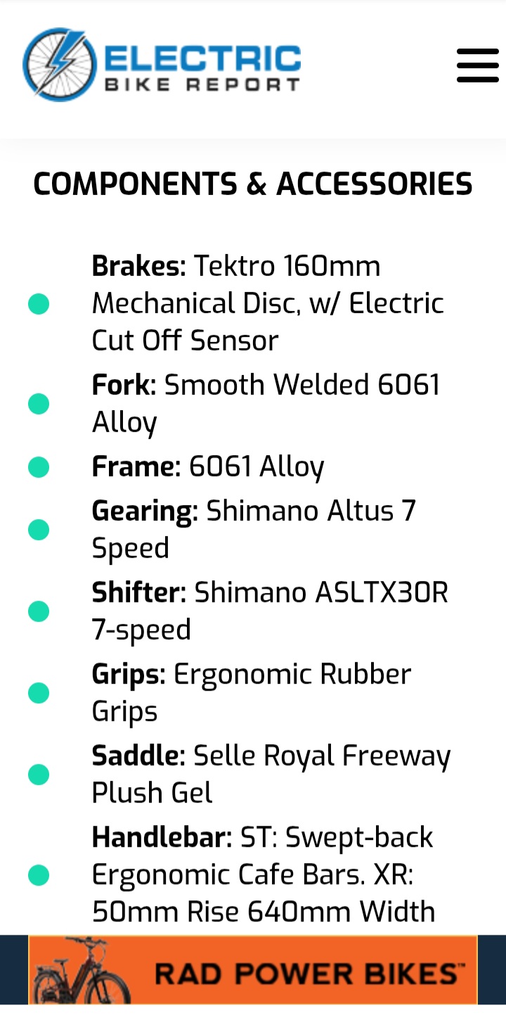

That's what's supposed to happen but you've got a hub drive motor with brake cut-off switches.
Things can go wrong and it Really Is a good idea to keep the switches.
