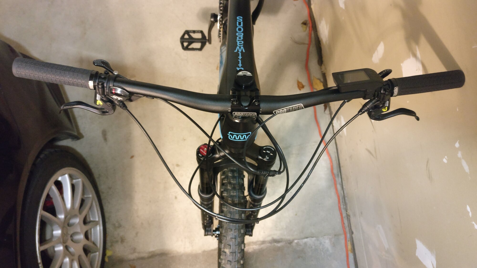

Cockpit cleanup day!
- 2 finger brake levers
- 500C display (version 5.2 and they still don't have the battery gauge scaling with the battery voltage setting)
If you want some little snappy thingies to fix your cables together that still allows for some movement & manipulation of the cable in the clip, Jagwire 4mm/5mm & 4mm/4mm cable hooks are really great! More expensive than zip tires of course but they're easily removable and reusable. They also have some rotating hooks for clipping cables that don't run next to each other together. Bummer to hear about the 500C, I picked up one with my backup M620 because it's nice & small while still giving lots of info but I guess it still lacks a little functionality eh?
Good info on Jagwire.
Have you used their Stick on guide below, and if so do you know if they hold on a flat surface? They have a curved based and I wonder if they are flexible enough to stick on a flat surface.
@scrambler they're aluminum so I wouldn't think they'd want to flex an awful lot, but if you could flatten them they probably won't want to flex back. I don't like non-permanent adhesives on finished surfaces though so I would opt for the little plastic cable guide clips meant for brazed or welded guides on the frame (if it's a metal frame, and those guides would be pained/coated like any other part of the frame). My stuff is all internal from headtube to rear stays so I could avoid all that mess - wish I could help you out there more!
I'm even looking to get a longer cable for my display to solder in place of the short one that comes with the 500C so all my connectors go inside the cavity between the headtube and battery compartment of my frame. Outside though the cables are in 3 main runs; display & dropper together, shifter & rear brake together, and then the front brake that's run along the dropper & display with 2 clips then also clipped to the rear brake with one of the rotating clips before going down to the fork. The rear brake is also clipped to the dropper cable housing where they cross; the clip is snug on the 5.5mm brake line but slides freely along the 4mm cable housing when I turn back & forth. The cables all stick out about 105cm forward from the headtube and aren't pulled tight when I turn as far as I can in either direction, but I am including a bumper thingy to prevent hitting the carbon frame with the tops of my stanchions ala some Specialized frames. It's a piece built into the battery retention plate (the front one with the lock) that holds some rubber bumpers. The original design makes it easy for my to print a thick piece so the force is spread through the bracket before going to the frame. Note I have a Dengfu E06 so this whole bumper thingy now is just me going off on some weird rambling tangent instead of getting out the door to take the dog on a hike like I intended to...

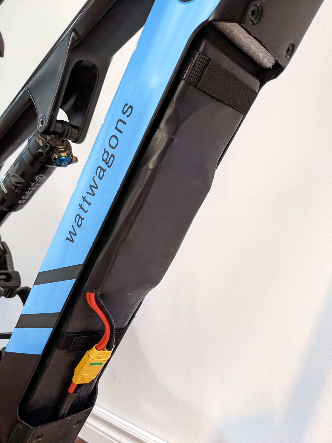

I finally got around to installing the 52V, 20Ah battery I built with Samsung 50E2 21700 cells. 14Ah just wasn't enough for me.
It sits on high density foam and is strapped to the cable management clamps with Velcro. The battery cover also has high density foam that pushes against the battery.

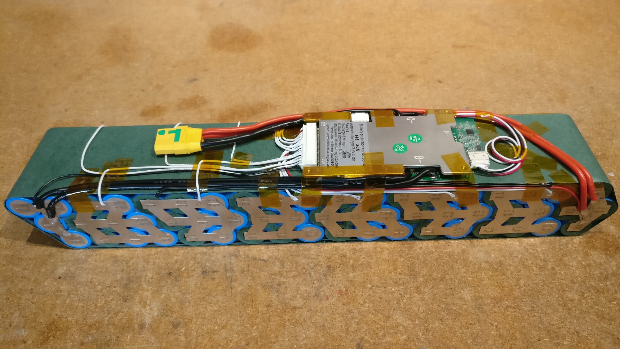

Here are some details of the battery build for those interested...
The parallel cell groups are matched by internal resistance and isolated from eachother with kapton tape. Cells are glued together with neutral cure silicone. Balance wires are isolated from the cells and power wires with kapton tape. Cells are spot welded with 0.2 mm pure nickel. I used the same 30 Amp BMS model as my original battery. The connector is an anti-spark XT90.

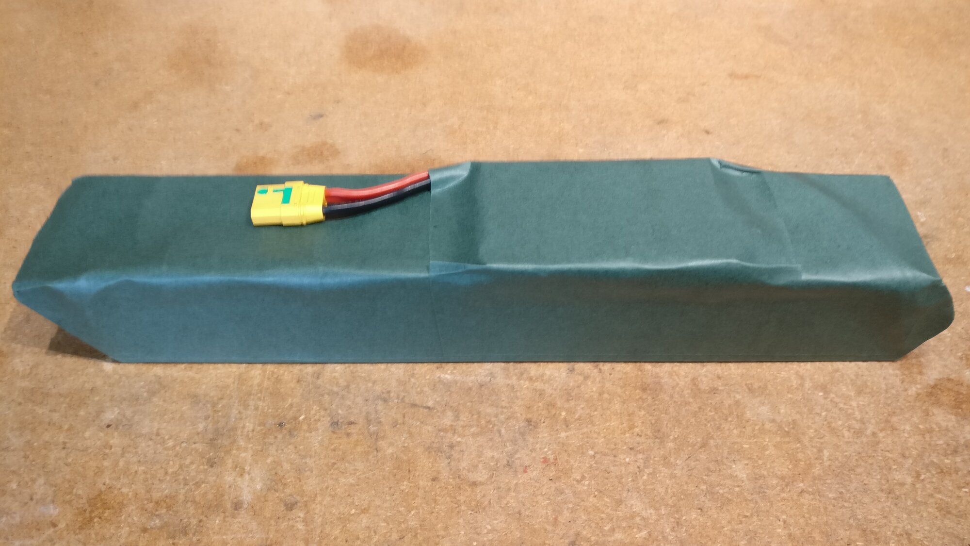

The front and back are covered with adhesive backed fishpaper wide enough to wrap around the ends of the cells. This double layer over the ends of the cells made the pack very stiff.

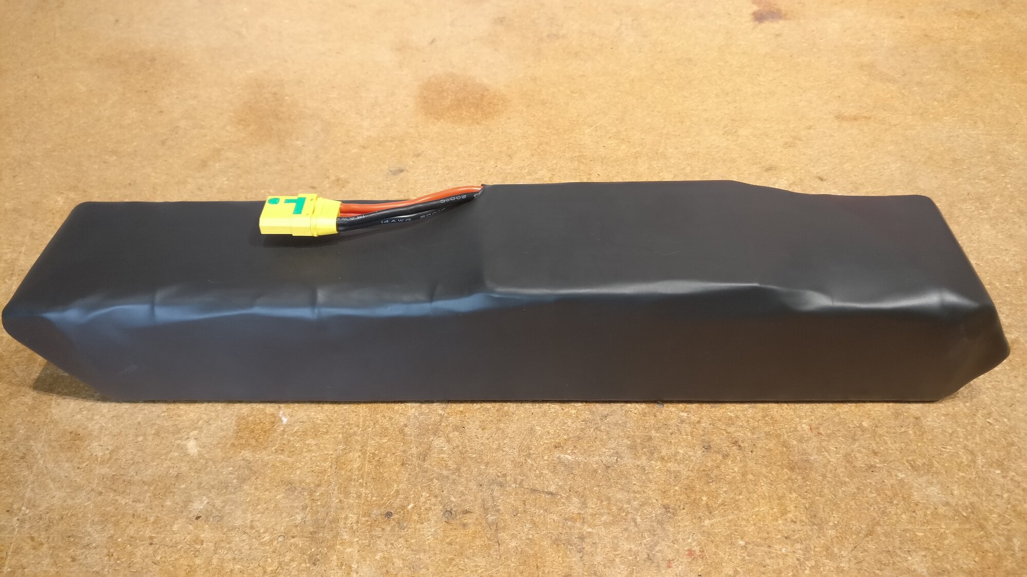

The pack was then covered with tough polyolefin heat shrink tubing. If I did it again, I'd use LG M50LT cells and route the balance wires a bit better.
