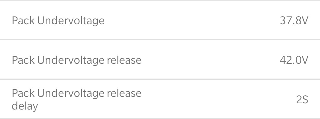

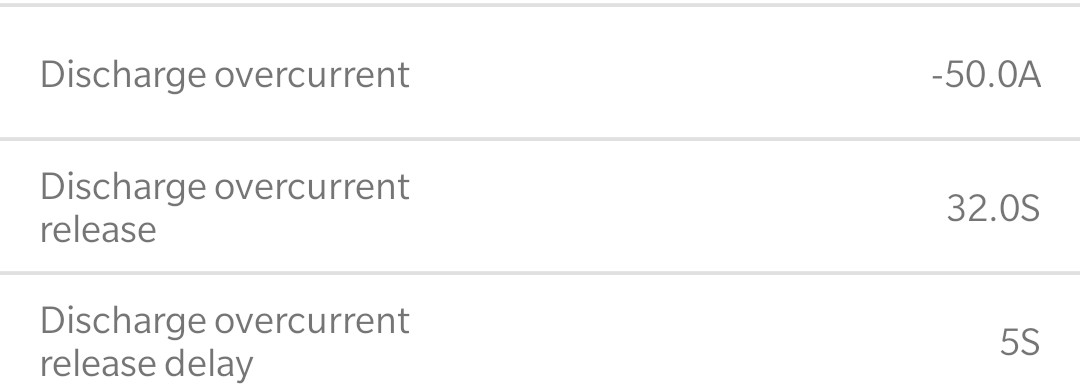

Some BMS settings of interest pertaining to shutdown.

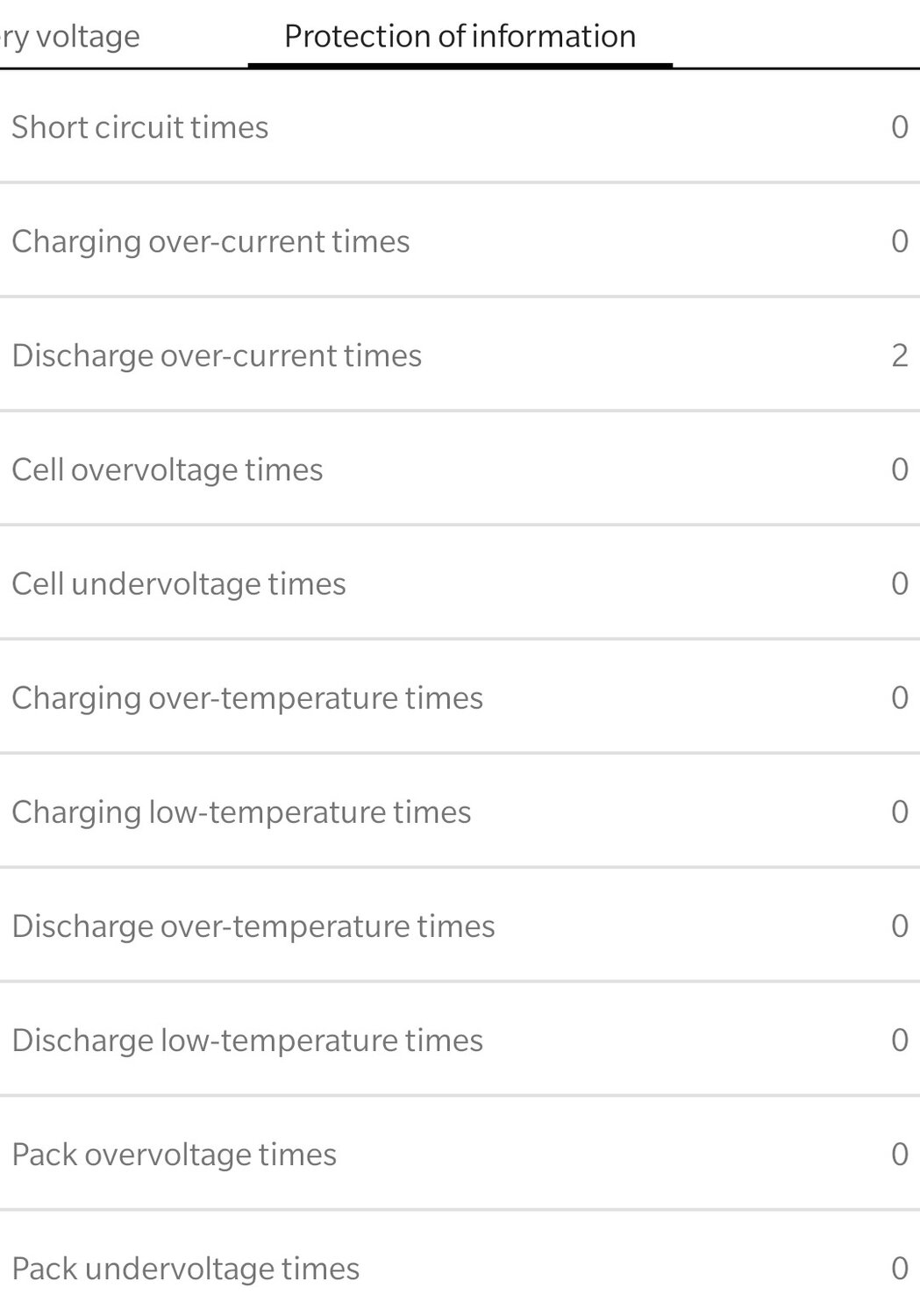

Found my reason for both shutdowns. Wasn't under voltage after all.
So the question remains: Why is the motor controller configured to draw more current than the BMS allows?
The battery capability changes with state of charge so they are hard to match. To be honest I think Pushkar should ship these with much lower power settings and let buyers adjust it up to preference.
