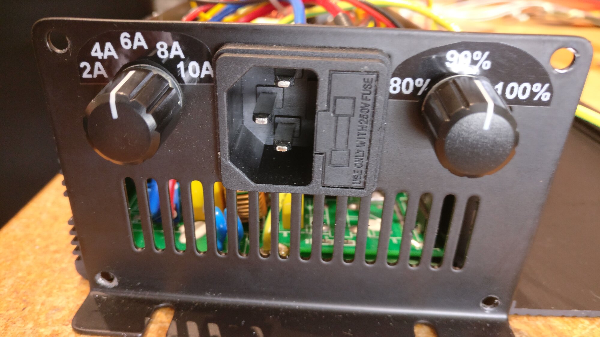

Thanks for pointing that out. So dumb. Mine has a fuse on the inlet socket.
(I made my own legible labels.)

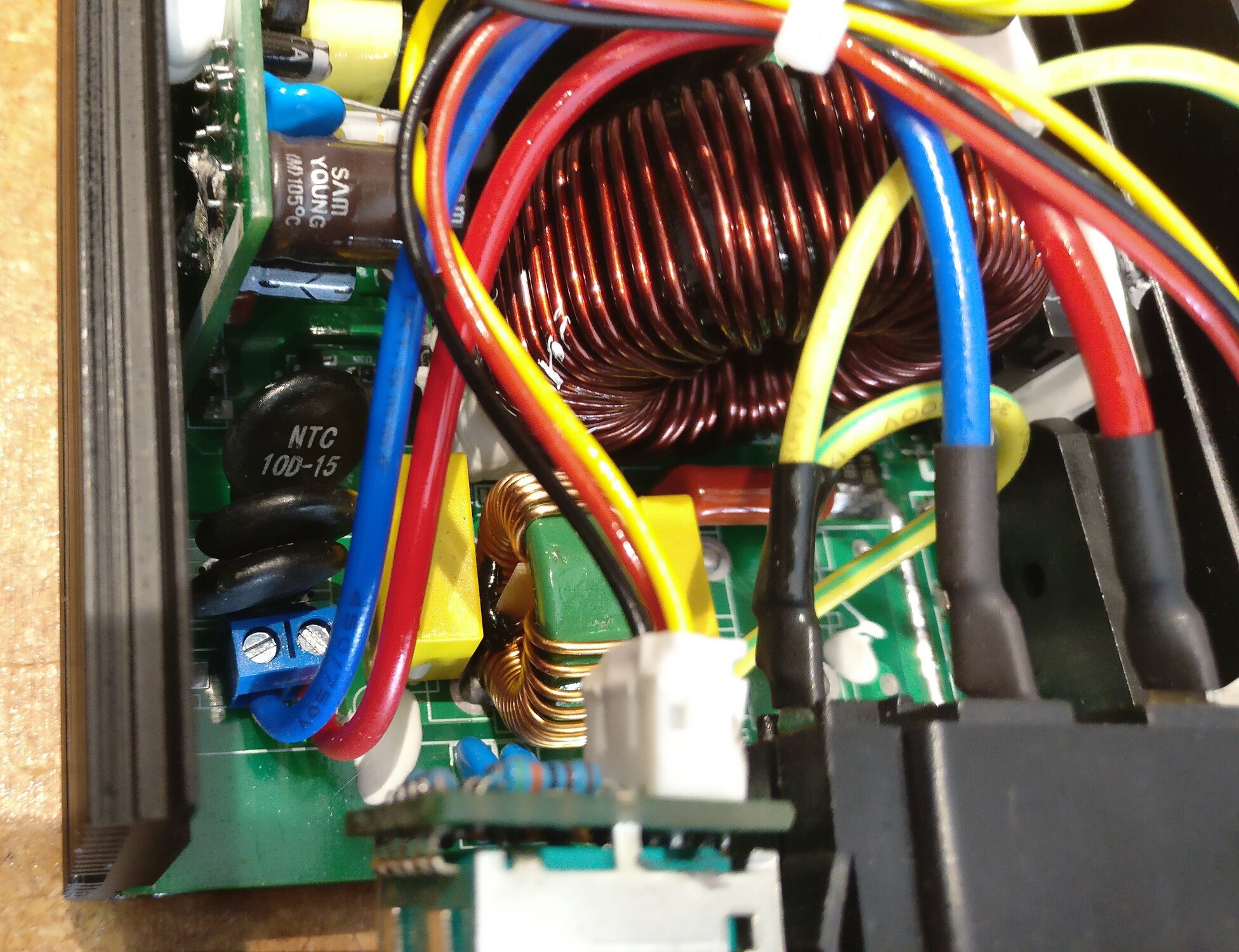

After that, I would expect the inrush current limiters to fail. They're the black disks on the left of this picture. Maybe they can be upgraded.

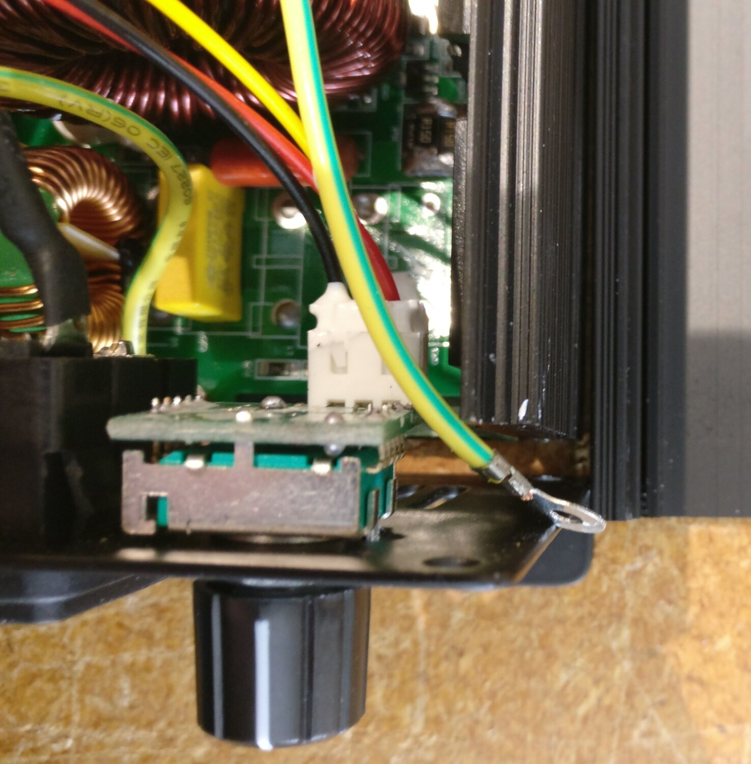

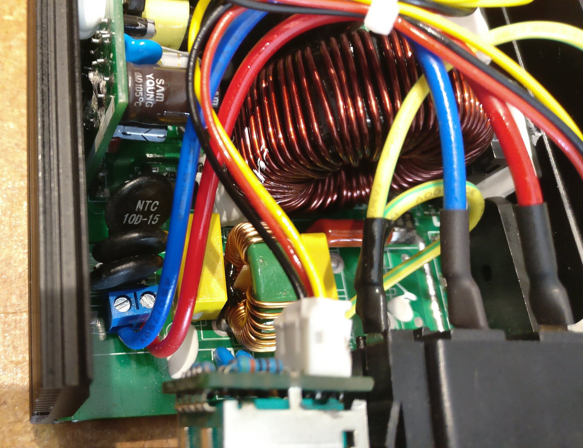

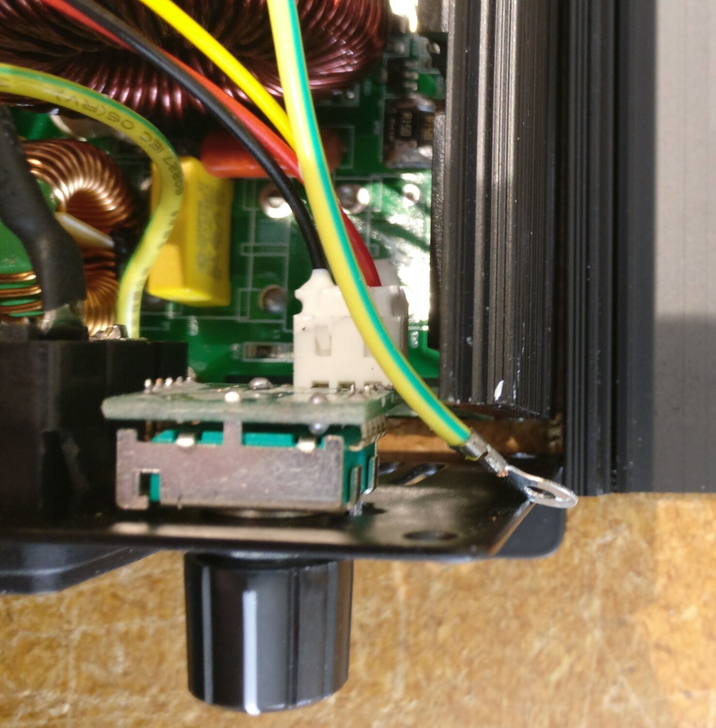

This charger would never receive electrical approval with these ground connections shared with the cover screws and not connected to bare metal.
