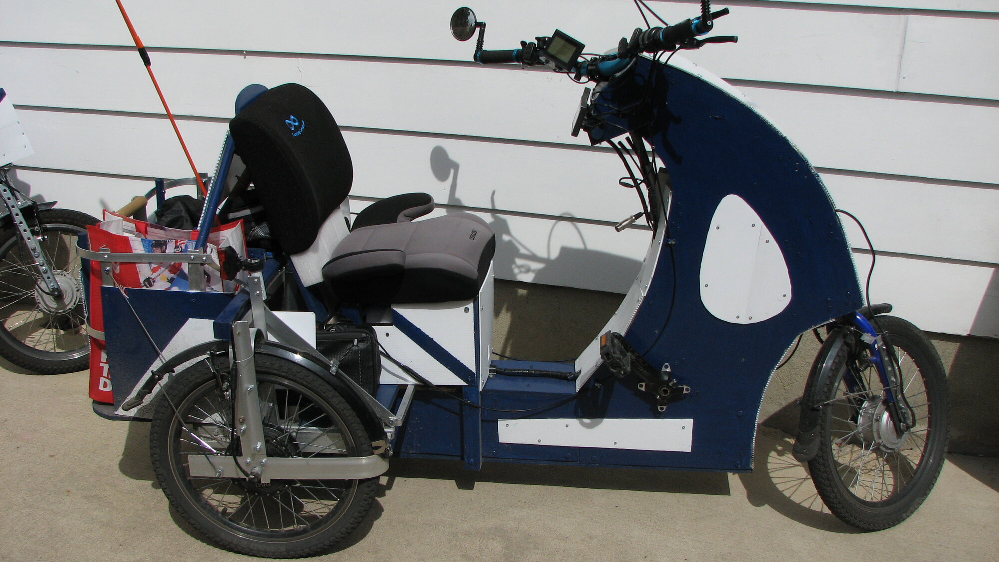

Evolution of a multipurpose etrike/scooter with various configurations:
1.Single drive 500W front wheel hub motor with a chain drive for the right wheel
2.Two wheel drive ,350 W rear wheel drives with chain drive for the right wheel
3.Two wheel drive , 350 W rear wheel drives without chain drive but with adjustable friction brake
like an exercise bike (hybrid) with pedals (hybrid)
4.Three wheel drive, two 350 W rear drives, one 500 W front wheel drive with adjustable friction brake
operated by the pedals (hybrid)
5.Same as 4, but equipped with power generator to charge the batteries, driven by pedals
6.Three wheel drive ,all wheels 500W with friction brake operated by pedals ( hybrid )
All wheels have their own controller and battery and can be pedal assisted with 5 levels individually,
they also have their own individual throttle.
I am riding these trikes/scooters now for several years in all kinds of weather, even in winter
with ski clothing on, three wheel drive in winter is a blast.
Here is a picture of one of the trikes/scooter.
Rudy
RudyView attachment 135069
Hello Rudy Pekau: I read with interest your post and also the photo you posted. I live in Florida and was looking for this type of e-bike but I was unable to find exactly what I wanted. Your description of the etrike/scooters appear to be what I want but I see you posted from Canada. I am an ex-pat born in Ottawa but have lived in the US for the past 40+ yrs. and I was hoping you might know of a company who manufactures I am thinking the #5 would be my preference. Thanks. Mardi Cole
