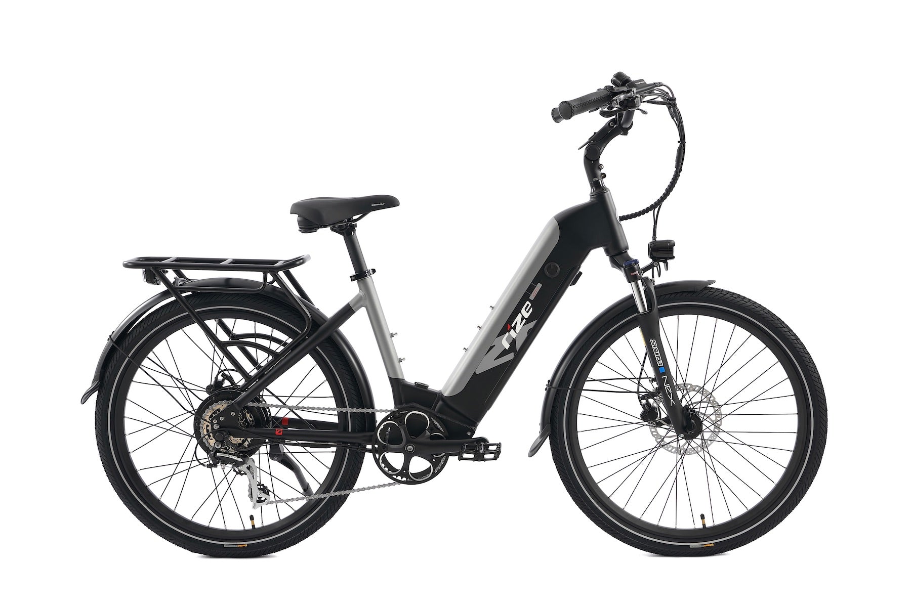

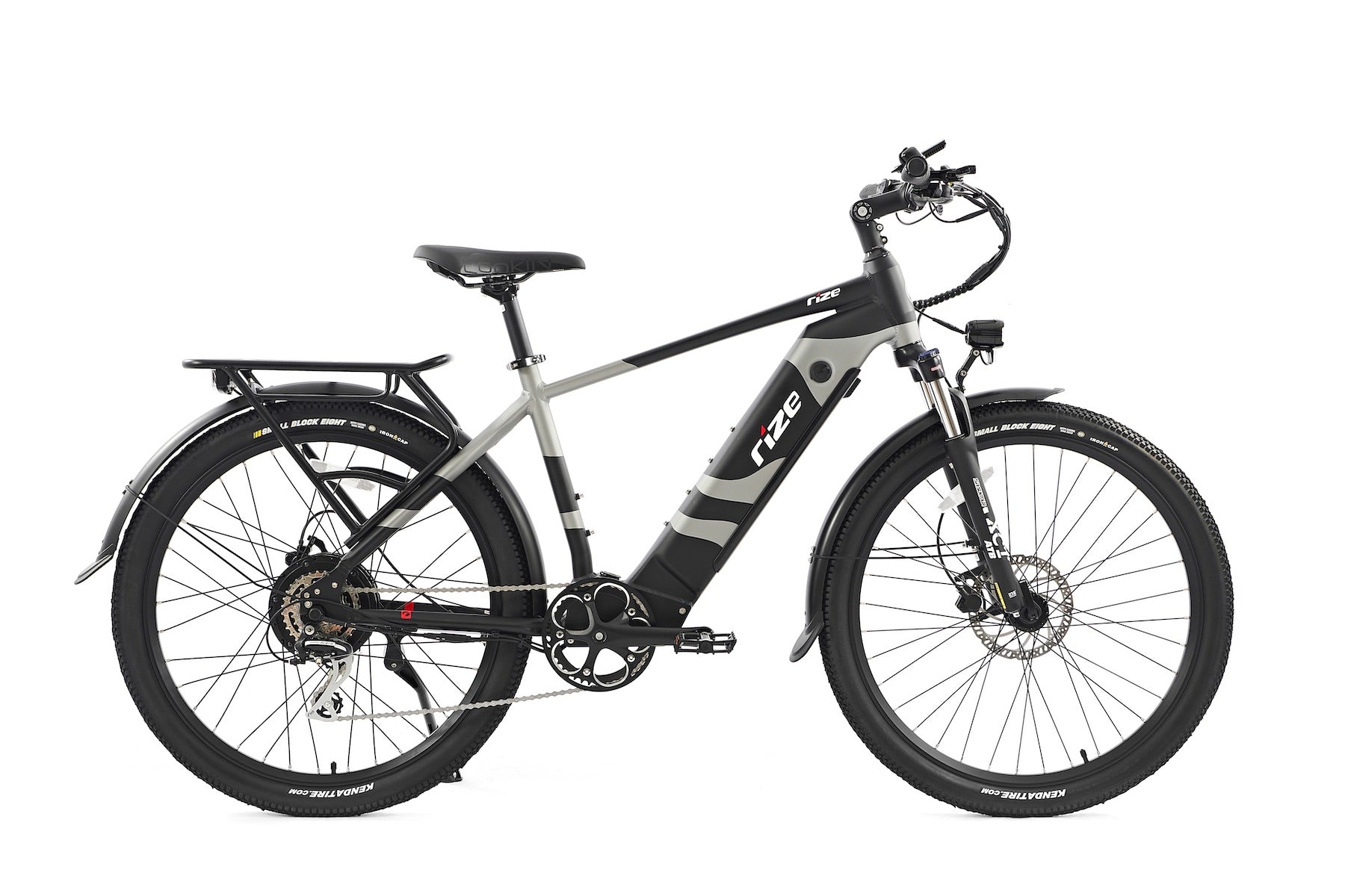

Andy if you are 88 my vote goes solidly to the mid drive such as on a bike like a Trek Verve + low step or a Gazelle step through. I found my first bike somewhat dangerous as it had a hub drive with a crude sensor system. I had a few slow speed crashes while navigating tight turns though traffic barriers on it before I decided to switch to a Bosch mid drive bike. After pedaling well over 40,000 km now on my two mid drives I am still glad I did . The Trek Verve does however have a less powerful motor than the Performance CX on my bikes and if you live in a hilly area you may prefer the Performance or Performance CX motors.
