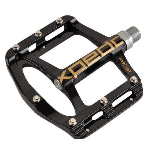

You can get close to 3/4 (40%) rotation with a good pair of flats and MTB flat shoes. Here is a good writeup of some shoes. There are a lot of options for flat pedals and replacement pins. I've been really impressed with Xpedo Spry magnesium pedals and 5.10 shoes.

Options for more aggressive pins:

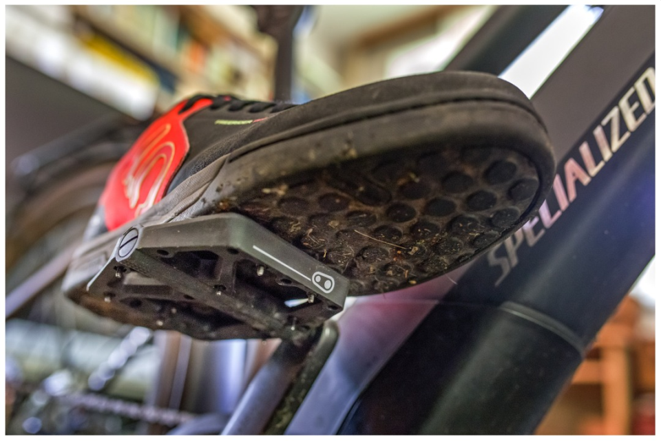

Adidas FiveTen (510) Freerider Pro shoes with Crankbrothers Stamp (1 or 3 or 7) size L pedals. Specialized 2FO DH Flat shoes are almost as good but the fit of the latter is not that excellent.
Proper cycling shoes hold on the traction pins of good flat pedals as good as you need to raise your feet a little to remove them from the pedals! The greatest benefit of the flat pedals (especially large ones) is you can change the foot position as you are riding. The SPD system is a little more efficient but it holds your feet always at the same position, which is good for an athlete but not necessarily for the rest of us :)
