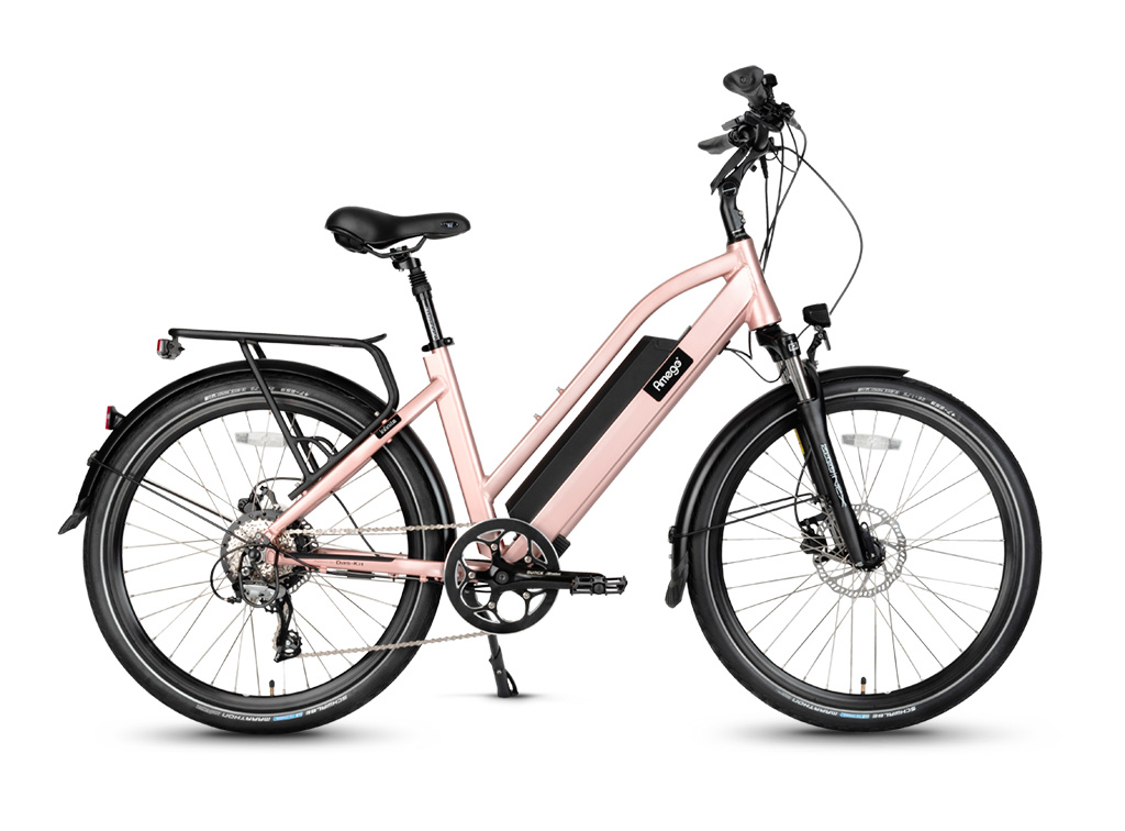

Anyways, me personally, I'd recommend Amego Infinite Plus Step-Thru
(Only Rose Gold and Space Grey will be available if you choose 26 inch option)
Reason:
26 inch wheel option will give better climbing capability due to mechanical advantage. (although 27.5 inch will do just fine)
Also 26 inch slightly lower the step height.
Good components and easy to ride posture, I think Juiced or other MTB-style frame isn't relaxing.
Good price, Amego generally has good reputation.
EBR Amego Infinite reviews:
