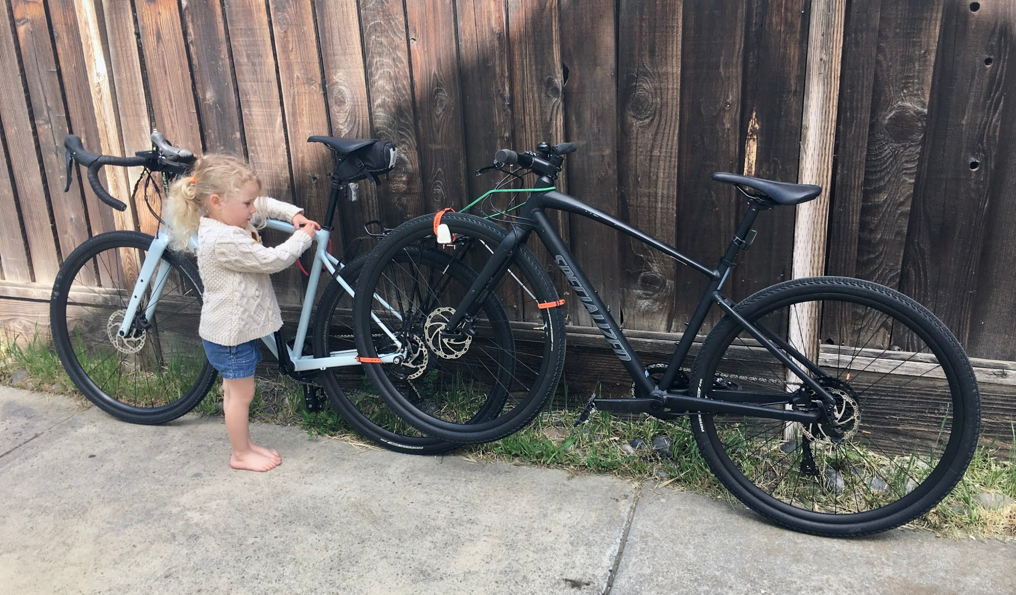

Hey folks, that link right above 👆 is to my blog. I think it’s a pretty good solution that is very similar to the “bag and drag” method shown with the cargo bikes up top, but works with regular bikes. The design works well enough now, but I’d love your feedback to help make it great.
I’ll add an additional idea, too, for a small kids bike: You can get some bike storage hooks and mount them off the rear of your rack and hang the bike by the top tube, transverse to the main bike. Then some Voile Straps or similar to cinch down.
(Hooks could be pilfered from a product like this: https://www.amazon.com/Voilamart-Storage-Bicycle-Folding-Capacity/dp/B07KPYPDH5 )
Cheers!
