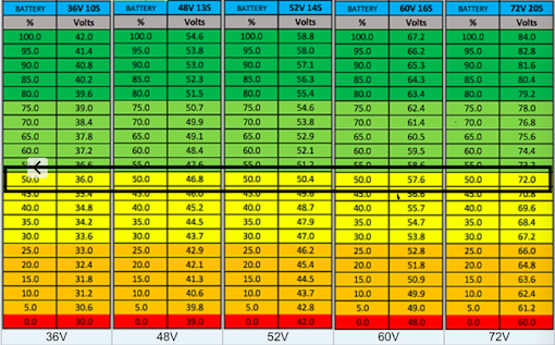

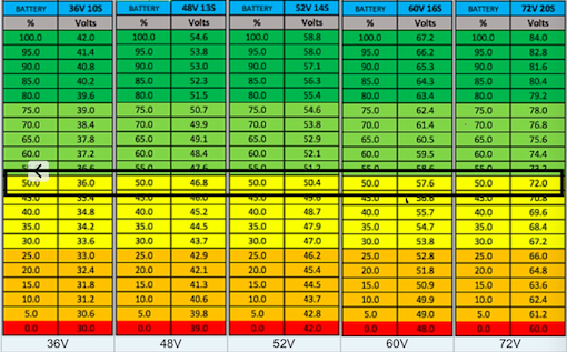

Does anyone else notice on a 52V battery that the charge level bars are not programmed correctly to follow this chart. For example I ended my ride with 46V yesterday and still had half charge on the indicator. This chart suggests I was at 20%
