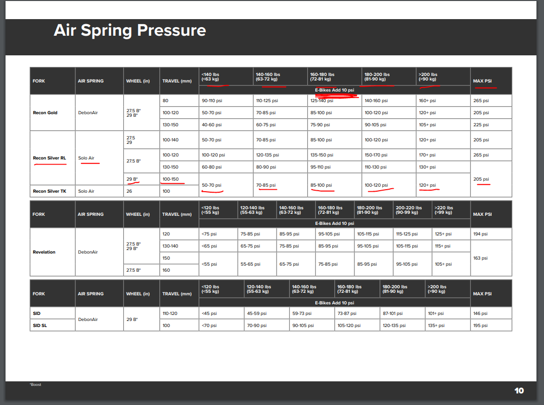

and got this from SRAM after contacting them since the fork is not in https://trailhead.rockshox.com/en/

Use the attached file which I got from Tyler at SRAM since the fork is not in the Trailhead. It's also a sticker under the Rock shock sticker on the right or left fork where you can read the fork pressure.
What's your weight ready to ride and I tell you the pressure and do you have a fork pump?

What is very interesting (and confusing) though is that in the table you attached above, for the Recon Silver RL with 27.5" wheels, it only lists 100-140 mm... But my fork only have 80mm travel (it says on the side). So I'm hesitant to use the numbers in this table because it seems like these are for a fork with more travel?

Just wanted to give an update on this. I emailed SRAM as Catch suggested above. SRAM just replied by sending the same table that Catch linked above, but that table only lists data for 27.5" wheels and 100-140 mm of travel, but my fork has 80 mm of travel (at least, that's what is listed under the technical specifications at https://www.specialized.com/ca/en/turbo-vado-5-0-igh/p/199872). I emailed them back to explain, hopefully they can get the correct information to me soon. It's pretty disappointing to buy a brand new bike and not be able to get this necessary information.

This is what Tylor answered me in my request:
Thanks for reaching out, and I hope you're having a great week!
It looks like entering your serial number, 05T13521398, into Trailhead does not provide a tuning suggestion, as you mentioned! I brought this to the attention of our team that manages Trailhead.
In the meantime, I have attached our Suspension Setup and Tuning Guide below. Following the step in this guide will ensure optimal performance from your Recon Silver RL. Additionally, I added a screenshot of the air chart for your fork below.
Your local shop or dealer can also assist with setting up your suspension if needed. See our dealer locator to find a dealer near you:
Let me know if you have any other questions.
Have a great week!
Sincerely,
Tyler

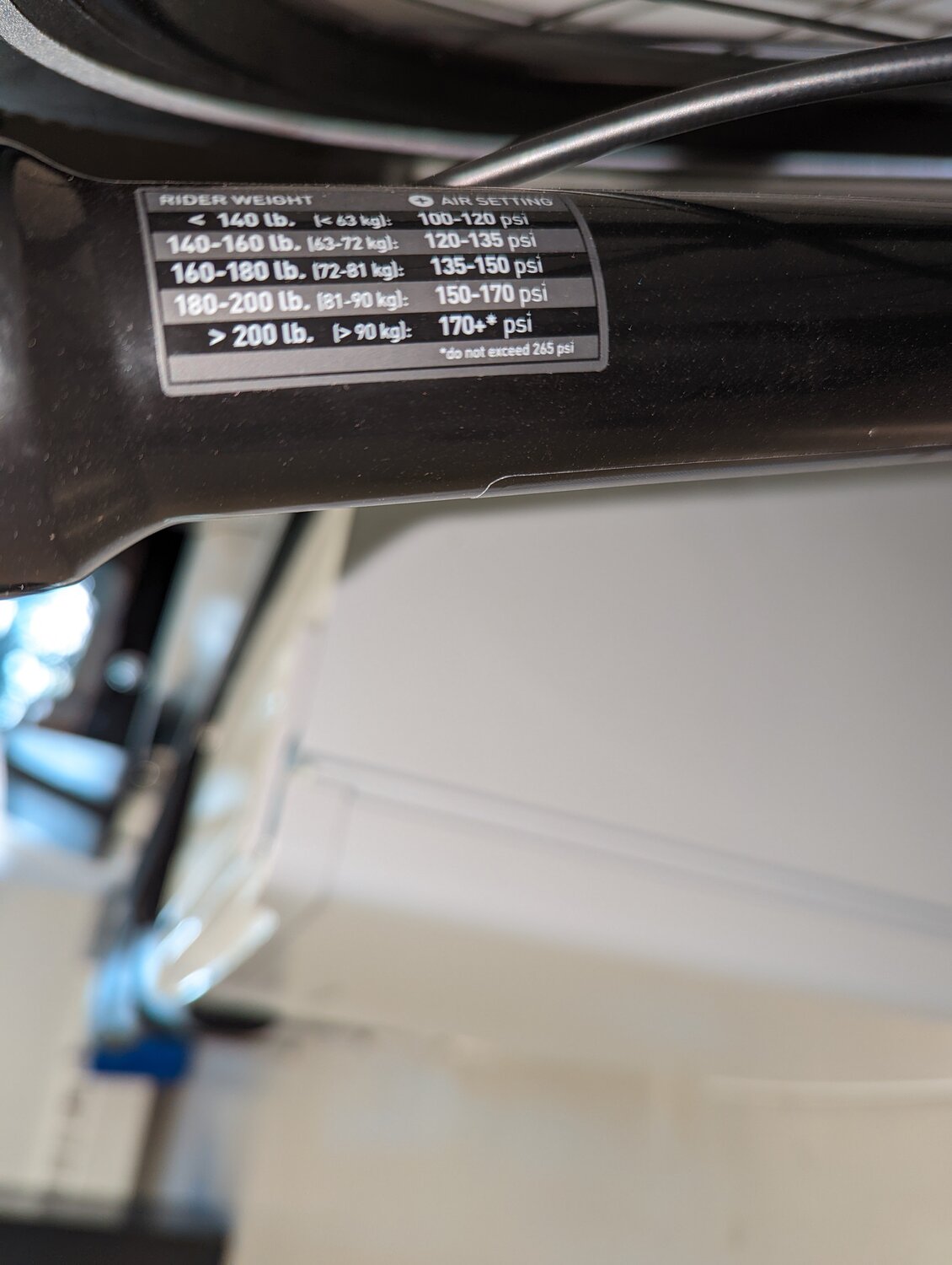

However, that table doesn't give any option for a fork with 80mm of travel, which is what Specialized lists for the specs. I also just checked the fork itself, and there is a sticker that does identify it as having 80 mm of travel (so the Specialized website is correct).
But, upon inspection of the fork, I noticed a new sticker that I hadn't seen before, and it actually lists the information I need! It is hidden on the inside, so I did not notice it previously. Good thing I found this, because the information SRAM gave me in the email is completely wrong (100 psi whereas I should really be using 170 psi!).

I also have that sticker BUT on my sticker it says 72-81kg 135-150psi.
As you can see the screenshot Tyler sendt me shows 95-110psi.
So something is obviously wrong since sticker and Tyler operates with different pressure.
I use Tyler recommended pressure cus it feels best to me.
I haven't mentioned this problem to Tyler yet.

Guys: Your suspension forks are of different travel, so the inflation pressure for either is different. Use the information from the sticker.
Don't known about Nonlinear but sticker on my bike and screenshot from SRAM shows different pressure. Can't take a picture of the sticker since I am not where the bike is but Thursday I'll do
