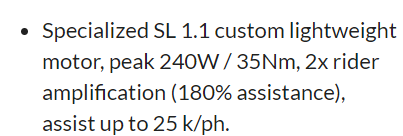

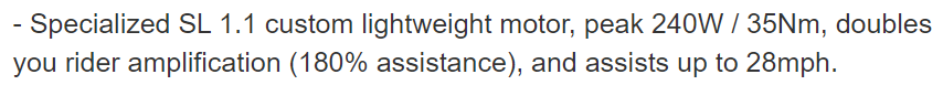

It is 1.8x max assist. The 2x is the marketing figure.
Here are the data before Specialized started hiding it:
It is interesting how the 1.8x assistance can "double your effort" :) The same marketing lingo is about the "4x you". The strongest Specialized motor provides 3.6x assistance, the typical figure is 3.2x (I have that printed in the EU Certificate of Compliance for the 1.2s), and the weakest of the 1.2 motors (the 1.2e) has 2.8x assistance.

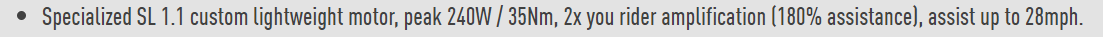

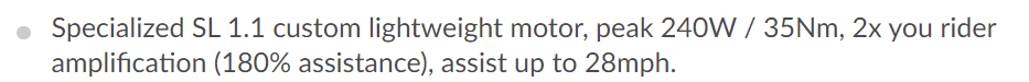

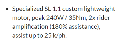

perhaps they’ve changed the firmware, or perhaps the models sold in the US are different? this was posted by specialized in 2019: (of course they do not mention the SL)
In terms of support, each e-Bike motor is slightly different. 100% on the slider means 4.1x rider power for 2019 Levo (2.1 motor), 3.8x for 2018 Levo (1.3 motor) and 3.2x for older Levo (1.2)
the figures on the certificates could also be output power, rather than input power which is what the 3.2-4.1 refer to above. in any case, the actual power consumed by the SL motor on my creo is more than “2x” the assist percentage by 5-10%, and quite a bit more than 1.8x.
