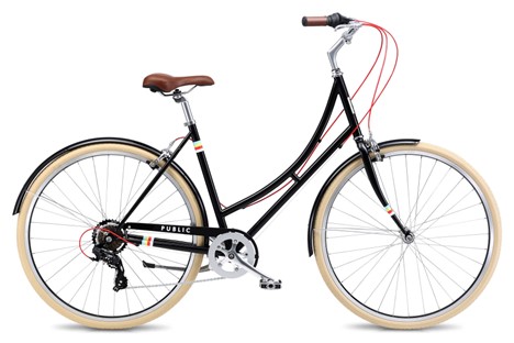

I support my local bike shops. It is important and something I value for my community. Like having a local book seller, a bike shop is in line with my values, so that means it is worth investing in. Some bikes can be ordered online but I would rather do that in person. I just ordered a bike today to convert to stealth electric. It is a black step-thru and I will do all red housings and electrical. I will also upgrade the rim brakes to mountain rim brakes. It will get a silver bell and cupholder. I paid $449. It is a Public C7. Shipping is free to the lower 48. I think that black is unisex but the bike comes in 11 colors including pink aka blush. Red housings pop. I will reuse the cover of the chainring and will use polished crank arms and will upgrade the pedals and maybe use black & tan gravel tires. Public bikes are on a 30% off sale today.
