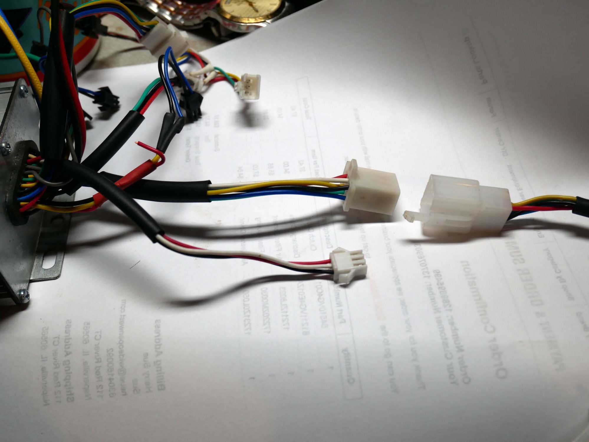

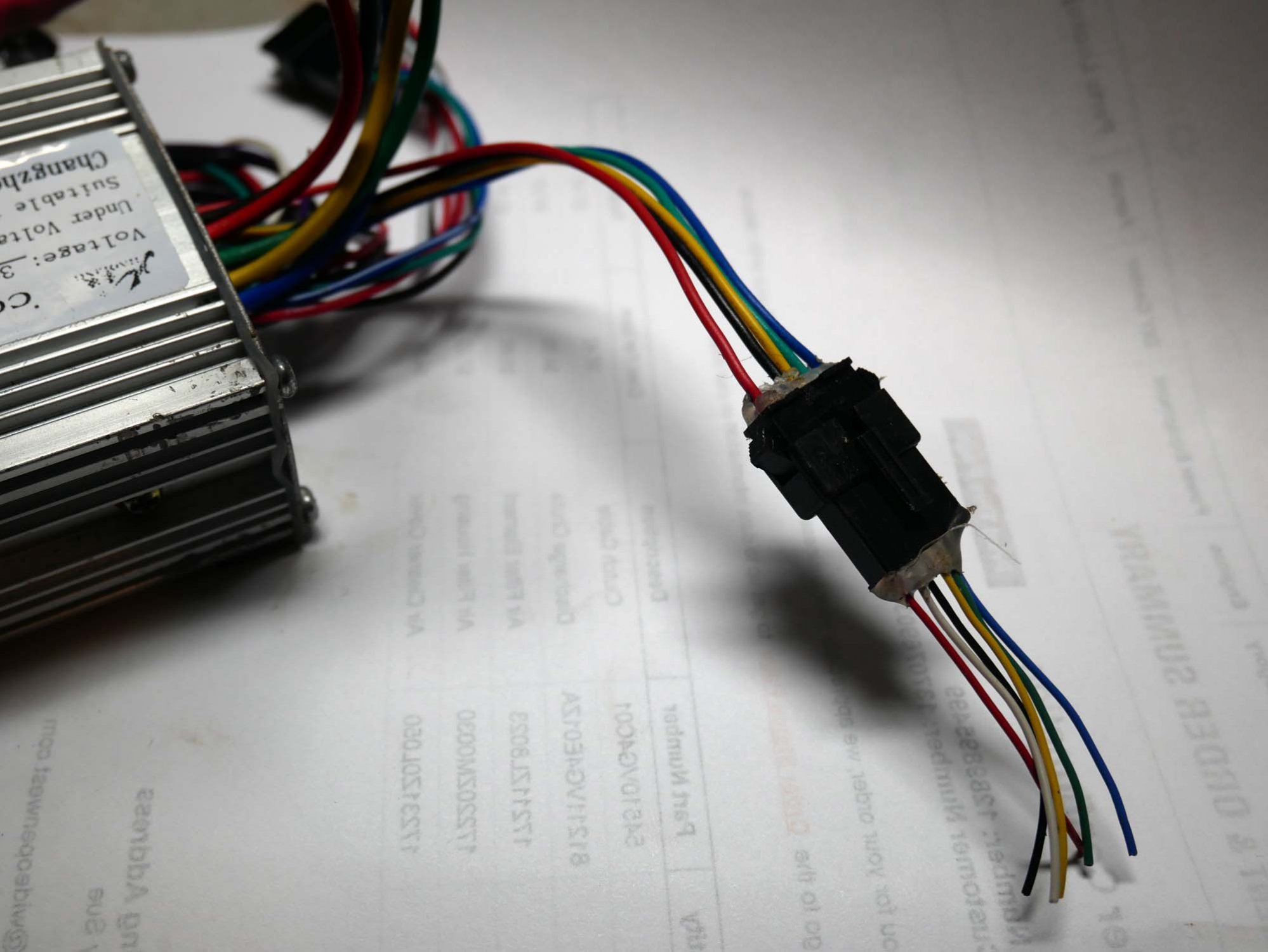

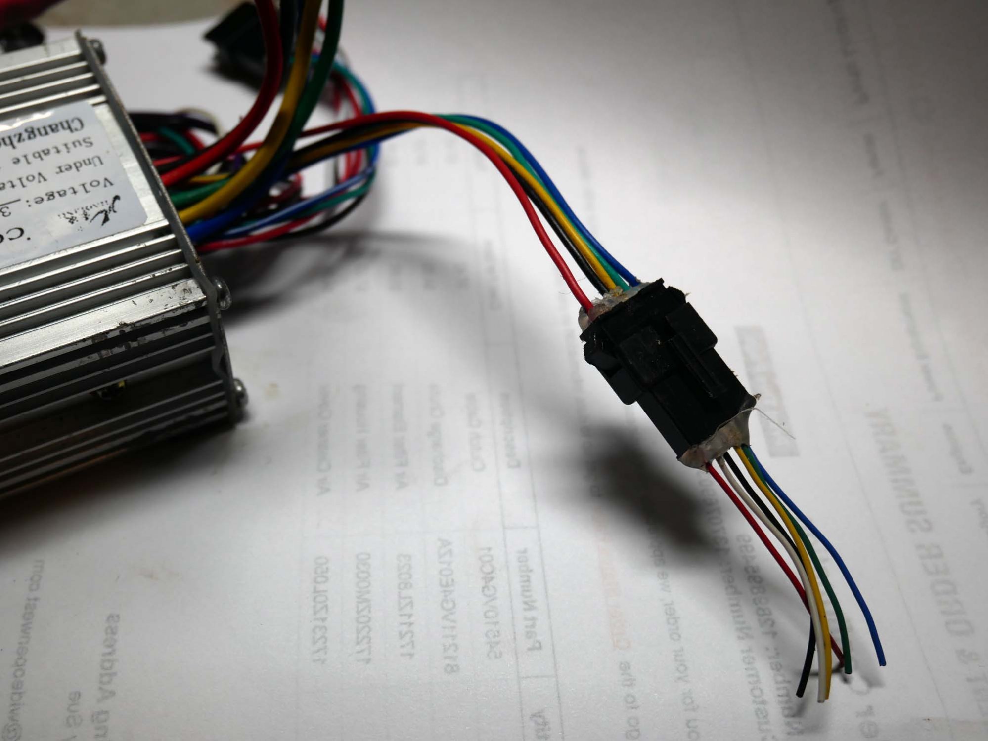

3) The motor's sensor connections consist of six wires, but the Ecotric only uses five of them. The red and black are power. Yellow, blue, and green are position sensors. The white is not used by the Ecotric controller, but it is a motor speed signal. This will be a headache because the KT controller is a different style connector. The left image show the Ecoctric after I cut off the connector from the motor. The middle image shows the KT plug, which is a 2x3 connecttor and a matching connector. These are often used in ebike kits. You can buy this connector. Probably take six weeks from China. See link at bottom.
39846 39847 39848
The KT connector's six wires will match by color to the six wires on the Ecotric motor cable. One could splice directly without using connectors, but I chose to use a matching connector off of another motor I had. The right image above shows the white connector spliced into the Ecotric motor cable.

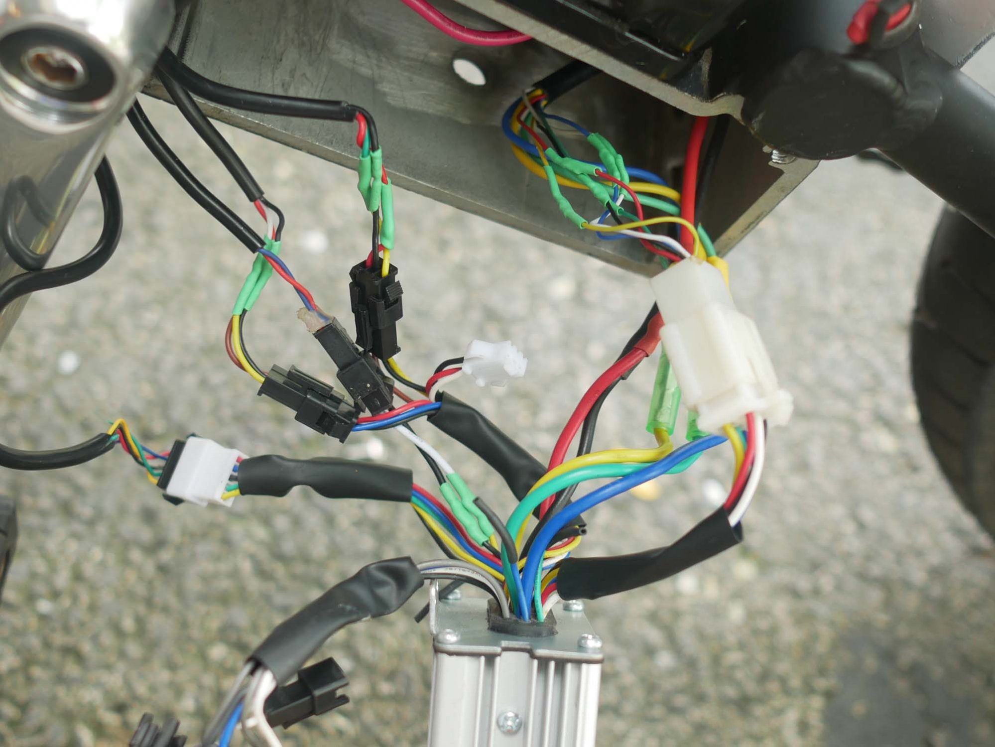

How did you, harryS, deal with the wiring harness? I would imagine the 810 controller does not use the same wiring as your new display. I am thinking I will just have to zip tie or wrap the new wires to the existing harness. And what did you do with the 810? Did you remove it? Cut the wires or?
Thanks again for the post!
The wiring harness had to be unwrapped, and the old 810LED is removed and tyhe new display is then wrapped in. It's a bit tedious.
The 810LED is a 4 wire cable, and most LCD displays are 5-wire, so there's no labor savings in trying to keep the cable and splice the new LCD and its connectors to the ends.
You will also want to cut down the display cable to minimize having to stuff excess cable into the bike's controller cavity. I took the opportunity to also shorten the PAS sensor cable and throttle, as I was replacing their connectors to match my KT controller.
View attachment 39846 View attachment 39847 View attachment 39848

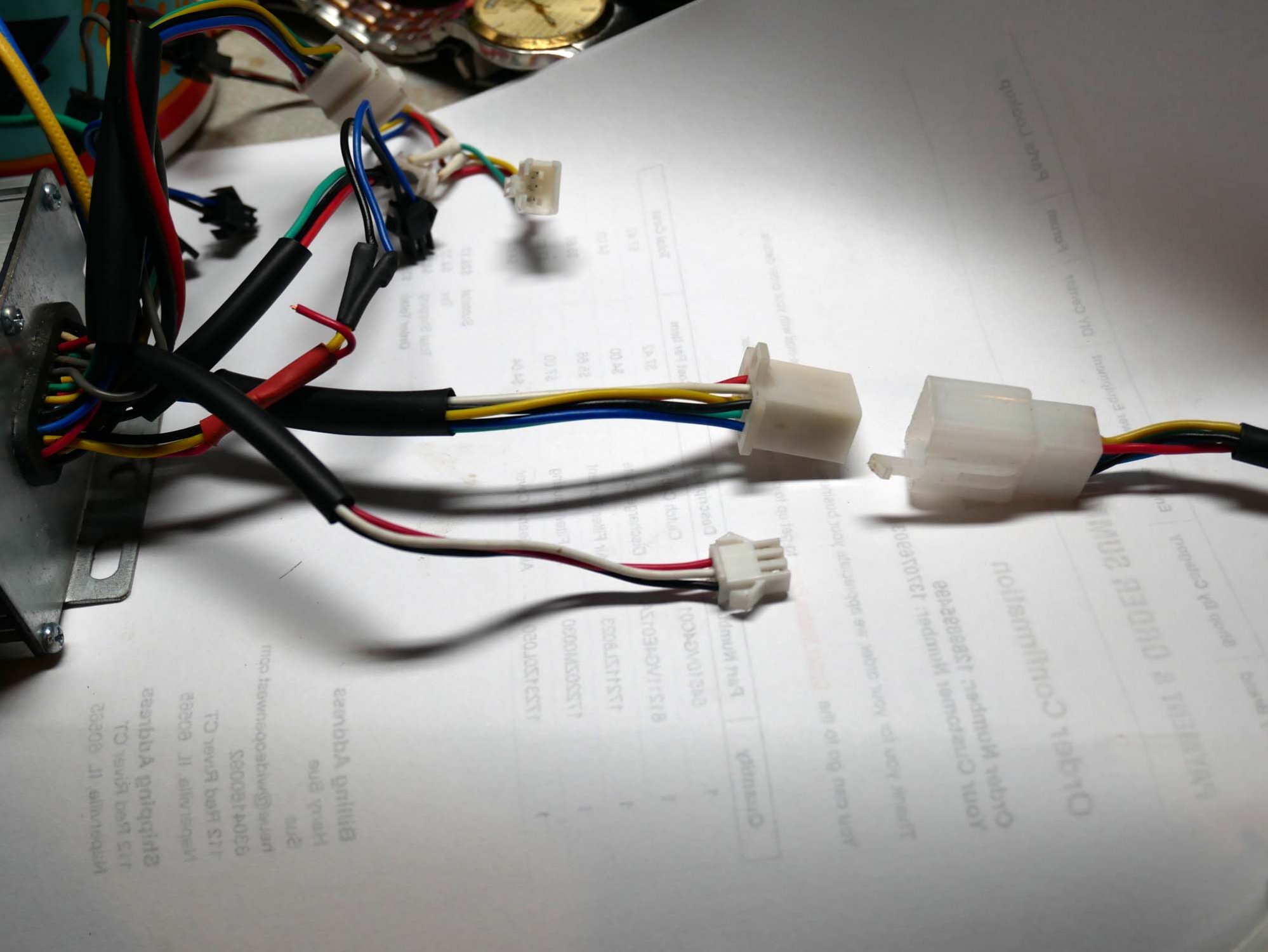

Check this post in the Ecotric Forum. This is where we keep the Ecotric connectors intact so the controller could be put back.
You need:
-one 6 pin female JST.
-one 3 pin female JST for PAS sensor
-one 3 pin male JST for throttle
-two 2 pin male JST for the brakes although these are in parallel, so if you were to parallel the brake wires, you only need one.
Since you're going to cut the KT connectors, you don't have to buy new 3 pin JST's. You just swap them with the appropriate wire changes.
Source for the 6 pin JST.
