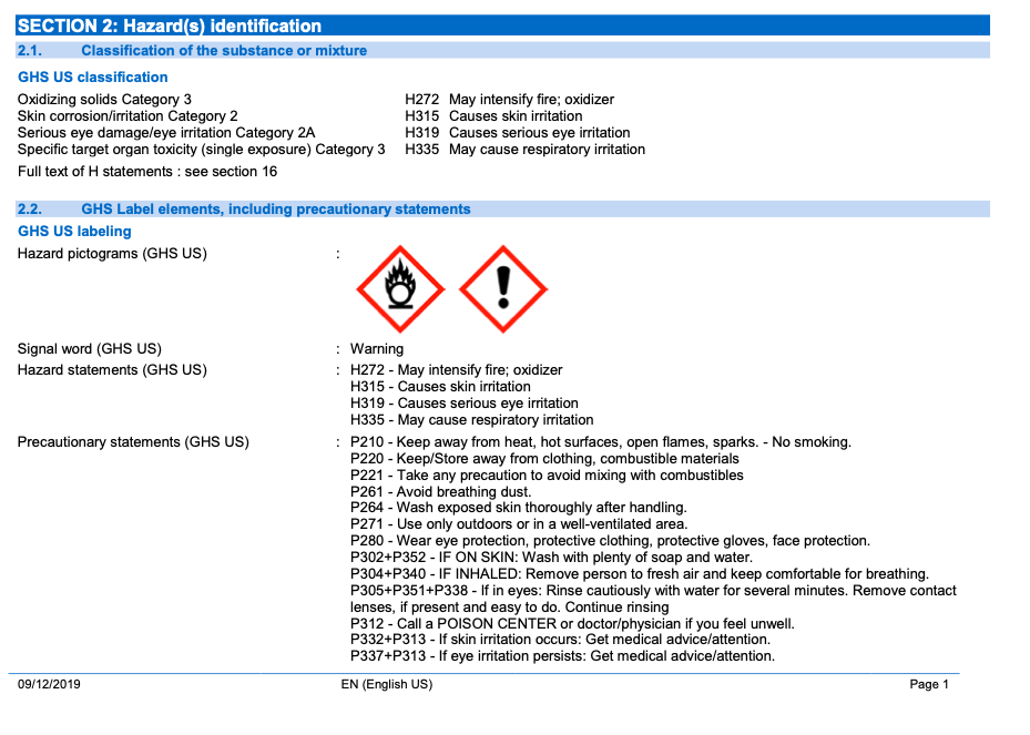

you can try chemical rust remover such as Potassium Nitrate (KNO3) to remove rust from bike metal surfaces,
Just NO! Not a good idea for general use. Good land man. Rocket fuel? The hazards list is substantial.
