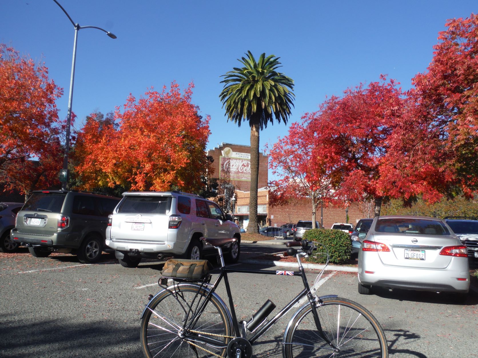

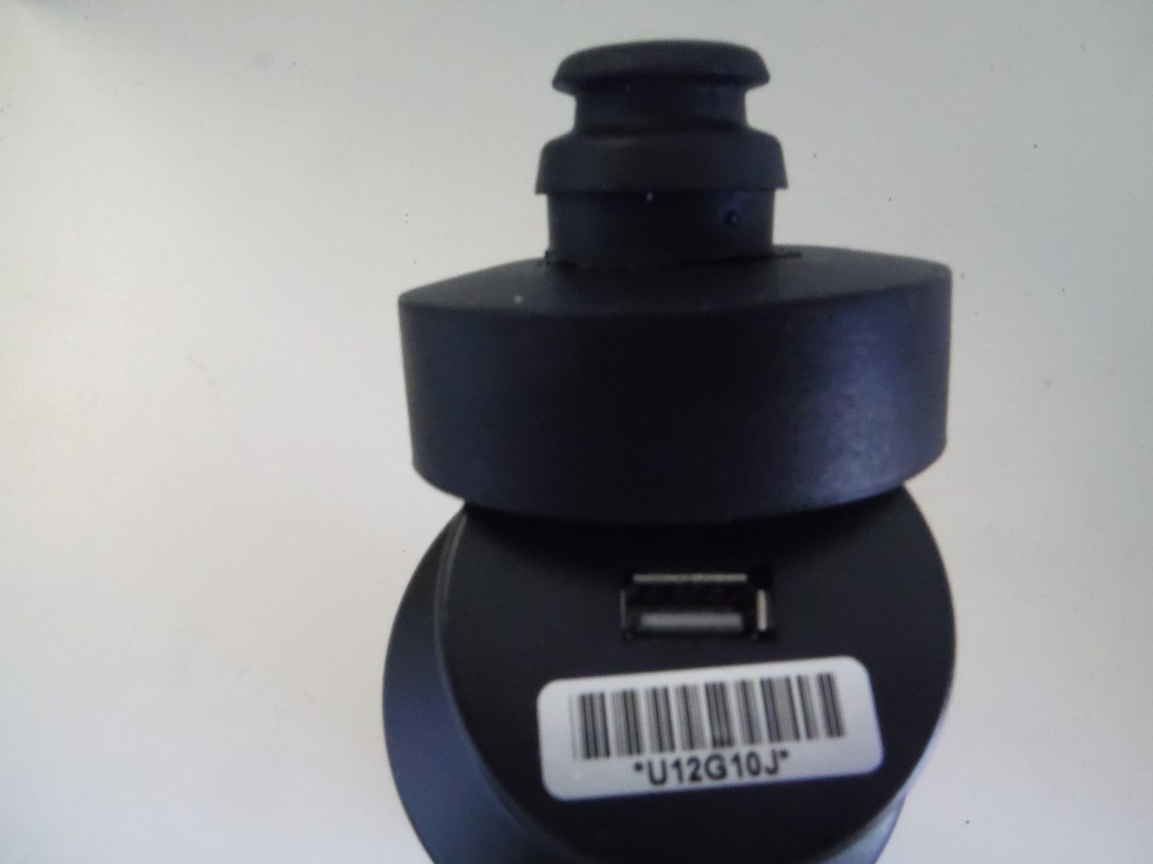

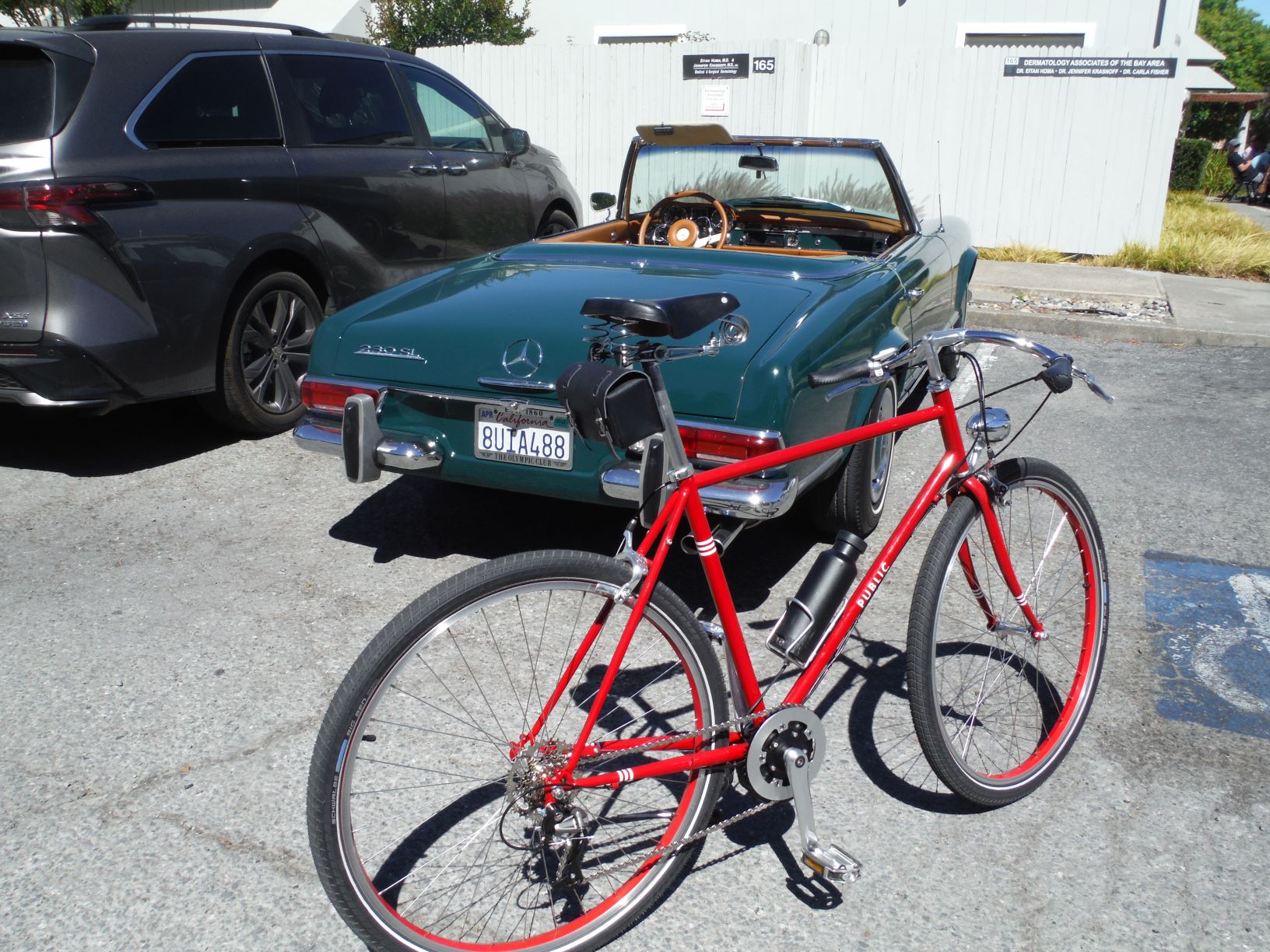

My bikes do not need cutout levers and the throttle is regulated by pedal pressure, as with a car. Push to go. Again, pedal pressure, not cadence. Some of these bikes are coaster brake bikes. No brake levers of any kind are needed. This helps to clean up the build. Here is what one looks like. It has a front brake and a coaster brake. The second bike is electric and is a ten-speed.
