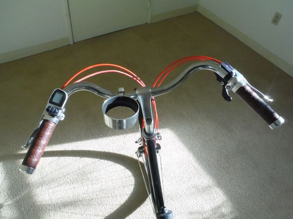

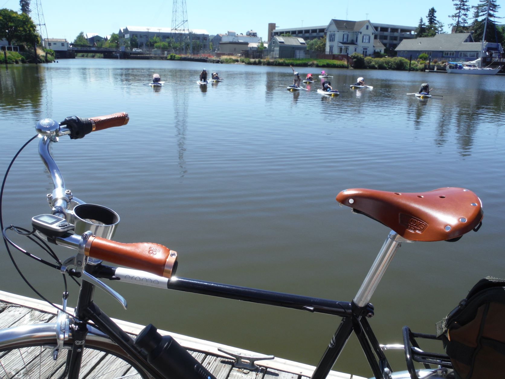

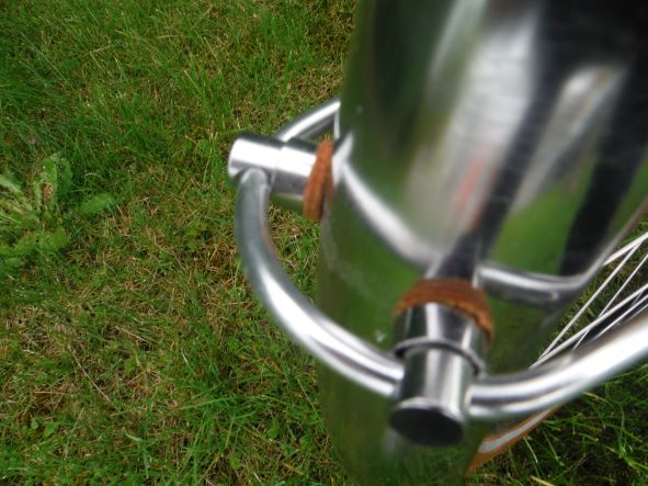

I have an old school Euro bike that has leather washers on the fenders. I did a Mountain Bike park yesterday on that bike. Everybody else had full suspensions on 11 or 12-sp MTB drivetrains. This bike is a three-speed with a stealth motor. The leather washers are the same color at the tires, saddle and grips. Hardware stores will have neoprene washers. They are used to for example seal the head of a roof flashing screw. Those could be a back up. One joke it to put BB's in someone's rims. The rattle stops at speed.

Creative. Where did you get the leather washers?
They were on the bike. You can buy a sack of leather washers on eBay. If you want to know more about that bike, search for Creme Cycles. They are not sold in the States. I had on a tweed jacket and Christmas scarf at the MTB park. That was a blast. There was a big red Christmas bow on the front of the bike.

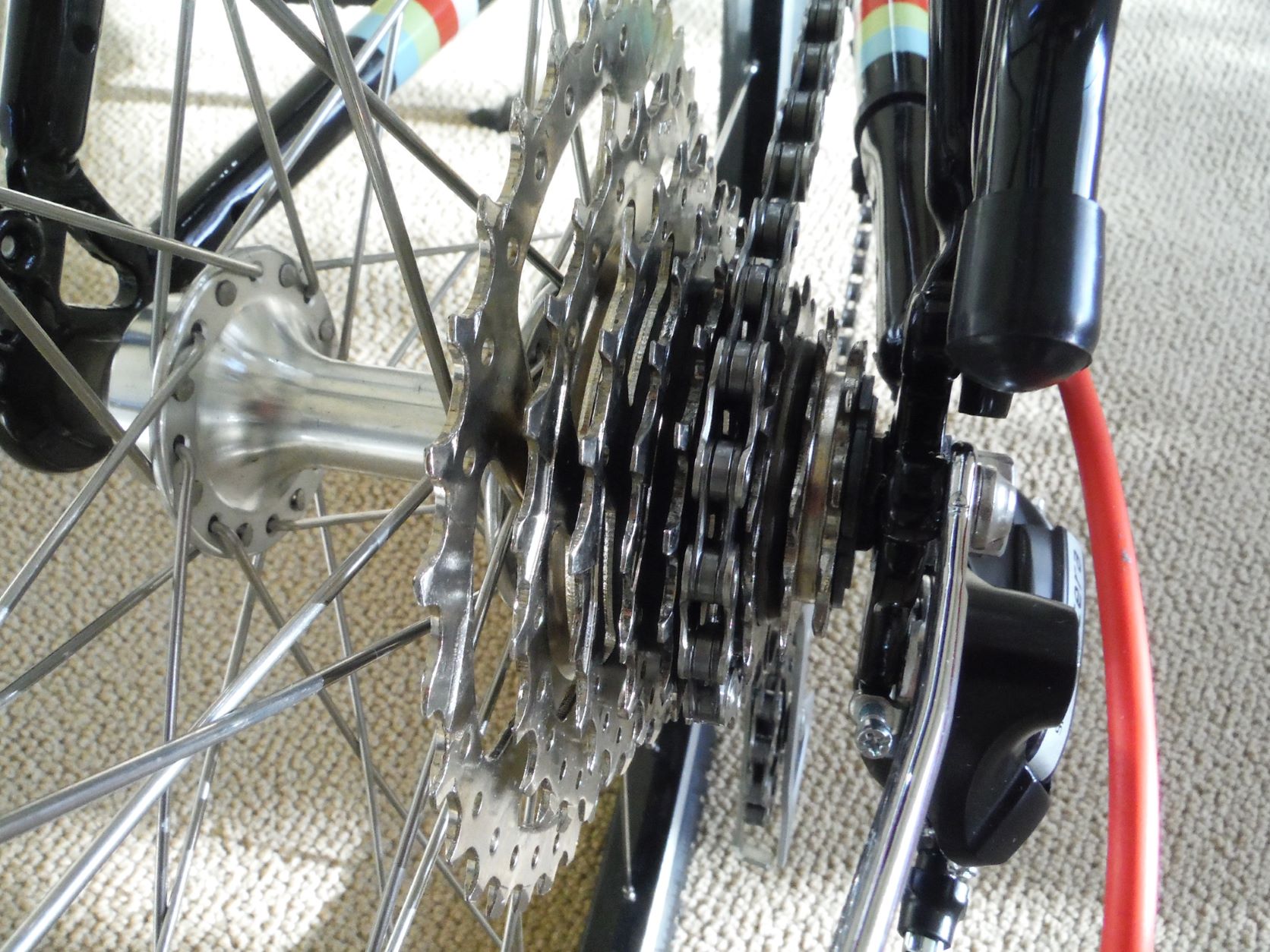

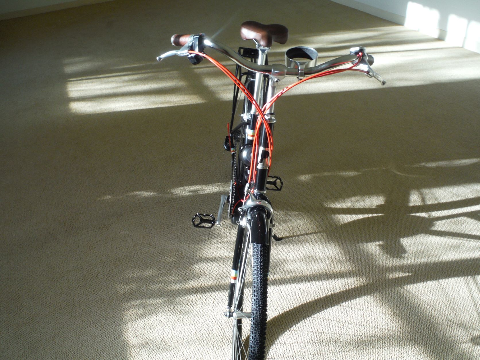

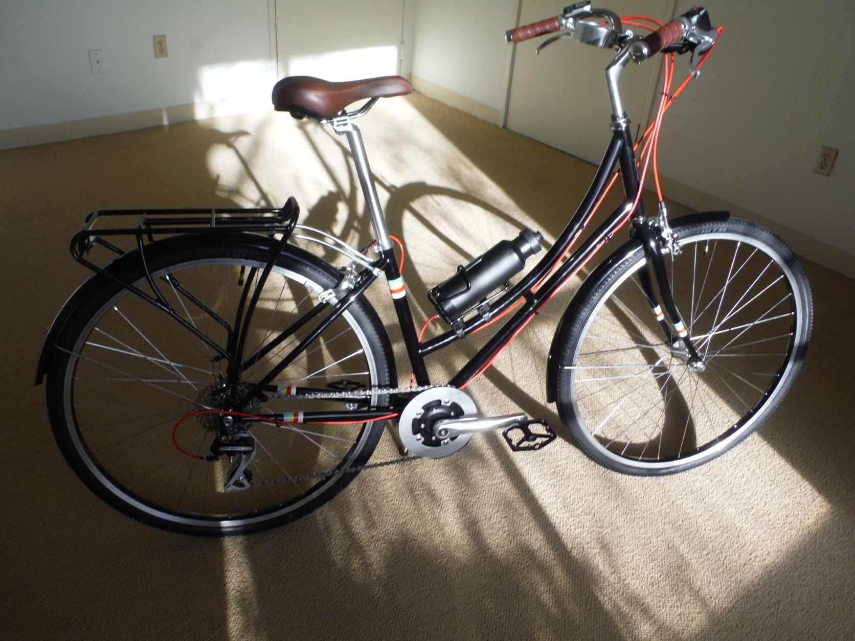

Here is a $449 bike that I made electric today. No rattles. It was a 7-sp. Now it is 9, with a trigger shifter, not a twist.
C7I with TSDZ2?
C7I with TSDZ2?

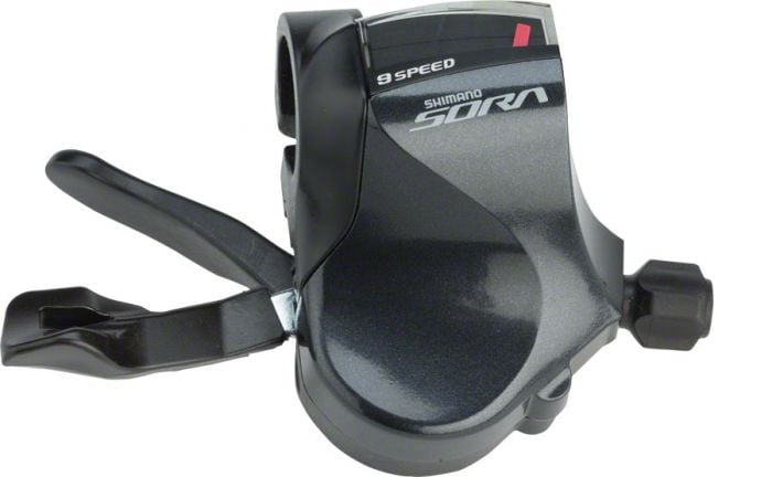

The 'i' has a seven-speed Nexus. This one came with a black Tourney 7 freewheel with a twist shift. A Tourney 7 is made out of soft ripened stinky cheese and won't hold up. It had white road tires and whippy brakes. The shift housing had an exposed section of cable and went under the BB, so I ran contiguous housing and over the bottom bracket. It had vinyl grips. Now they are leather. I am just back from a ride before the rain. Next it gets a silver bell and double wide panniers. The shifter is now a Shimano Sora 9-speed. Yes, it is a 85Nm TS mid. It can get two sizes of batteries depending on that day's plans. But the truth is no one really would ride a town bike like this more the 50 miles, so the small battery is adequate and it looks nice. Not many eBikes have red to the display. I chopped off the connectors to help clean it up. I am betting someone will want it under their tree but may wait until these bikes go off sale and back up to $660 before selling.
