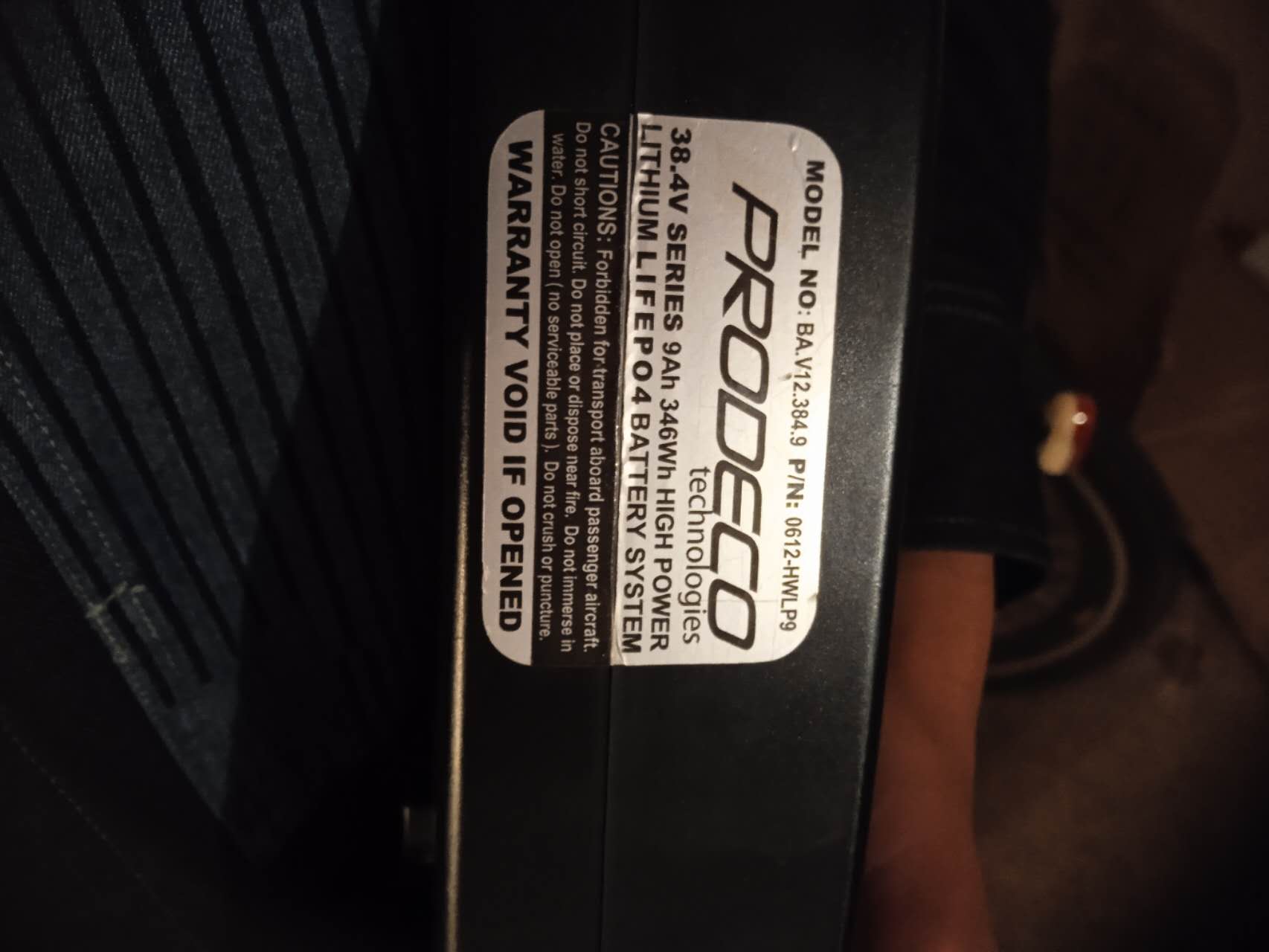

Hello everyone! I have recently acquired a Prodecotech Stride 500 for an extremely cheap price. The problem is, the battery on it is quite small (9.6 AH, 36V) and is also quite old. I think it could go about 10-15 miles tops, so I have been thinking about getting a bigger extra battery for it that could take me perhaps on longer road trips.
However, apparently the company that made these bikes is out of business, so it only leaves me with the option of getting aftermarket batteries. There are 2 main issues I am concerned with though:
1. The battery the E-bike has is actually a LiFePO4 battery, not a regular Li-ion battery. So I'm not sure if getting a regular E-bike battery could do anything to the bike.

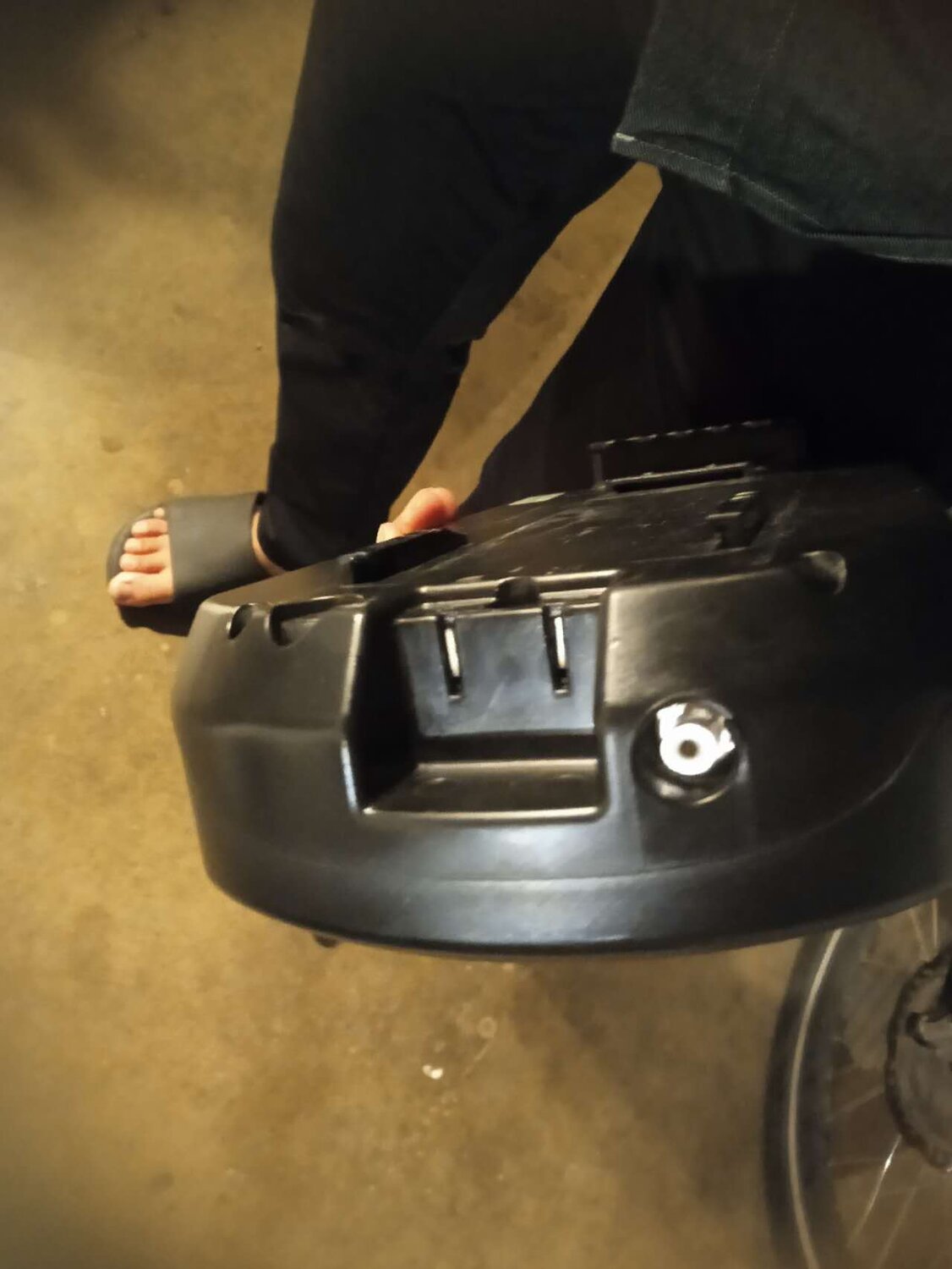

2. Even if I do get another LiFePO4 battery, it has this really weird connector, not your usual 5-pin one. And apparently the battery is also proprietary, so it has some "signal" that only recognizes Prodecotech Batteries(according to FTHPower when I called them to explore some options.)

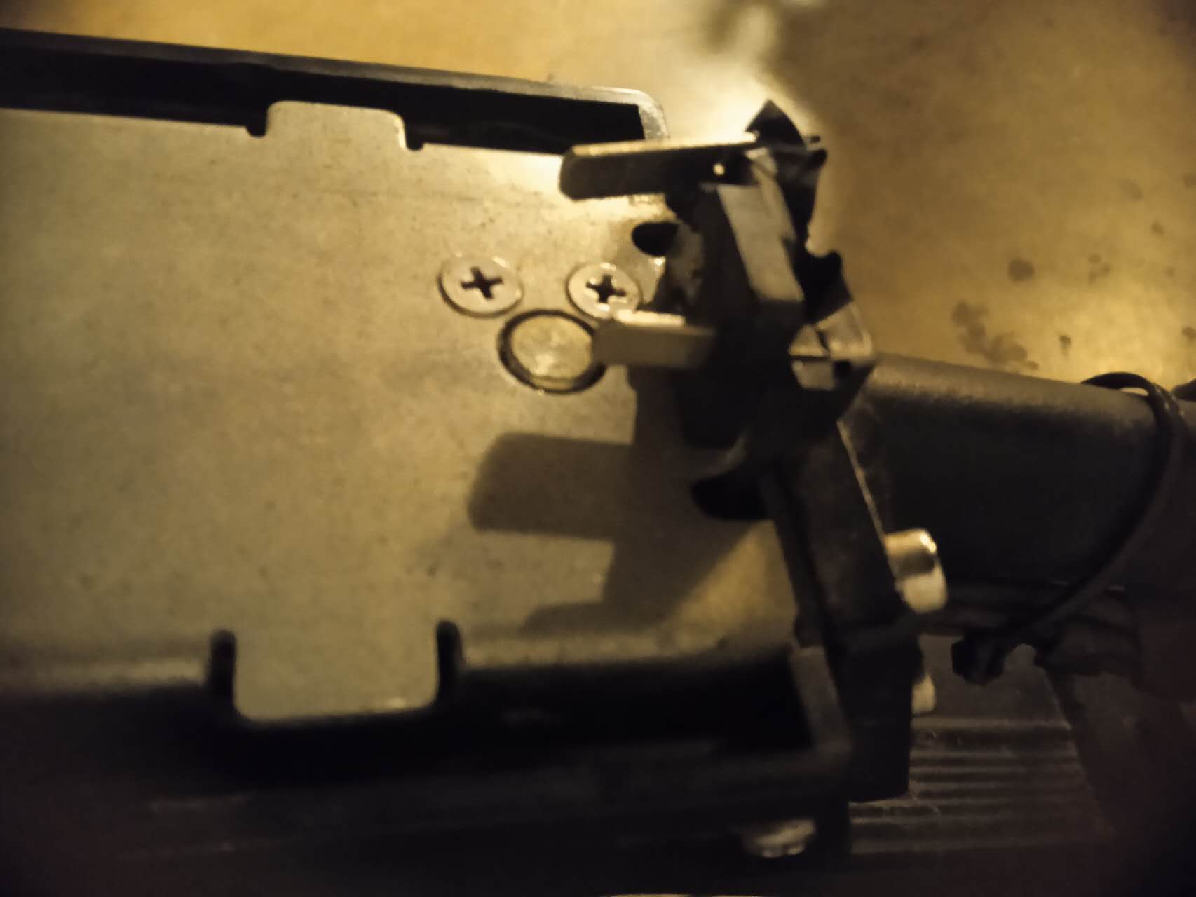

Note that a bit of the plastic holding the 2 metals prongs on the Ebike controller has fell off, resulting in one of the prongs being a bit loose. I kinda strapped it down with electric tape so it doesn't touch the metal bits next to it and possibly short circuit.

It's safer to replace the entire battery, since the Prodeco systems don't have any proprietary stuff between controller and battery--any battery of the same capabilities as the original will work. (it can be higher Ah, and capable of higher A, but it can't be lower, and it has to be the same voltage range

Do you know anything about the connectors though? I am honestly not very comfortable replacing connectors as I cannot solder nor have much equipment. Do you know what sort of connector this is and if I can get any adapters for it so that it may fit more conventional batteries?

I see, I saw another forum saying the stride 500 has a proprietary battery but honestly I don't see how those 2 prongs would be able to tell.
