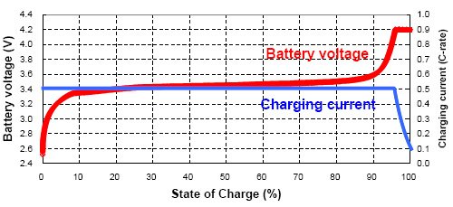

And as far as charging Lithiums the following generic chart show's that the heat dissipated by a charger (power) GRADUALLY reduces during CV (Constant Voltage):

And as far as charging Lithiums the following generic chart show's that the heat dissipated by a charger (power) GRADUALLY reduces during CV (Constant Voltage):View attachment 48979
That graph shows what I told in my post, Lithium chargers are CC CV, in the CV state the charging current (hence power) decreases significantly so the charger is expected to run cooler in that state. That is why it takes way more time to charge the last 10 percent and it is in most cases not worth it.
