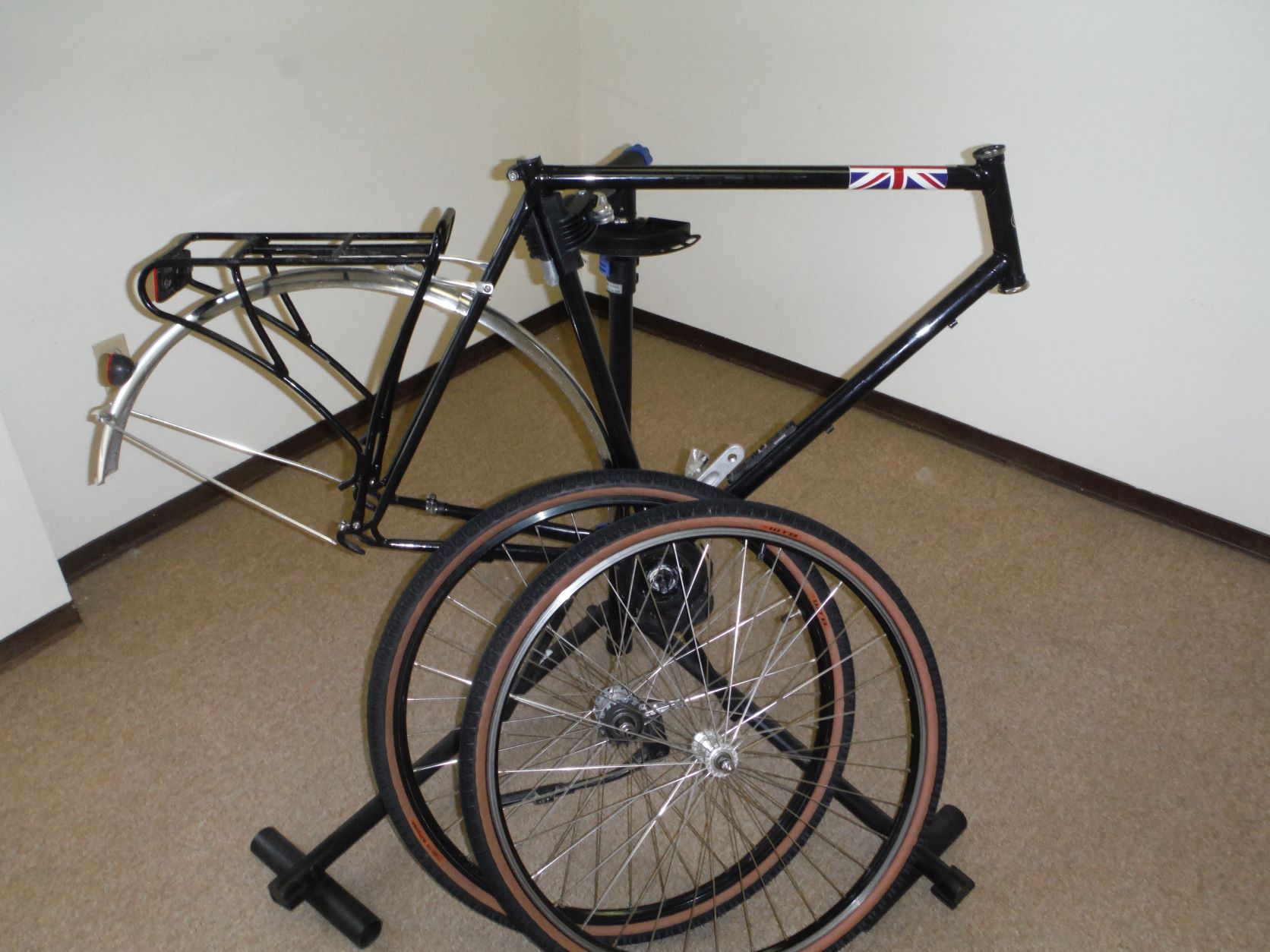

For @PedalUma, would it be feasible to take a standard 3 speed Shimano IGH analog bike and convert it to an ebike ... and be able to keep it well under 30 lbs and have reasonable range? TIA.

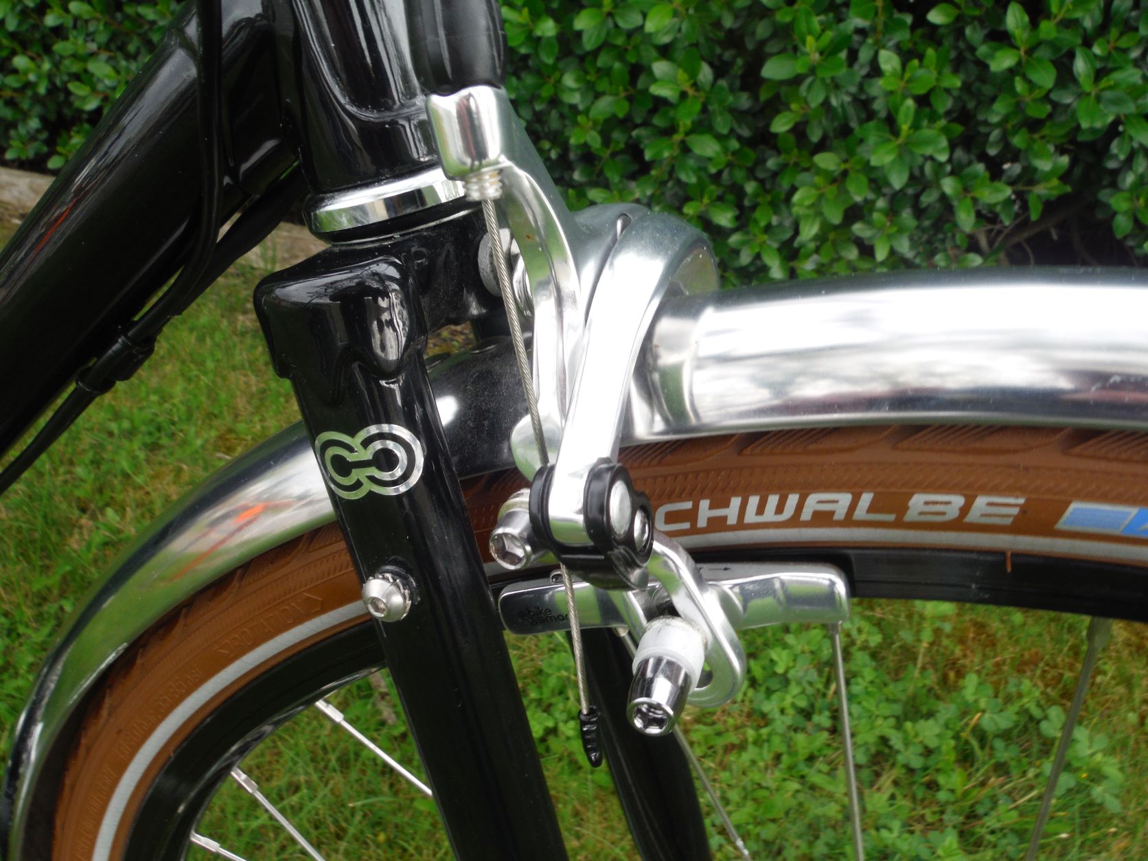

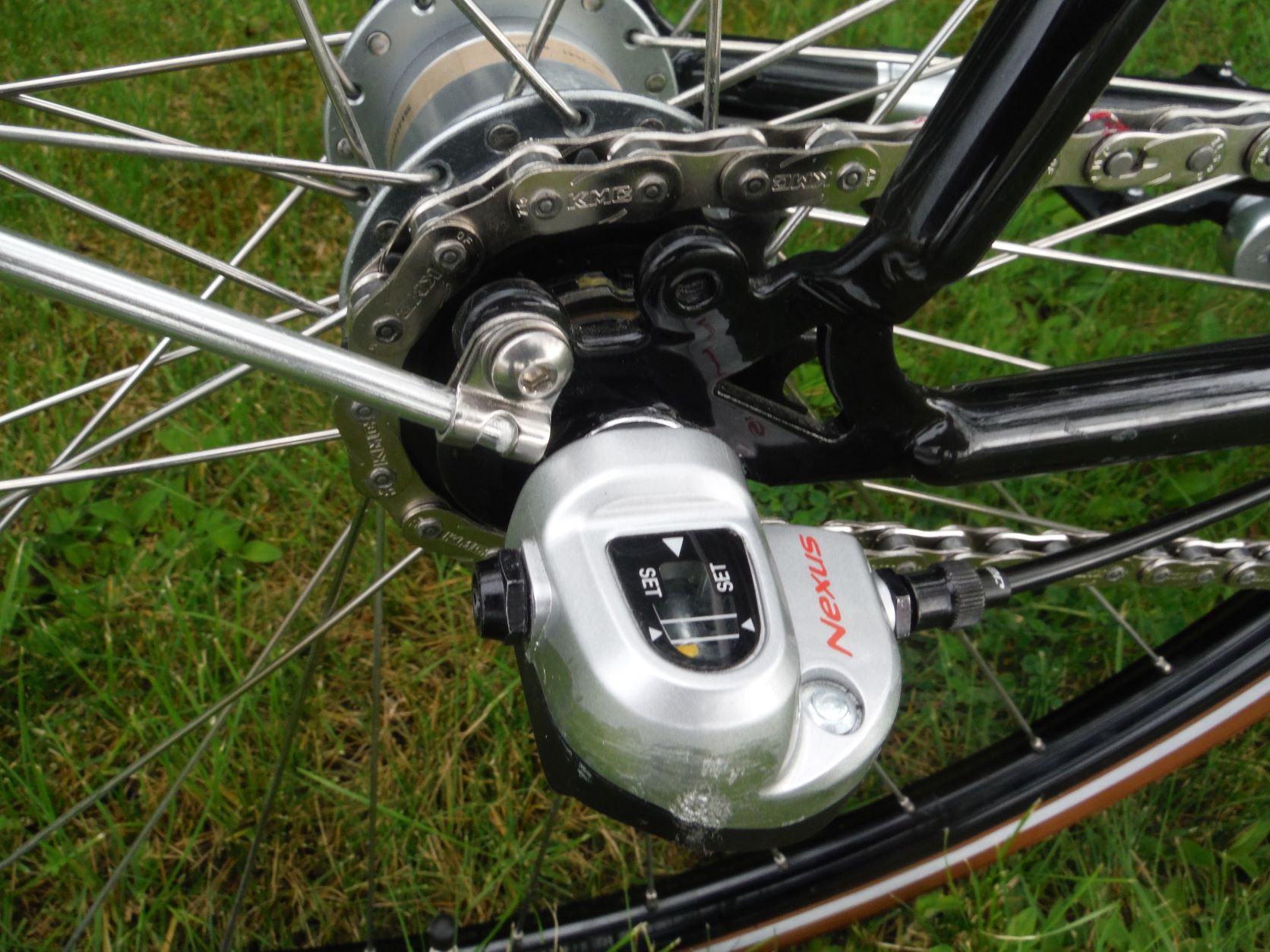

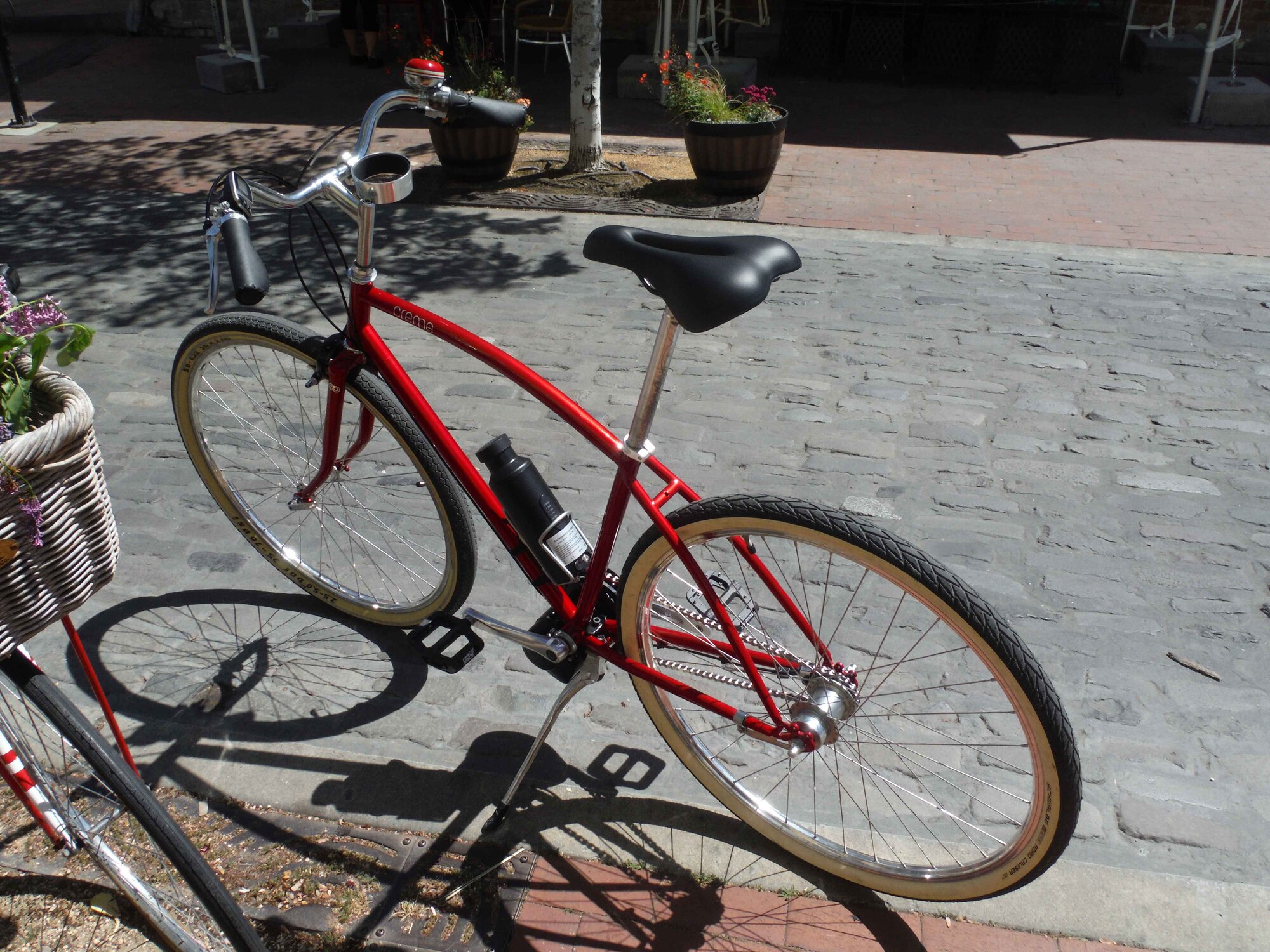

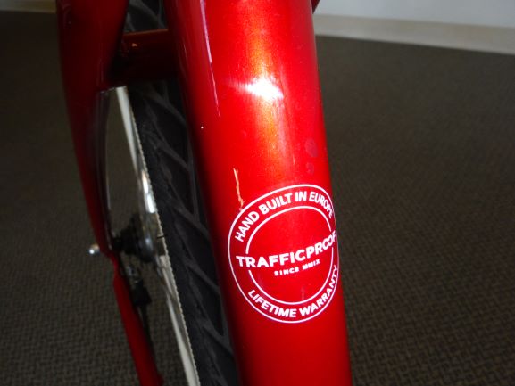

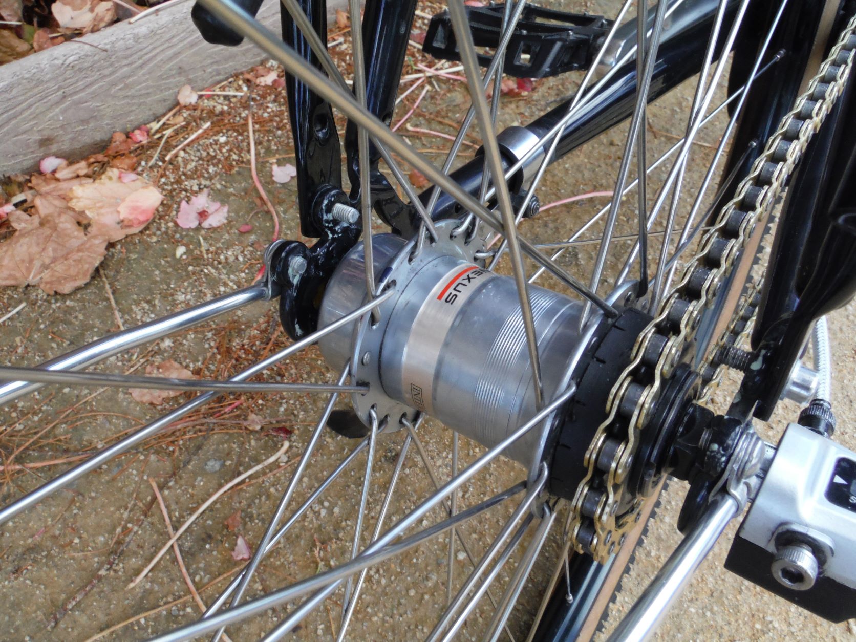

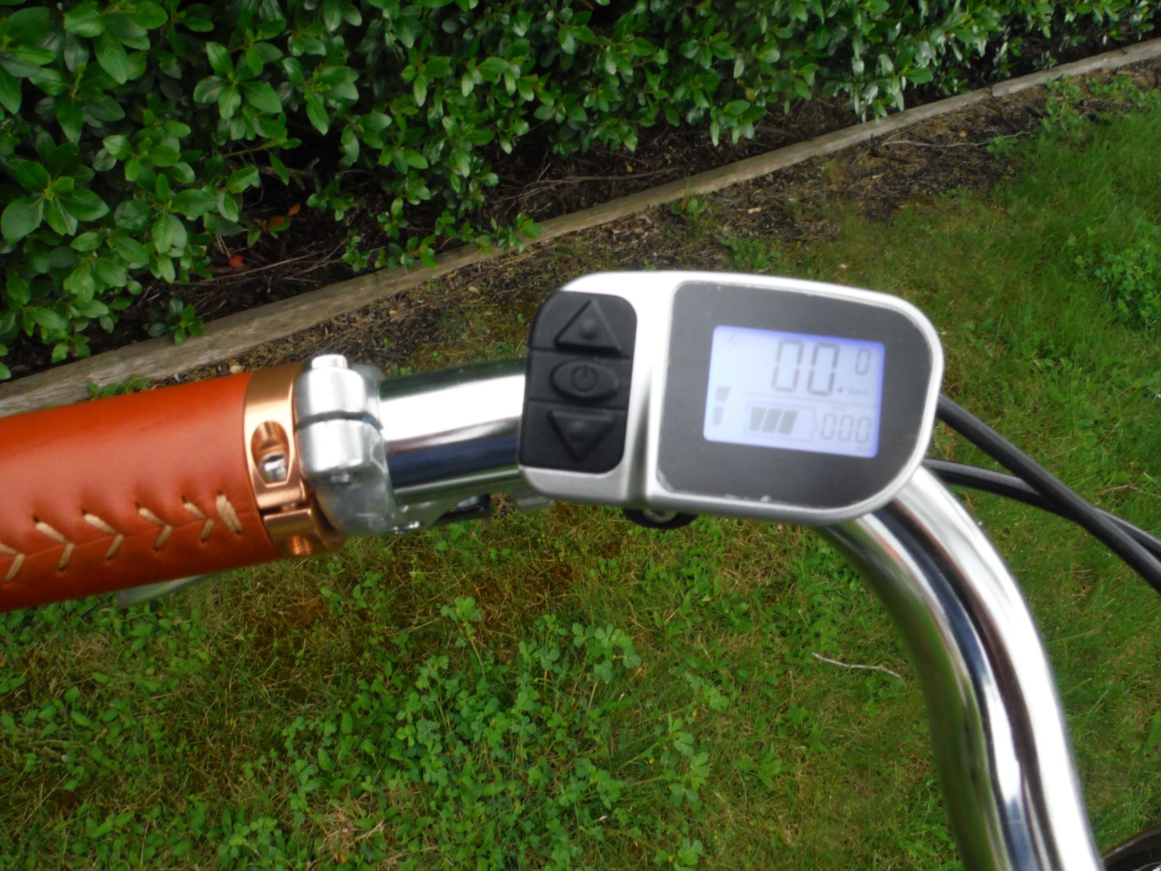

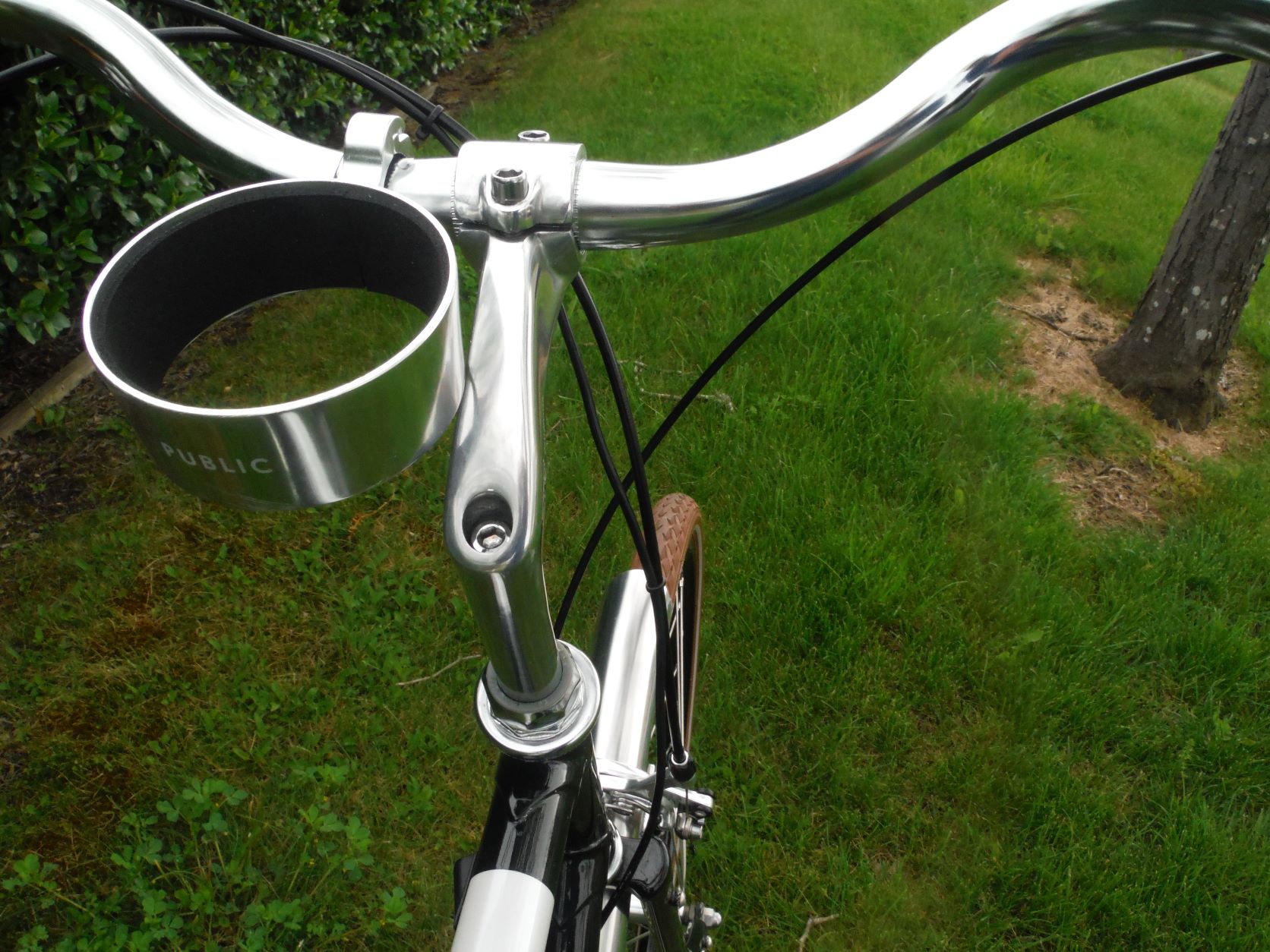

Probably more like 35 pounds or 36 is realistic depending on the size of the bike. Here are three coaster brake three speeds, two of them are very similar but one of those has a Union Jack and gravel tires, the other has a shorter Books saddle. Steel in the real world is very fast because it absorbs road noise and jar so the rider is more confident while going fast.

Beautiful work 😀. Not right right now for me, but makes me wonder about a custom build in the future. Very nice look and simplicity.

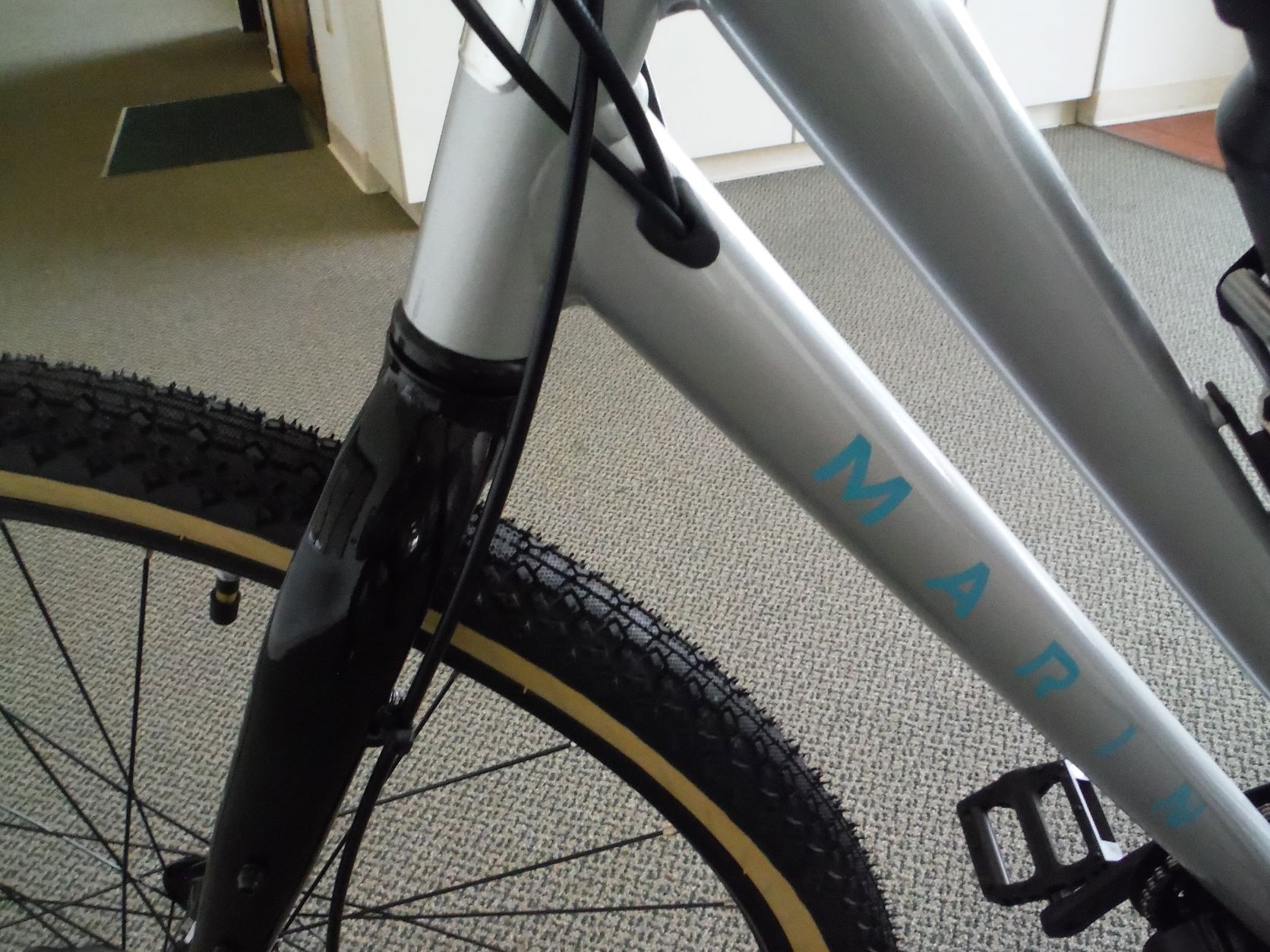

An eight-speed Nenxus or Alfine is better. The five-speed Sturmey is made for eBikes. It is all about getting to to Zen garden of less. No visible connectors, with no extra wires. Clean. The battery wire on this one exits the down tube at the seat tube, zoom to see the trick. It lives in San Francisco on a big hill. This is exactly what good climber eBikes look like.

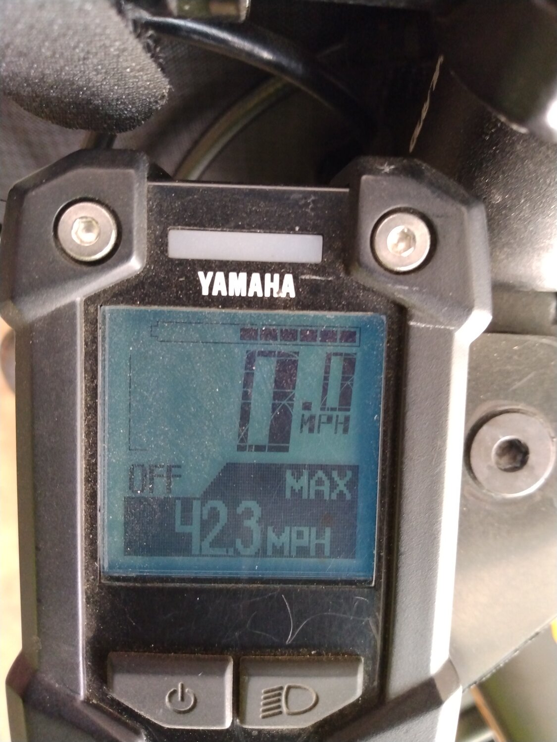

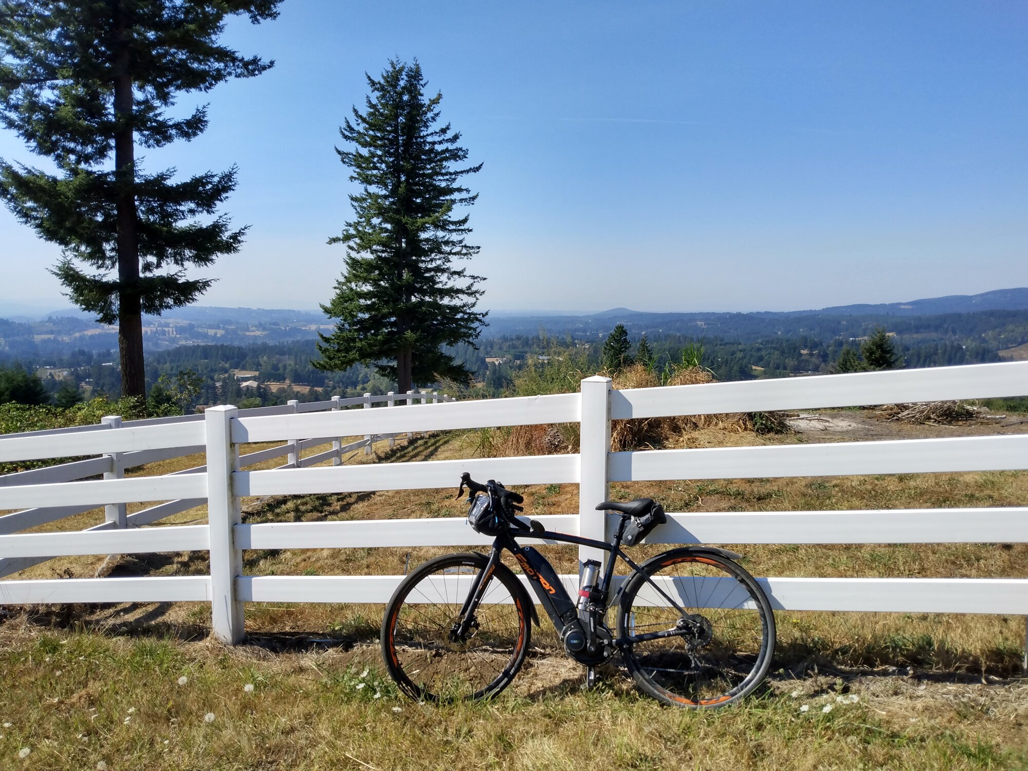

Just got back from a 26 mile ride with plenty of steep hills. 250w nominal mid drive, never used high, used standard for maybe 1/4 mile. The rest was on Eco. Used 43% of a 400wh battery
Rode down to the Columbia and back including the hills in between.
Hills are steep enough to hit low 40s coasting down, with braking.
I don't smoke but I think I could light a cigar on the brake rotors.

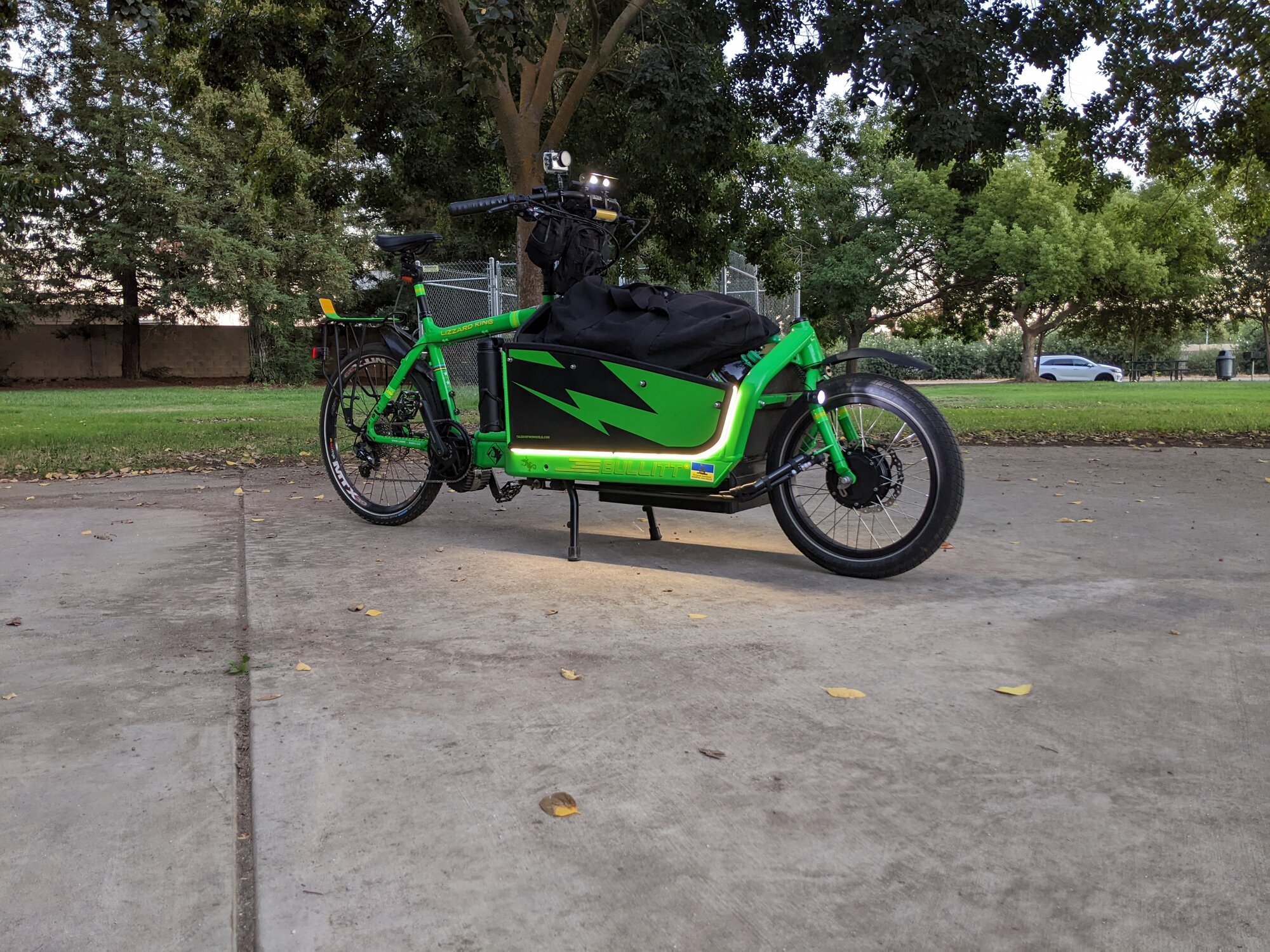

Going awd on a bike will yield really, really good street climbing but it will blow your weight budget out of the water. In addition to the weight of the front motor, which is considerable, you will now have to have a big battery that has a custom BMS that can handle the draw from two motors at once. Wattage is a non issue... its amperage that the two controllers will demand. For the sake of argument lets say you have a BBS02 for a mid drive. Thats going to want 25 amps. And your front geared hub is going to eat about another 25 with a slow-start KT controller. that means you need a battery with a 50a continuous BMS (relying on the peak number for the BMS cannot be done as the twin motors will draw peak power for longer than a peak BMS will last before it pops and you have to reset it).
The awd thing on hills/streets is hard for a lot of people to wrap their heads around as they think the front motor will suffer from a loss of traction. The key is to keep the power reasonably low. say... 2 out of 5 on a KT controller which will yield a steady 250w of output on your display. This is the sweet spot. This gives just enough pull from the motor that it takes the edge off of what the mid drive has to bear and that motor in turn will be able to spool up much faster. End result is you take off like a shot, and the mid drive does not put any shock on the drivetrain. Chains last forever as do clusters if you did all your other homework when you built the bike.
BUT... this is far from a beginner's task. If this is your first ebike build, pick a different project. Also... your 50 lb weight limit is killing you. Its arbitrary and rooted in analog cycling. treat an ebike as a bicycle shaped object and not a bicycle. You want steel parts, for instance, for durability. You will do better forgetting what you know about bicycles and starting over. Then work in your cycling knowledge to your build after you have figured out the ebike basics.

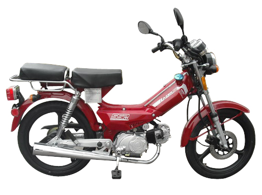

What he and many others ride are mopeds (or motorcycles) built on bicycle frames, if they can travel over 30mph then they are motorcycles and IMO need to be ridden and regulated as such. Different locals have different requirements but for the state of Washington mopeds need the following (if capable of over 30mph then add insurance and motorcycle license endorsement). I'm not specifically against mopeds or motorcycles (I've had many motorcycles and a couple scooters) but they shouldn't be allowed on MUPs and bike lanes etc. They are no different, other than source of energy, than riding a gas scooter and pretending to twirl you legs (or gas moped that has pedals). I agree that the "sky isn't falling" but I expect and would support laws (edit: I'd advocate for such laws and likely to do so) and enforcement against riding these electric mopeds or scooters with pedals in the same manner allowed as real bicycles that only "assist" in the common sense of the term.
Mopeds​
What is a moped?​
To qualify as a moped, a vehicle:
  • Must have 2–3 wheels.
  • Must have an electric or liquid fuel motor with a cylinder displacement of less than 50 cc, and no more than 2 brake horsepower.
  • Can't travel faster than 30 miles per hour.
  • and
  • Must meet all the federal standards for a motor-driven cycle.
Requirements​
You don't need a motorcycle endorsement or auto insurance to ride a moped. However, to legally operate a moped in Washington:
  • You must have a valid driver license.
  • You must register the moped and display a valid license plate.
  • You and your passengers must wear USDOT-approved helmets.
  • You must wear eye protection if your moped doesn't have a windshield.
  • You can't ride the moped on a sidewalk, bicycle path, equestrian trail, hiking/recreational trail, or fully-controlled limited access highway.
or
the electric moped has a higher top speed without pedaling (their video shows top speed over 30mph) but it would not even be legal in Washington as a moped because it doesn't appear to meet (?) federal standards for a motor-driven cycle.
