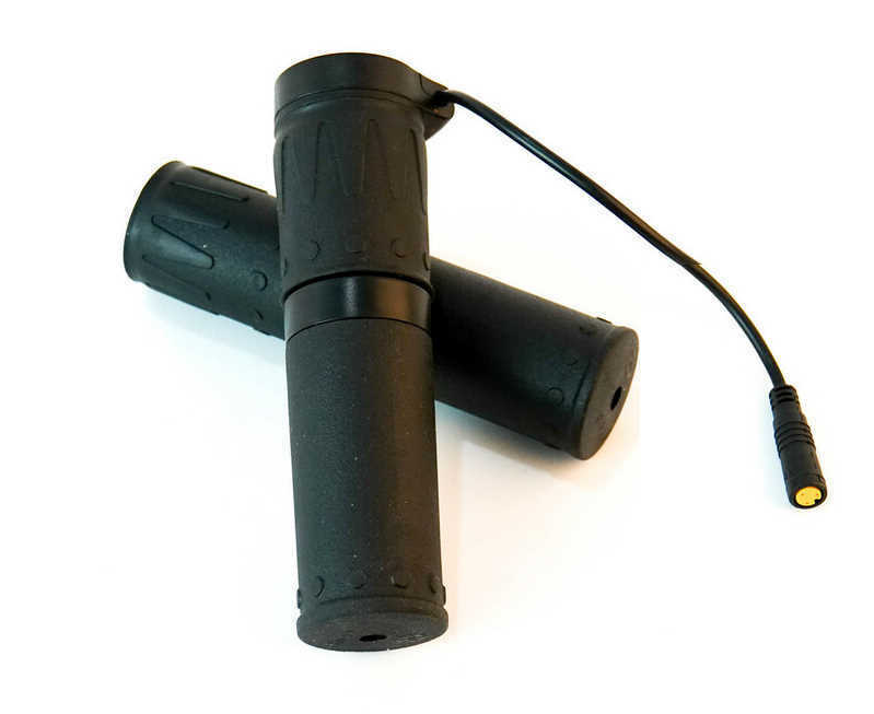

this is the throttle I am looking for with female plug, any idea who sells these?
tried amazon, if the connector is right would the sme throttle work for both the bafang hub and mid drives?
I hesitate to share this, but that's been my experience. Hesitating, because the minute I say that, somebody will come up with something that doesn't work. If it doesn't work, Amazon has a pretty decent return policy, so you wouldn't be out much....
Everything looks quality on my bike just the throttle looks like it was found in a Chinese parts bin.. there are No quantity looking half throttles. Having said that works fine but looks cheap as!!!..puts my bike down
I think magura make a quality looking e bike throttle but it's a full 😕.
