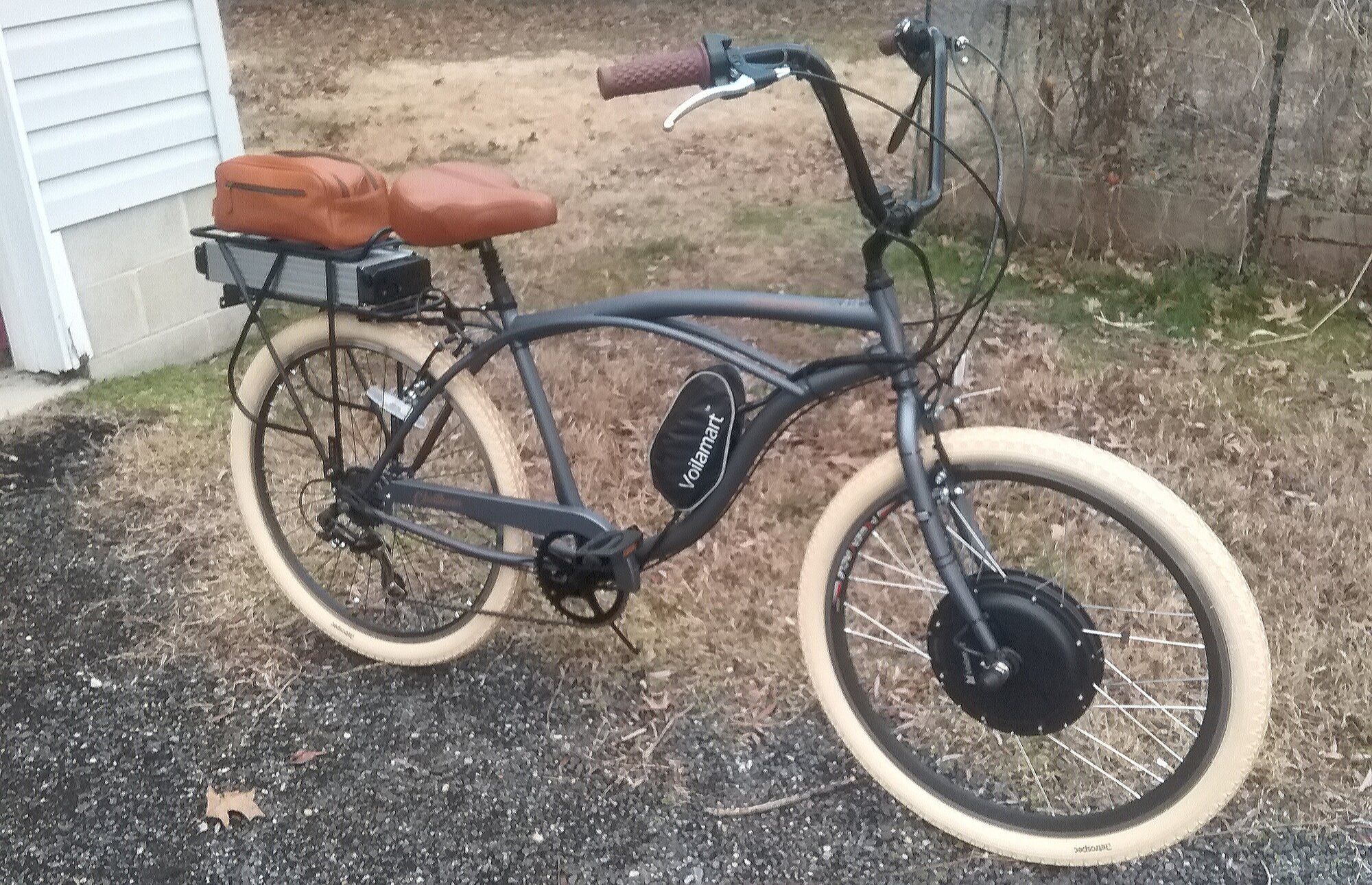

Thanks Taco Mac, I used a Voilamart 48v 1000w front hub kit, with a 48v 1000w 12ah battery and rack on the rear (weight distribution is good- albeit a little high...). Originally I built it on a Raleigh Sc7 that I inherited from my dad, then my wife gave me a Retrospec Chatham beach cruiser for Christmas to which I transferred the kit. I did add some "mid-rise" handlebars as I don't find the beach cruiser bars comfortable. All told, even with the cost of the new bike, it's around $850...

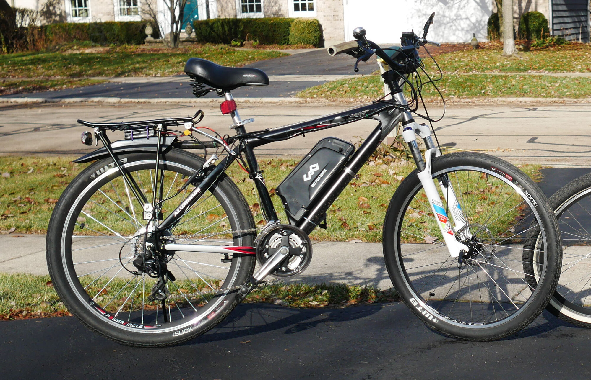

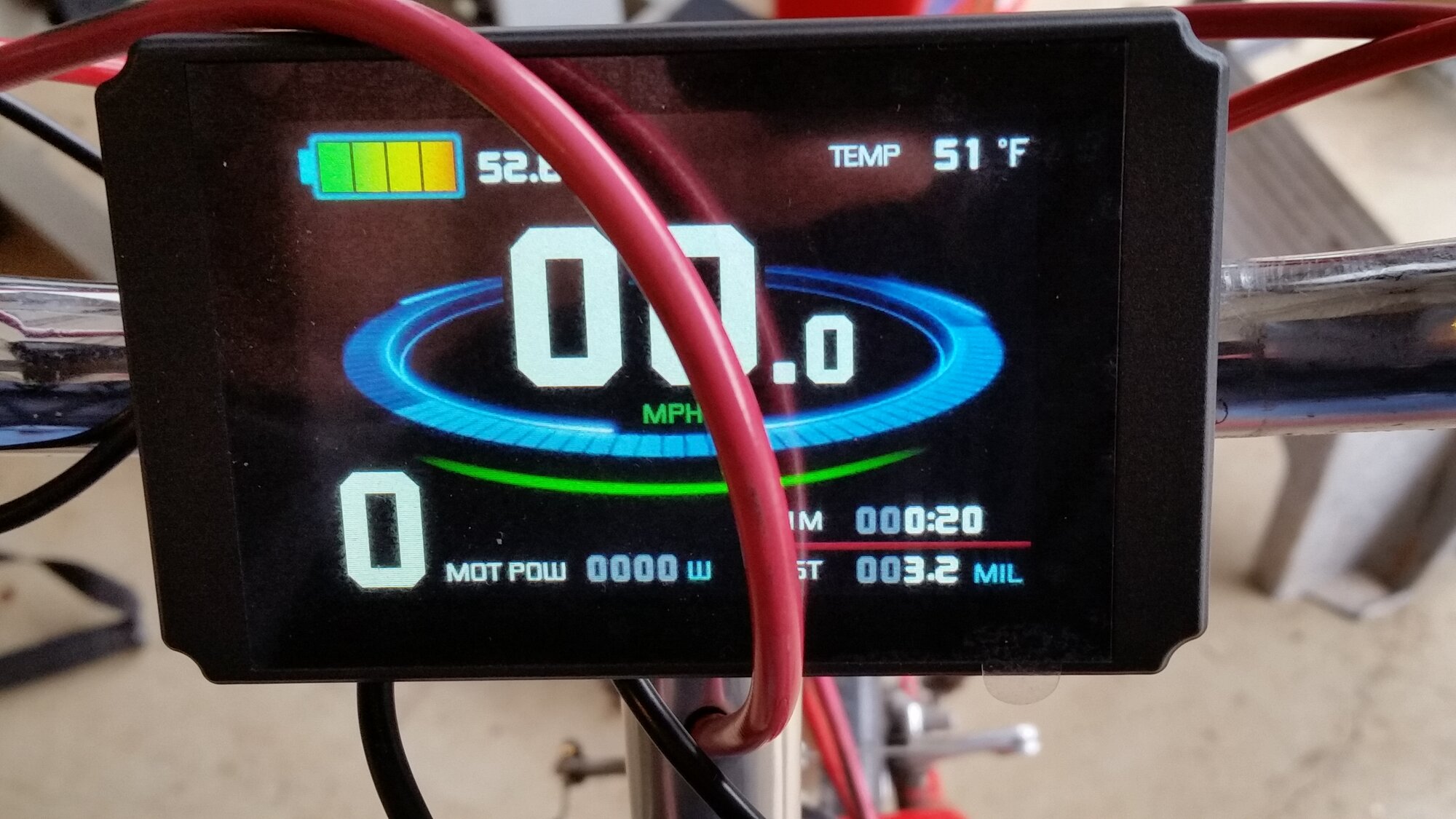

I'm not making recommendations but here is my most recent ebike kit build finished last week. 48v 500W geared hub motor with 11-22a KT controller and KT display. I'm liking it so far. Smooth power delivery without lurching with PAS and has taken me up some steep hills with a lot of pedal effort from me but not in the lowest gears (middle front chainring, middle rear cog) where I'd barely (or not) be able to make the same ride without assist. Cost $280 for a pretty complete kit including torque arm, throttle, stick on brake motor cutoffs (so no need to change brake levers), bright front and rear lights, the controller bag.
The controller is easy to program with the KT display which has good information. Here is the display on the lowest brightness setting
I have a 48v 15ah/720wh battery advertised as having samsung cells and internal dividers, not glued for ~$220

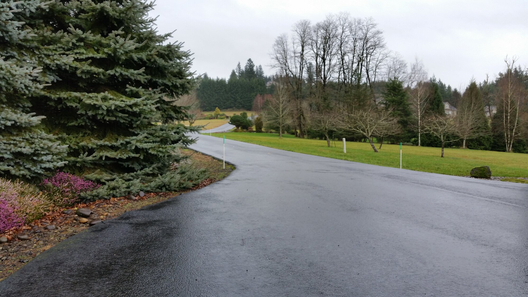

Pictures don't show grade well but I took it up this road, ~3/4 mile with over 300ft elevation gain including flat sections up to the base of the trees in the picture near the house. The steepest area is difficult to walk up.

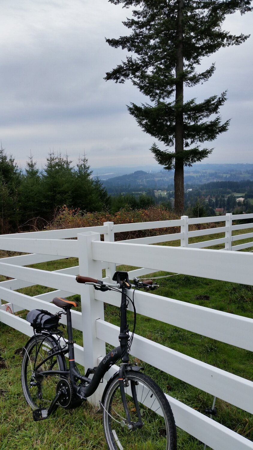

It seems to do about as well on this bike as a Tongsheng 36v 500w mid drive that I installed on my wife's Dahon Briza which, in turn, does almost as well as my Yamaha powered gravel bike.
Here is my wife's bike with the Tongsheng which can make it from the base of the mountain (the ribbon of river to the left center of the picture) to here at near the top where I rode the bike above.

Thanks Taco Mac, I used a Voilamart 48v 1000w front hub kit, with a 48v 1000w 12ah battery and rack on the rear (weight distribution is good- albeit a little high...). Originally I built it on a Raleigh Sc7 that I inherited from my dad, then my wife gave me a Retrospec Chatham beach cruiser for Christmas to which I transferred the kit. I did add some "mid-rise" handlebars as I don't find the beach cruiser bars comfortable. All told, even with the cost of the new bike, it's around $850...View attachment 78059
LOVE this setup, what kind of wheels are those and how big , must blend nice on the beach! Like the battery in the back, what knind of rack. simple break pads I assume, Ive got disk now but eventually switch over to something like the formula cura 4. You and your wife must do a lot of cruising, do you pull any heavy loads.

Also that display,what is it? very cool!!

My battery and rack came as a unit. The battery slides into the rack and locks with a key. Having recently had a second back surgery, I am fortunate that the island we live on has miles of paved trails, and is basically flat... we plan on doing a lot of recreational riding this year
