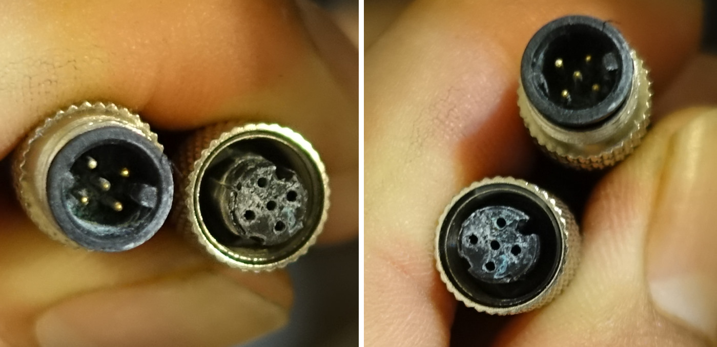

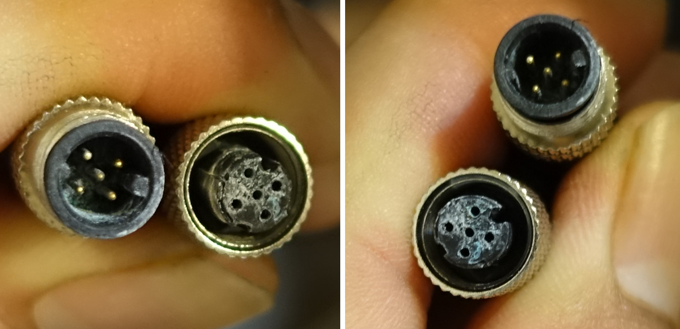

Not sure if this would affect the assist, but I think this has been the issue with my CC's blinking display & shutting down. Looks like corrosion in the connector from the display. I've read that dielectric grease will prevent this.
Youth, Dow Corning DC4 is a good electrical grease. I would use some Boeshield to clean the electrical pins (let it sit overnight) and then add the DC4 to waterproof the connector. Both of these products are popular in the aviation maintenance world.
Looked it up and expensive. Thought might have some at work, but closest thing is Dow Corning Molykote 111. That should work too? Data sheets show that both are very similar.

I'm not sure on the 111, description says food grade silicon lubricant. The DC4 description says electrical insulation compound. There's some on ebay for $15.75 shipped.

I just may go for the smaller cheaper stuff at a local autoparts/home improvement store. The DC tubes are pretty big that I will never use it up.
Going to get replacement display & wire harness, but in the meantime this temporary fix has worked to keep the contact going. The assist seems to be working normally too so in my case the bad connection was probably the cause of all my issues.
