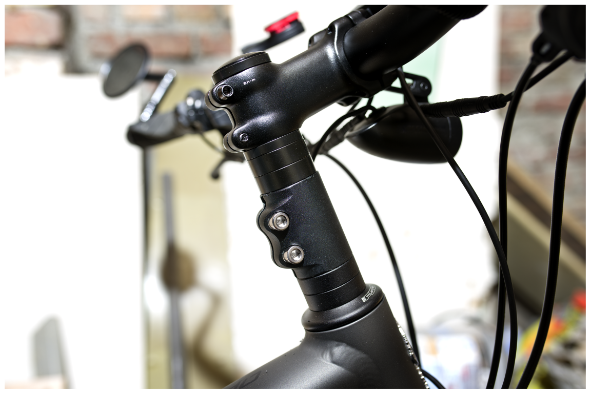

It appears @Yamahonian your stem is of the A-HEAD system, de facto standard in MTB. You can rise your handlebars by some 3" with a standard 75 mm "stem riser for A-HEAD" system, mounted on the steerer tube. Your LBS can easily get one and professionally set it up for you. These 3" more really change your riding position from forward to upright. More than 3" is not recommended as the cables might be too short.
This is how it's done in my Turbo Vado 5.0, which inherits many features from MTBs.

You could try the (2) but I recommend you raise the stem with the riser first. See if that's good for you and if you are still suffering, replace the handlebars. Your objective is to relieve your aches, not to ride totally upright. When a headwind hits you, you might discover it might be hard to lean over the handlebars to reduce the wind resistance if you will ride too upright.

I would suggest you get the Steering Tube rise First and see how that works . If you want the handle bars closer then get a stem Riser like a Richie adjustable. The last thing I would mess with is handle bars : You start screwing with geometry and put Cruiser style sweeps on an MTB you would not be happy. Plus it would look kinda goofy :
Do the Steering Tube Riser pictured above first: That might be all you need . If you want the handle bars closer after that : The way to do that is with a Stem Riser :https://us.ritcheylogic.com/us_en/bike/stems/4-axis-adjustable-stem
