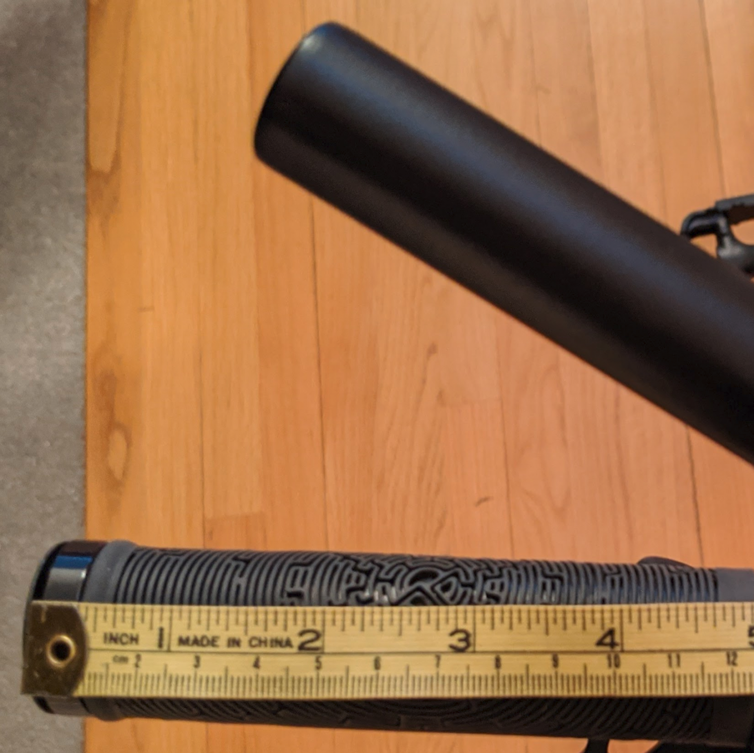

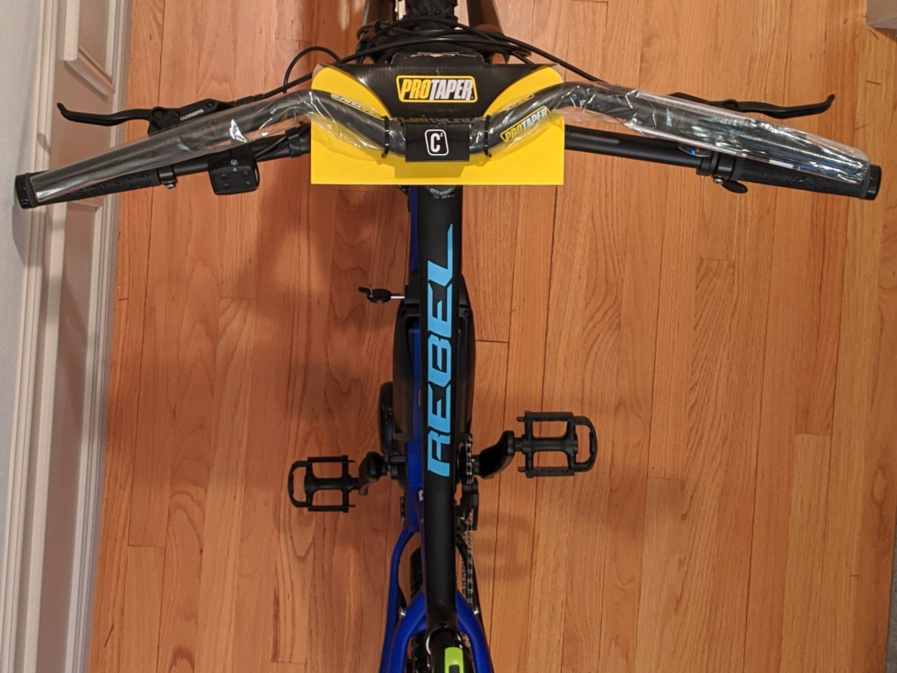

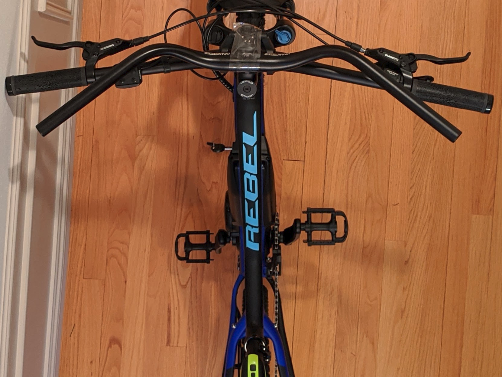

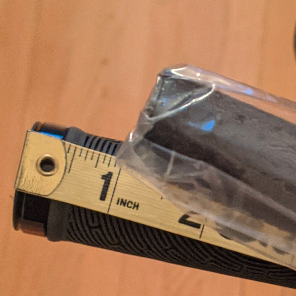

I decided to order the two bars above to compare. I got the 20/20 from level9sports as they were cheaper than amazon ($110 after coupon). Initial impressions: The Upanbike bars might make for nice "comfort" handlebars for casual riding as they have a bit of a rise in addition to sweep, but feel tiny in comparison to my MTB bars and too short for off road. The Protaper bars came today and wow, these things are truly feather light. Unfortunately they shipped me 720mm bars instead of 820mm which I ordered. I think they will be ok as I prefer shorter bars, hard to tell until I install them. I can see these being a nice compromise for off road.
Upanbike (640mm):
47171 47170
Protaper 20/20 (720mm):
47172 47173
The Upanbike bars might make for nice "comfort" handlebars for casual riding as they have a bit of a rise in addition to sweep, but feel tiny in comparison to my MTB bars and too short for off-road.
The Protaper bars came today and wow, these things are truly feather-light.
Unfortunately, they shipped me 720mm bars instead of 820mm which I ordered. I think they will be ok as I prefer shorter bars, hard to tell until I install them. I can see these being a nice compromise for off-road.

The Protaper bars look perfect! The 720mm length should be fine... only 1" shorter than OEM.
