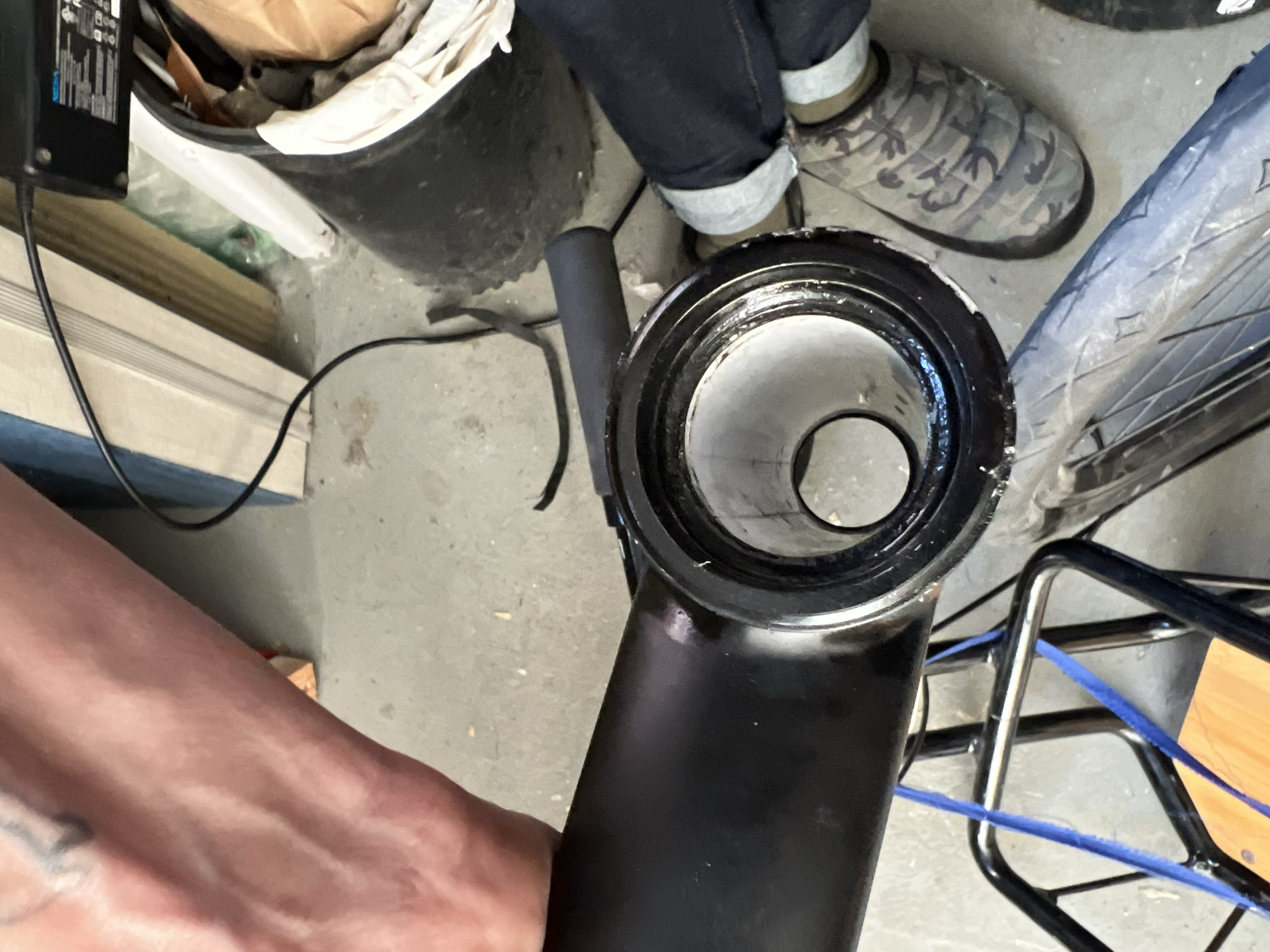

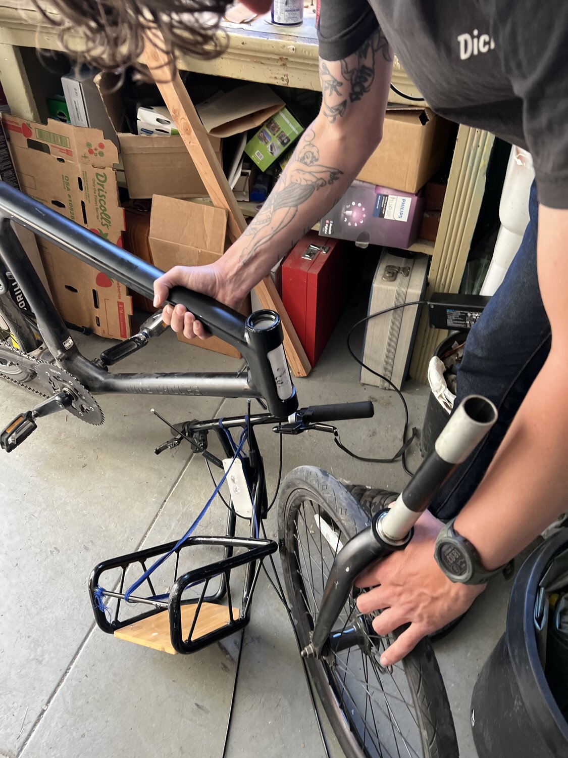

Where is this board on the bike? I have the same problem, but I'd like to get the board out without damaging a bike.
Hi,
this seems to be the only blog with information about this bike. I have the same problem, the bike seems dead.
I have the same question as @brandonshults01, how do you access the board on the bike?
I'm trying to disassemble the bike but I haven't found any instructions online.
@Jaseer @Damone @RustysBikeHire
Thank you.
Hi
GPS Board is located inside Steam , where the cable liner is going , there is 2 part one for cable liner & other for the GPS control board .
