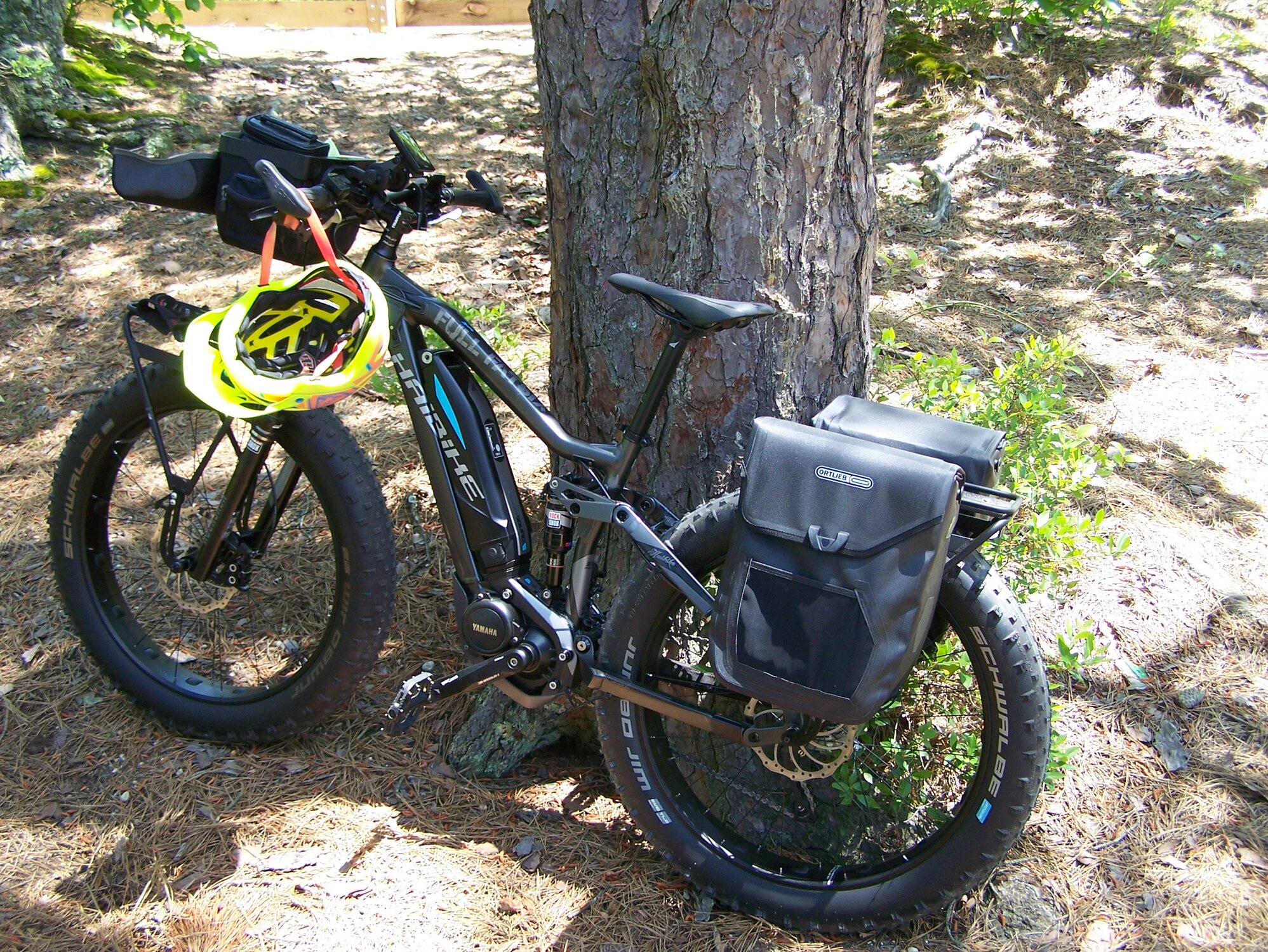

Sigh, here we go again. The Quietkat Jeep is no longer produced (I bought one of the last ones for %50 off), but this thread raises a number of issues that plague countless other threads regarding the fact that people fundamentally don't understand the differences between various modes of two-wheeled transportation.
First, a 1,000W e-bike is not a moped or a motorcycle. If you think a street legal e-bike is a motorcycle, then you either a) don't know anything about e-bikes; b) don't know anything about motorcycles; or c) both. I own a Quietkat Jeep and I get this all the time from know-nothings on the street, and also for another e-bike I own, a DIY, dual-motor, dual battery bike truck built on an old stump-jumper frame with a gonzo 'mullet' set-up: the front wheel is a 26x4" fat tire and the rear is a 26x2.15". It's not a true mullet, as both wheels are 26", but it achieves the same effect via the tire sizes. Anyway, people see the fat tires and they blurt out, "That there's a motorcicle, derpurp!" Sorry to be harsh, but it's gotten really old: edumacate yerselves, folks. Fat tires are not motorcycle tires, they are meant for slow speeds on sand, mud, snow or grass. Motorcycle tires have a much smaller diameter, and are meant for motorcycle speeds. Fat bikes, btw, have been around forever (probably 50+ years, idk the exact origin). The fact you are not aware of what they are does not make fat-bike + e-bike a motorcycle.

I've tried upgrading the QKJ to a high range transmission, and I acutally need to start another post about that here or somewhere else, because I'm having a lot of difficulties with that: I've tried a couple of different drive-trains and they both have resulted in weird chain-suck issues in high gears that seem to be related to the torque of the Bafang motor. I have also tried riding it in the sort of extreme conditions in which I've ridden lighter, more agile bikes, and the results have been... physically painful. It is my opinion that this bike is too high-centered and too torque-y for steep, off-road hill climbing. It turns out there is sort of sweet spot for that. I tried this recently and it resulted in my front wheel shooting up off the ground, causing me to fall backwards about 6 feet and breaking a rib. There were other factors involved in my act of derpery, but I still maintain that the QKJ is ill-suited to steep technical climbs. It is crazy torque-y, but still an e-bike, only weighing 70 lbs., and not having enough power to back the torque up. A dirt bike, by comparison, actually has less torque, but much more power, weighs a lot more, and has skinnier tires, so it will shoot up hills with a planted front wheel where this e-bike will just flop over backwards. And this really comes back to what this bike is for... it is perfectly suited to off-road terrain on sand, mud, snow and grass on flat or moderately hilly terrain. That said, it is really well planted for descents. It is however, again very high-centered because of the size of the tires which makes steep technical descents also kind of scary. It is also surprisingly good in a city. It is equipped stock with CST Roly Poly's, which have surprisingly decent rolling resistance and cornering grip on asphalt, but you will of course need to purchase a rack or a trailer for this bike. Trailers work better on this bike imo. Those tires also go up to 30 PSI, which is very high for fat tires, but it means that it works great going back and forth between road/off-road if you air your tires up and down properly for conditions.
