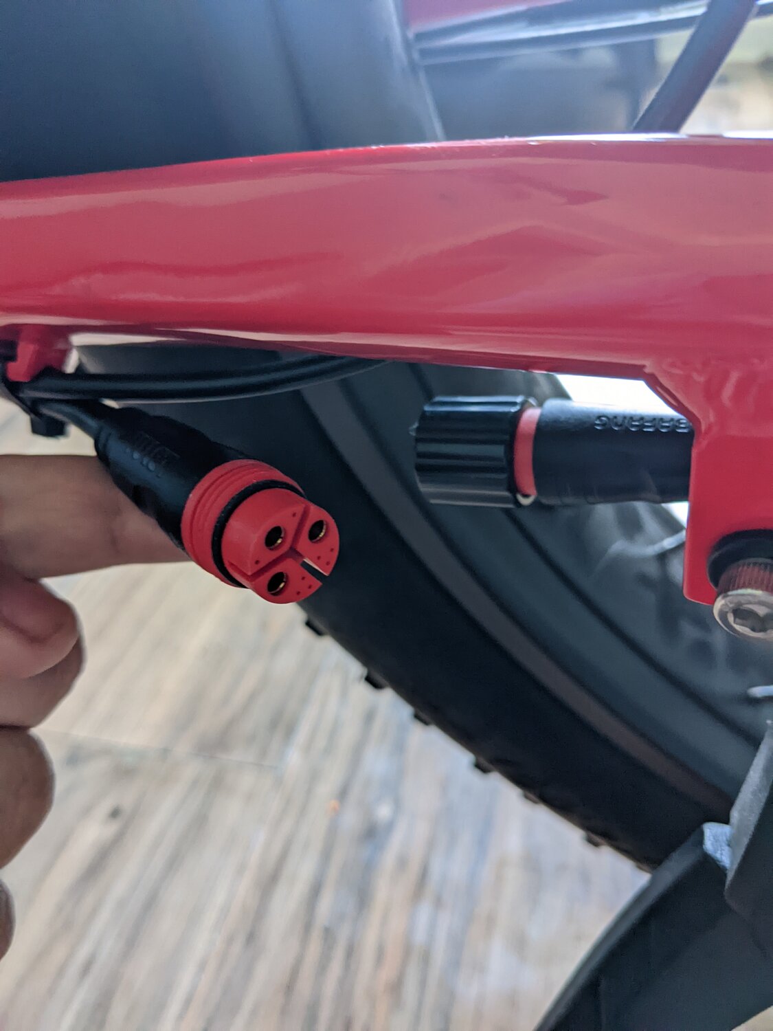

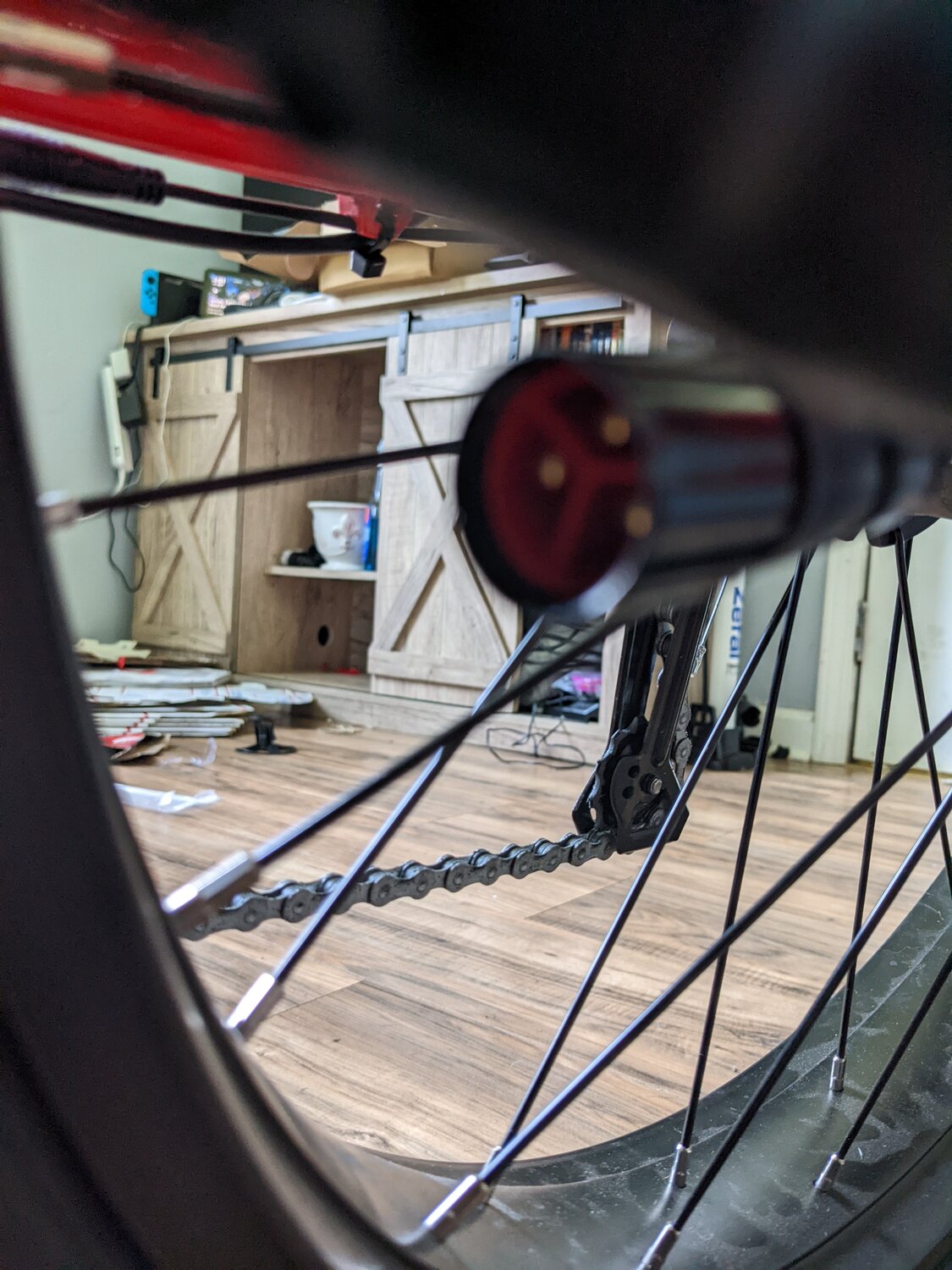

Its the connector on my 1000w motor on the new Juiced rip current s. Getting a new controller and if I knew the connector name I thought I might be able to get an adapter for my new controller before resorting to splicing wires.

I think it's a type of XLR connector.

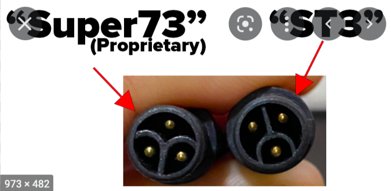

Maybe this website will help
Another ST3 version? Bastards and their proprietary connections! I don't expect you'll find an adapter.

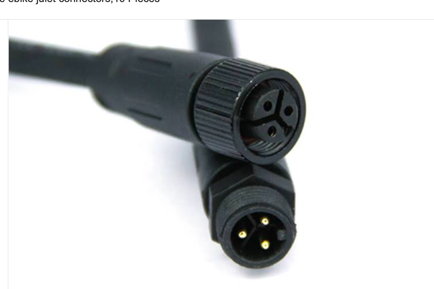

On Alibaba. But no single sales. 10 sets.
