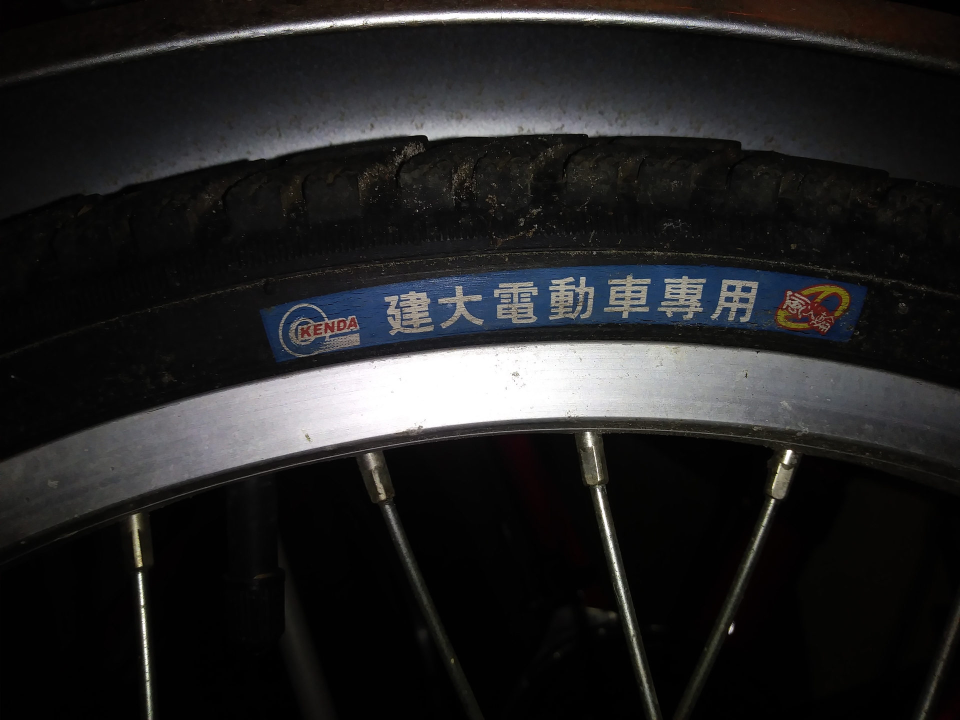

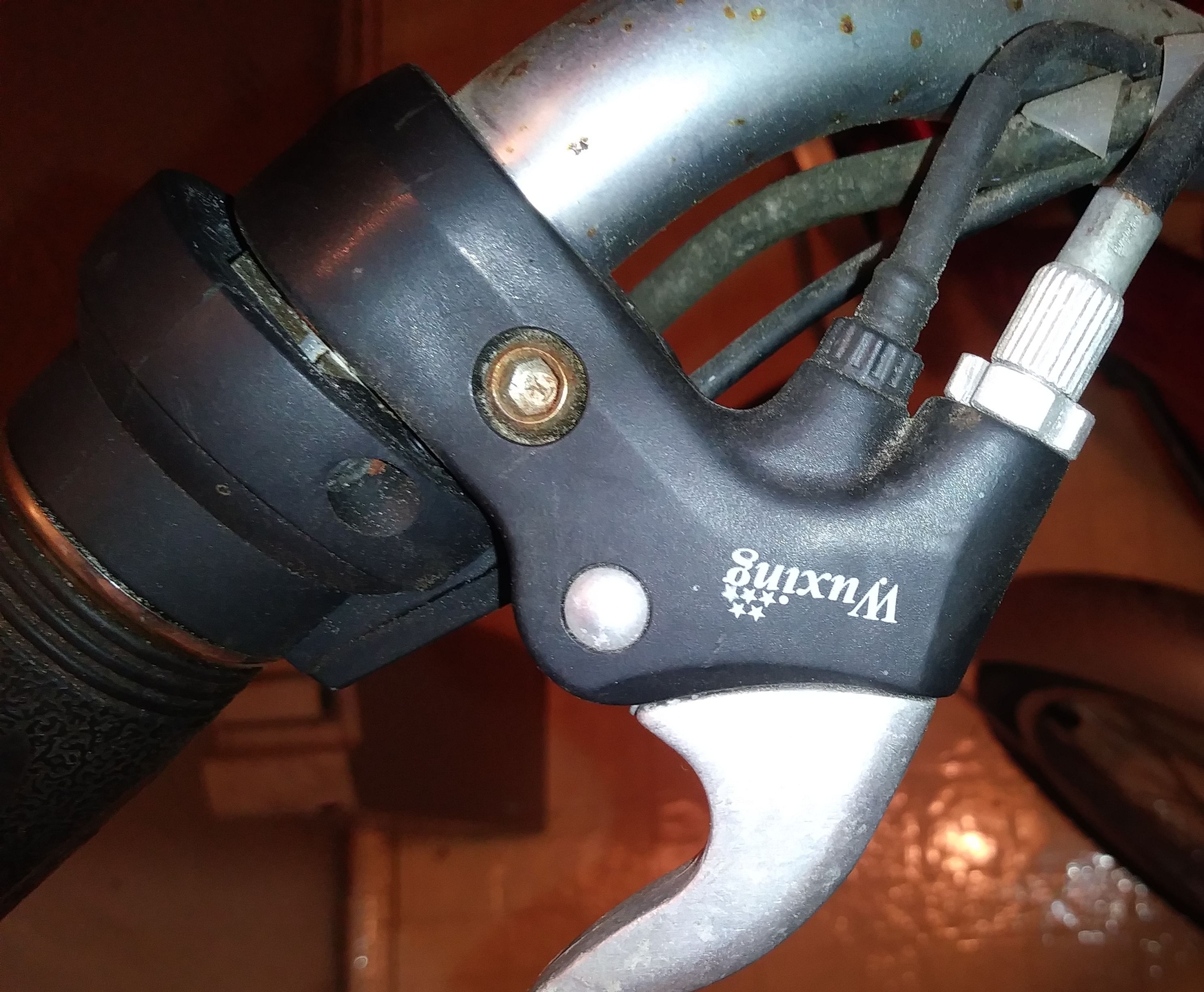

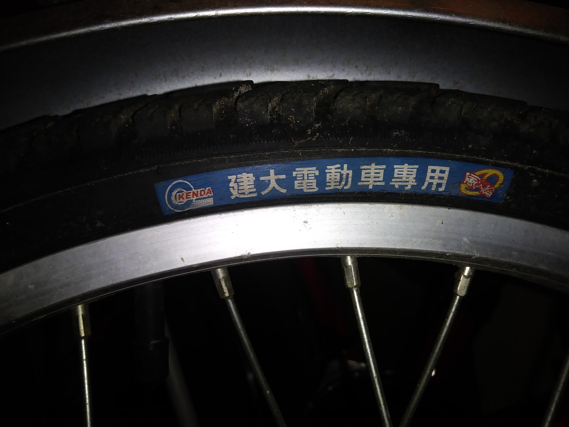

Hey, new here, well not really. I've been a long time visitor of EBR but I'm new to the forums.

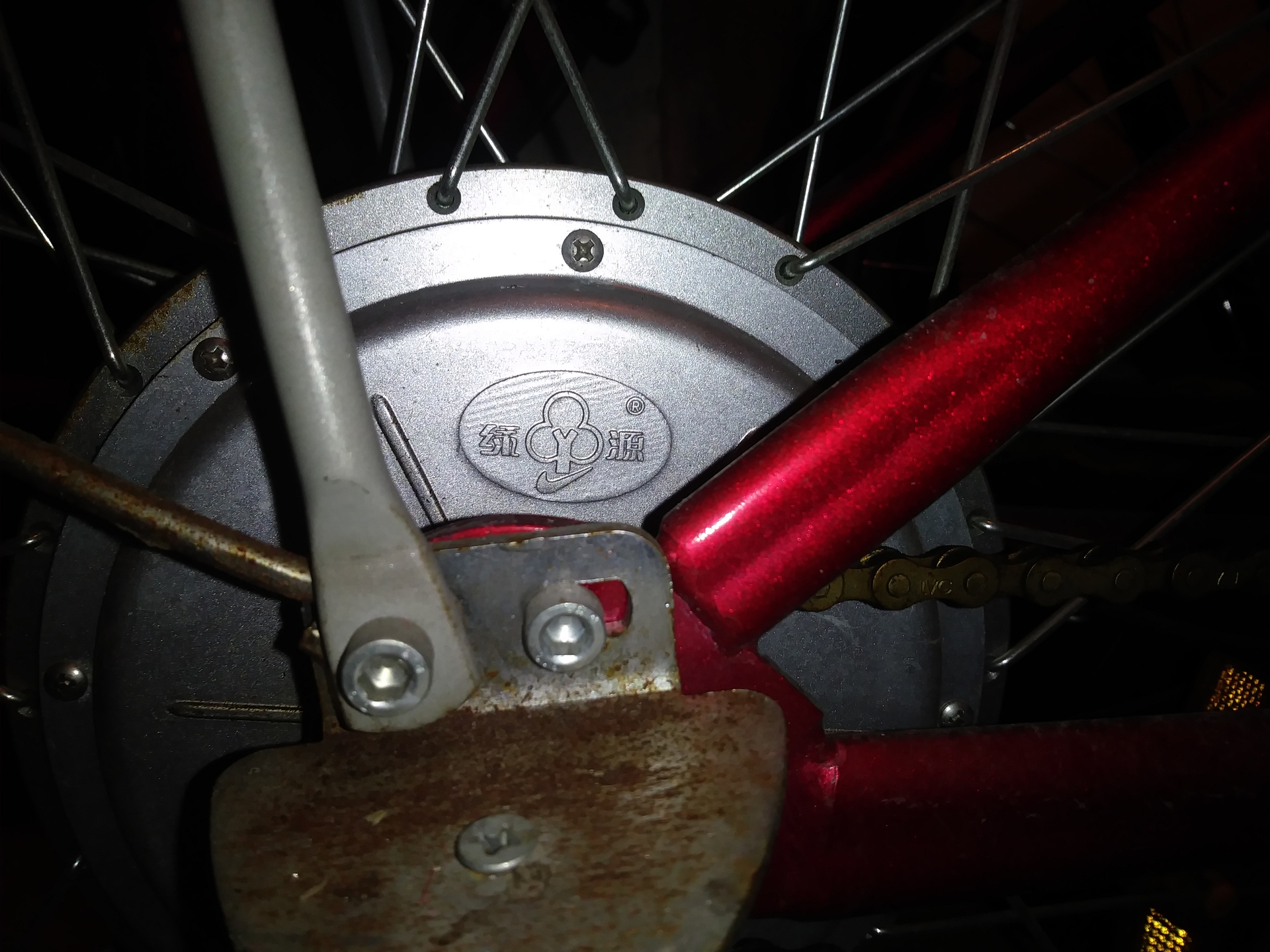

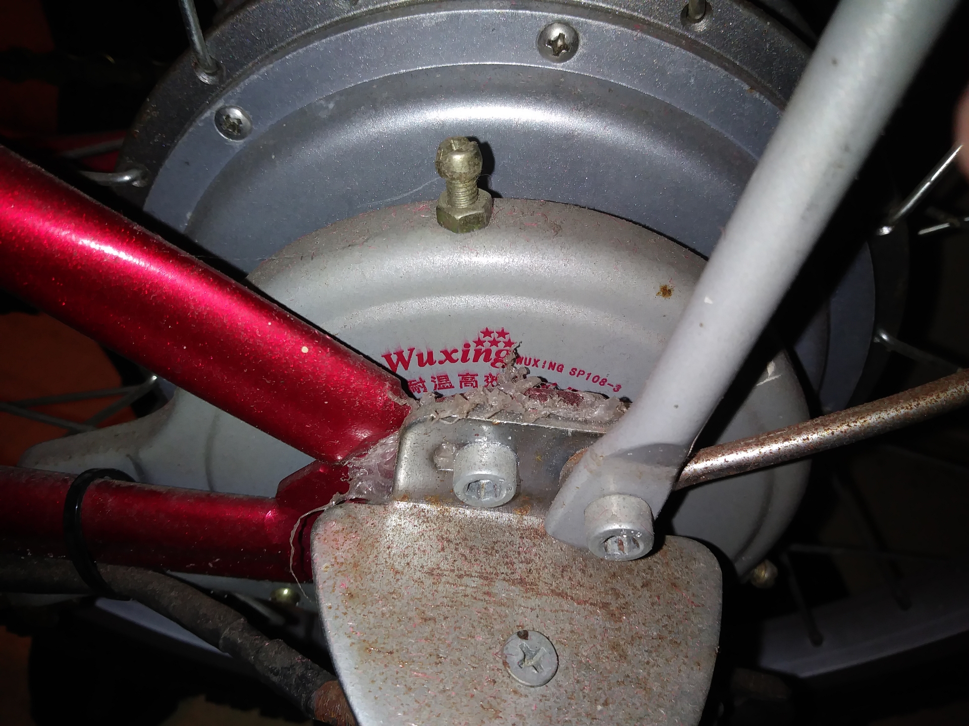

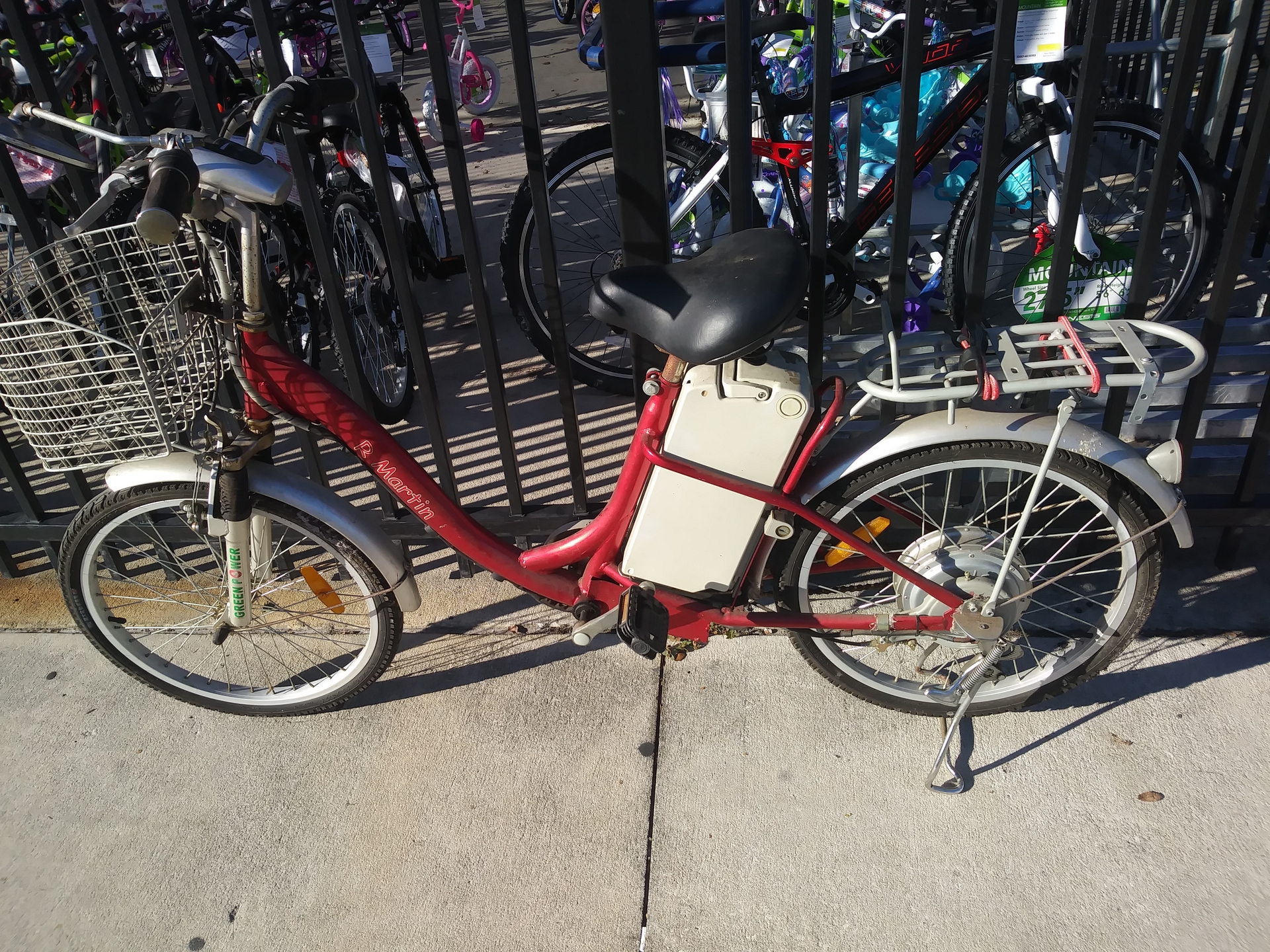

Anyway I just got a bike from someone and it's not running at the moment. The battery seems to have a very small charge on it enough to make the horn sound very low. But nothing else works. It appears to be a very old e-bike from R Martin.
I don't have a charger for it and I would like to be able to charge it somehow. I'm experienced with electronics and have some capabilities to charge it already depending on battery chemistry and voltage but I'm new to e-bikes. It's a very heavy and large battery, seems like lead acid. And I tested the voltage which sits currently at about 14.70v. So that's in line with a lead acid battery (on charge) but its also kind of high for a low resting voltage. So I suspect it might not be...

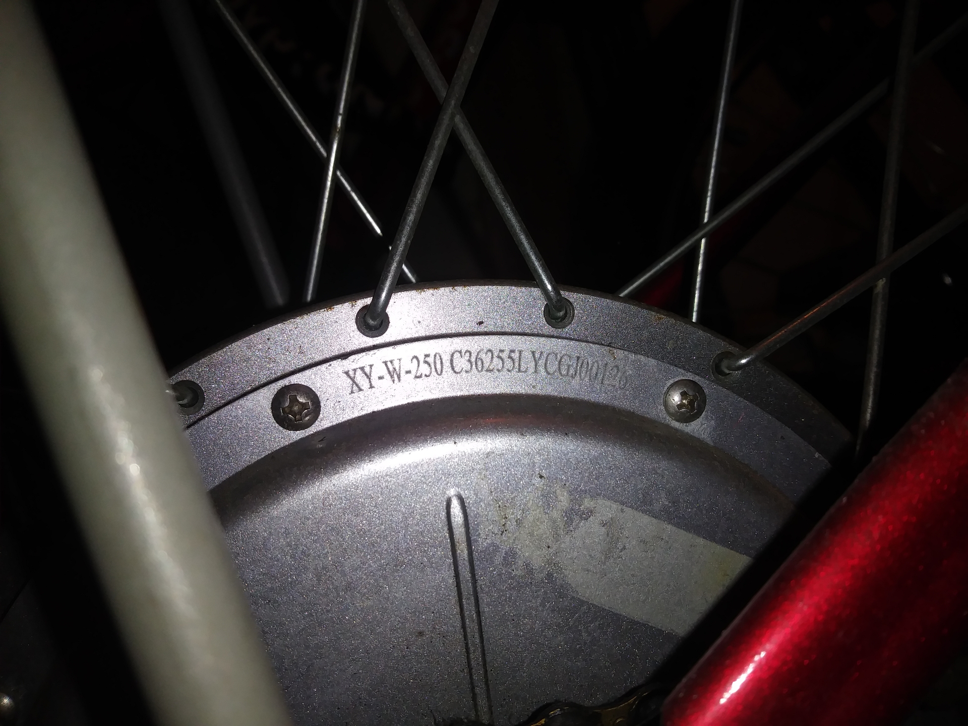

I'll add some photos on here, I'm hoping someone can lead me in the right direction for a charger or at least tell me more about this bike. I don't even know it's wattage. But I do know it appears to be a rear geared hub motor.

Classic Chinese super crap..wouldn't waste my time
Hey it's free and the OP says he knows his electrics. It was likely state of the art in 2005. Wuxing still makes most of the little electric stuff found on many bikes today,
Probably a 24 volt battery, and if it is lead acid, it's a goner. A peek inside might show a battery with 12 cell (2.2V each) compartments.
Long term, you can replace it with a lithium battery, For now, test it on 24 volts.
Good to know that about Wuxing, means I may still be able to get a charger for this somewhere. I read your reply at work today and as soon as I got home, I opened the battery to find three 12v lead acid batteries of unknown capacity. Of course I could have already done that but I didn't notice the screw holes at first and assumed it was 'maintenance free' sealed. heh.
So the bank is at 36v. I can charge them now but I would rather have a better way to charge them in the future than the way I'm currently doing it, preferably a purpose built charger. But I can put an XT60 connector on it and charge it from that in the future. But the good news here is that I have tested the bike on 35 volts and it runs. All the functions seem to work.
And yeah it's really old, the headlight is even incandescent :eek: heh. I'll replace that with my current bike's headlight. I do plan to ride this. Maybe eventually upgrade it with lithium batteries, but for now lead acid should do. I've been pedaling for nearly 4 years now to and from work. I prefer to bike then use a huge metal weapon of death and pollution for just for me.
I have tested the batteries individually and they were all really low; <5v. I know this isn't good for the health of the batteries, but I think I can revive them, they do seem to hold a charge and not just drop almost immediately.

It is a chinese Wuxing ebike.
What does the charger port look like @D1G1T4L3CH0 ? You can find the appropriate SLA batteries at any local battery store, they're 12V 12ah lead acid cells. Go to Amazon and order a 36V 1.5 or 2amp SLA charger with the end that matches your bike's. Also check the polarity on the battery pack charger port and make sure your charger matches that or it won't do anything :D. Most of those chargers have a little picture on the back indicating which spot is positive and which is negative.
This is a much older, heavier ebike with SLA batteries, so I wouldn't spend a lot of $$ on it. Also, see if you can put together a 36V test pack first to see if this bike even runs. The RMartins are notorious for controller failures & other issues. We've worked on a number of them at the shop.

heh. Yeah it seems that it does cut off after a certain low voltage. I tried 24 volts first and the motor didn't even try to turn on.
It's a pc plug type. The same one that goes into the back of a computer power supply. The polarity is negative left and positive right. Also it's internally connected with the middle pin to a piezo buzzer for alert sounds. It also does have the indicators embossed on the plug which is good to know. I noticed a lot of chargers I found don't even indicate polarity. But that's not a huge concern for me since I could just reverse it myself. But I rather not have to. I'll just have to look some more, I haven't found a decent one yet that comes from the states. I rather have to sooner than later. Most come from china as to be expected. Yep the bike works, well the wheel turned anyway, not very fast but the power supply I used really wasn't cut out for such high current anyway.

I'll look more for a good charger to buy, cheap, I don't want to spend much money on this thing. Maybe later I will invest in a lithium one or build my own from 18650s. Still unanswered though; does anyone have a clue of the wattage of the motor and do you have the google-fu skills to find an old spec sheet online for this bike? I don't have a clue what model it is so that makes it harder for sure. I did find something very similar but with different colors and branding.
Anyway I think as someone pointed out already, this is just a project bike. A first foray into the e-bike world and to get some experience with it before I decide to commit to throwing down some real cash.
