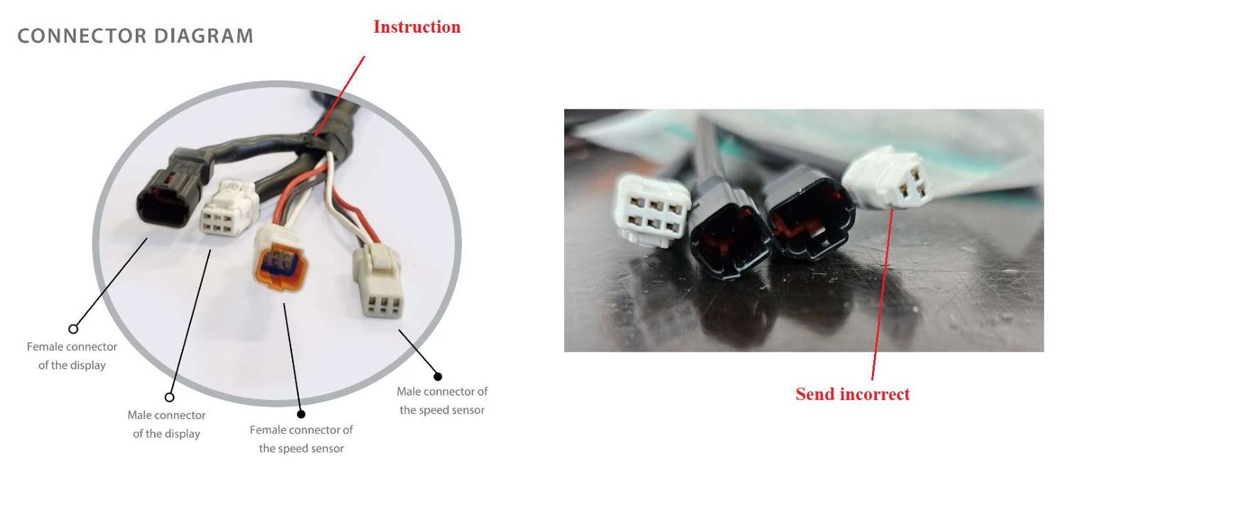

A short update: the speed unlocker I ordered (see link in previous post) does not fit. There is a wrong connector for the speed sensor. Unfortunately Ridewill has two different pictures of the fittings on their web page which I did not notice. Below a picture where on left side is the connectors from their instruction and on the right side what they send:
I contacted Eplus directly and they guided to buy directly from their website: https://www.eplus.bike/en/prodotto/yamaha-wabash-rt-booster-crosscore-rc/
So I ordered this one and now waiting a week or so to get it.

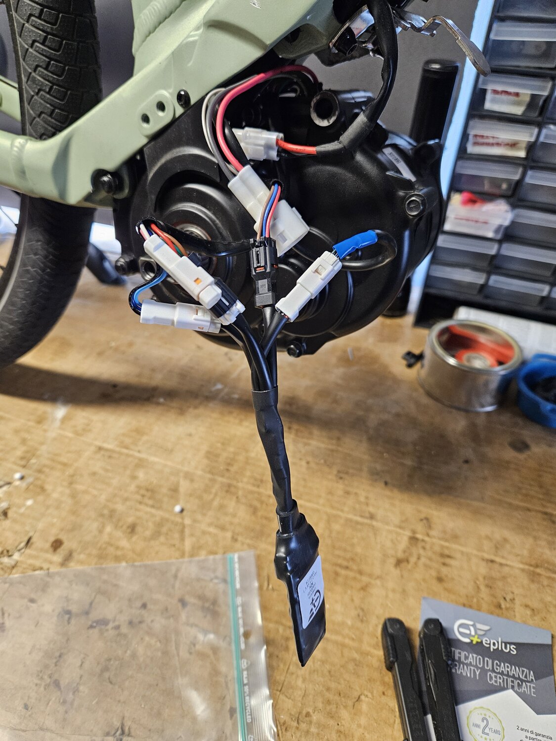

SOLVED!
I got the Eplus kit and it was easy to install, plug n' play (see pic). Eplus requires and app to be purchased (0,99€) to enable speed unlimiter. I did this and it works perfectly. In practice the max continuous speed is app. 35km/h due the gear ratio. But I'm satisfied with this speed and loooking forward get some mileages for the bike!
