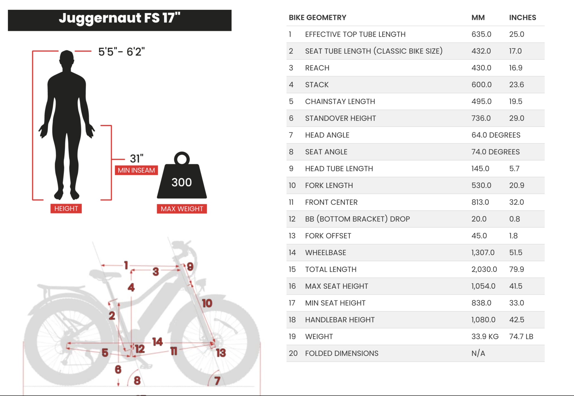

I've been looking at the FS and so far I cant find the info I want . What is the measurement on your shortest frame from the ground to the seat post , where the dropper would enter ?

Could you email us at [email protected]? We can measure this for you. I believe it's 30" but if you email us, one of our techs will double check for you.

You've seen this, right:

You're asking for #6, plus whatever the tube length is above the top bar, so Roshan's guess is certainly within a ½" of being correct. But, this isn't an important measurement. If you're concerned about fitting a dropper, then #2 is what you're looking for, as that determines the distance from the seat to the middle of the crank, so you can measure your existing bike's distance and determine if enough seatpost would be sticking up to accommodate a dropper.

No , I am short with a bad hip and I need that particular spot to be less than 30" , more like 28 . I solved this on another bike I have by putting 24" wheels on it , cutting the seat post down and inch and using shorter cranks . I could solve this one that way too but I dont have another set of 24x100mm wheels .

You asked for "ground to the seat post" dimension. Using shorter cranks doesn't change that dimension.

Yes, if you change the wheels, you'll likely need to get shorter cranks so the pedals have enough clearance from the ground. We have 150mm cranks for the Ultra motor on the way to us from Miranda.
