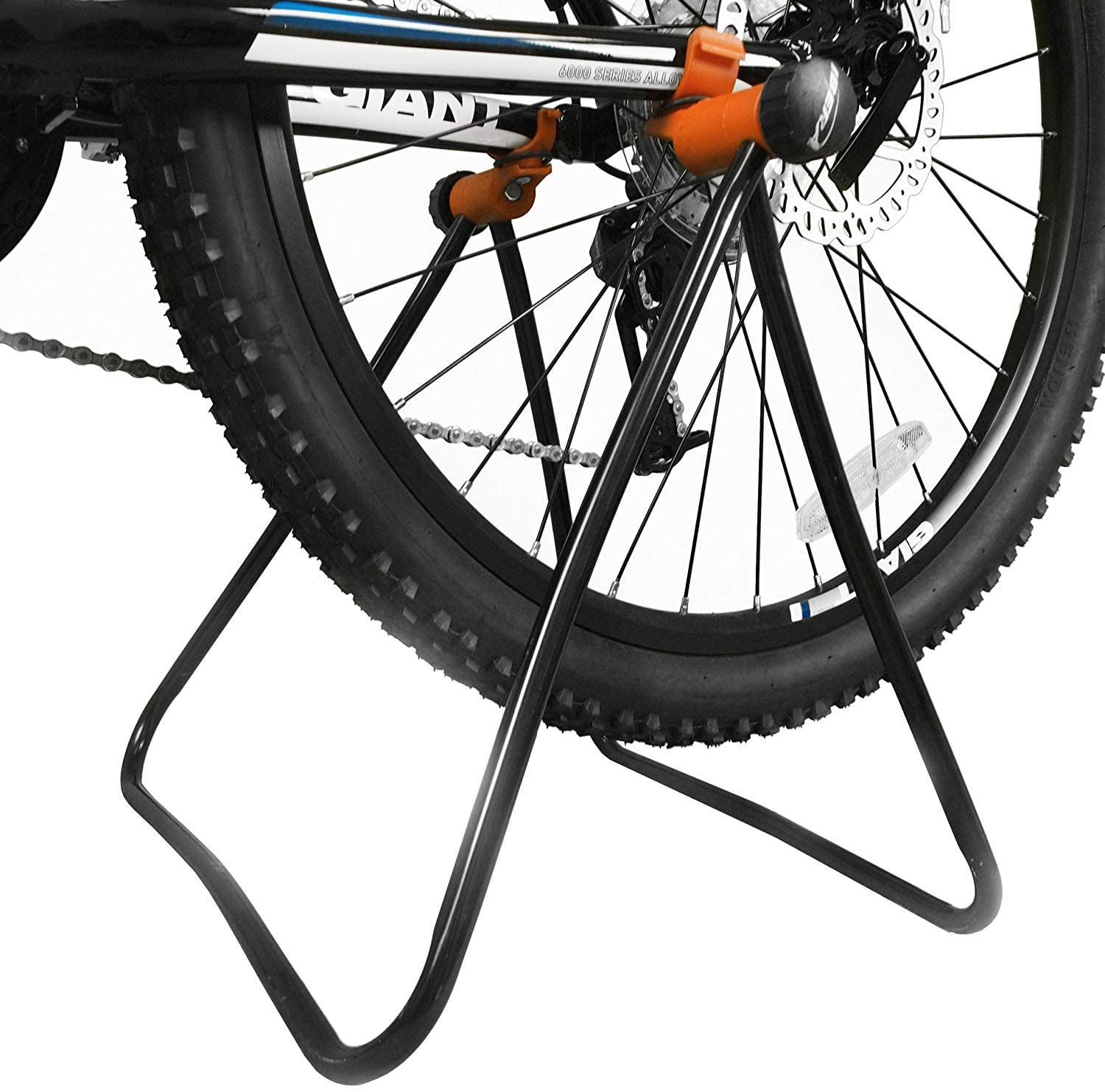

Do you have any ideas on a design for a bike stand to lift the rear tire off the ground for ebikes with fat tires?
This is what I use:

This is what I use:
I recently purchased this bike stand and found that my rear chainstays are asymmetric... still works fine with a shim. ;)
