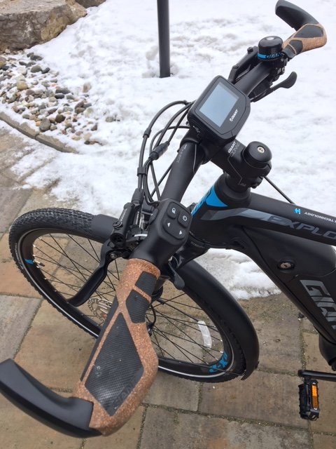

the 2019 Explore E+ 1 GTS (in Canada anyway) has the grips shown below
Part of that looks like cork! Is it some kind of rubber? These do look different (maybe it's the color) from the E+ 3 that I tried. Is that the RideControl EVO?

The grips are like a cork / rubber composite (not sure if its real cork) - but I find them very comfortable. I did need to play with the up-down rotation of the handle bar to get an angle which didn't cock my wrists too much that I was getting numb - but it was a dead simple adjustment to make and its been good since.
