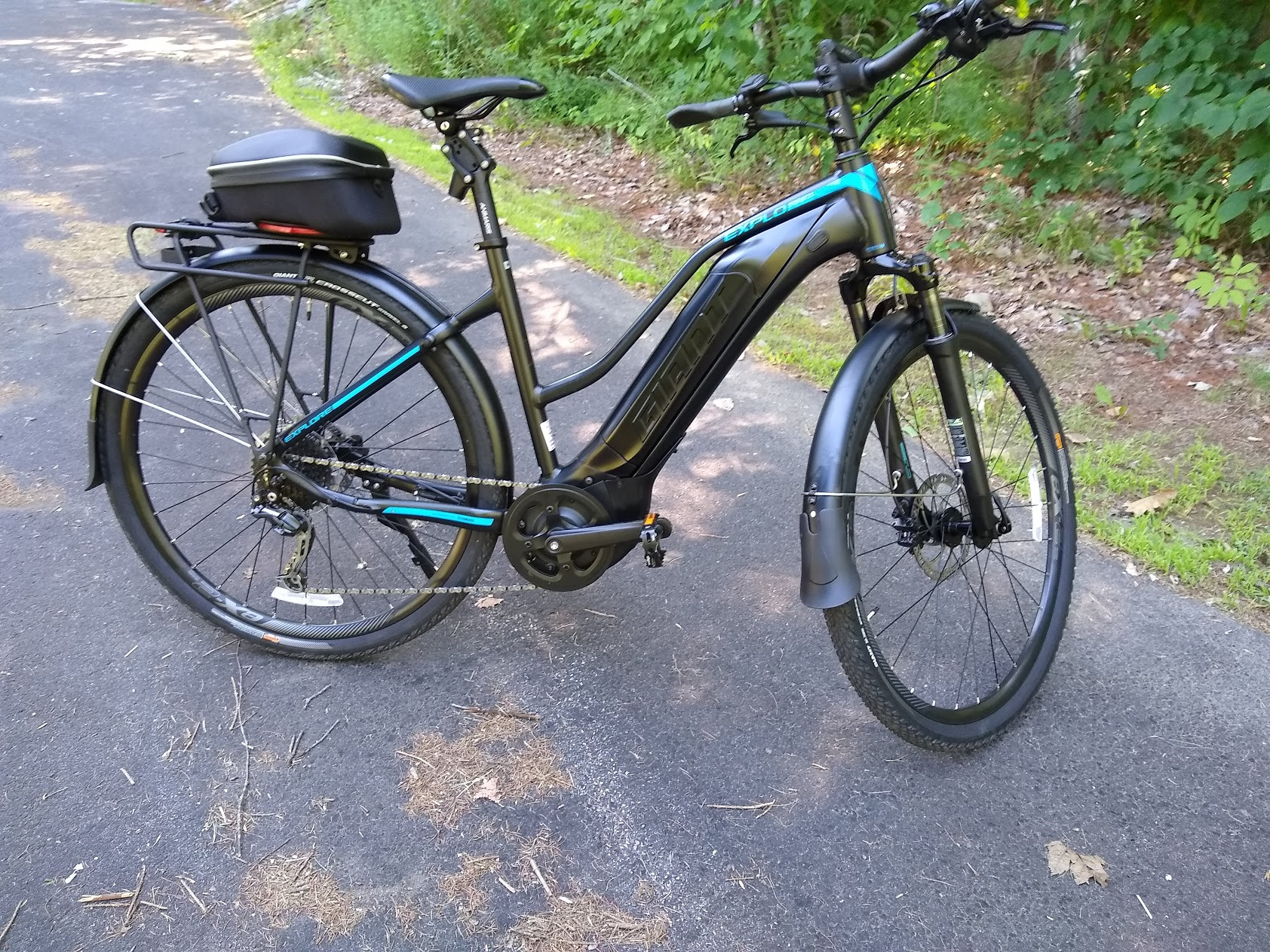

My Explore E+ 4 with factory fenders, rack and suspension post. This (4) is the only 2020 Explore E+ model available in the US. There's no chance the US will get the E+ (1 or 0 Pro) models but they look sweet,
When you say "factory fenders, rack and suspension post", are you saying your bike CAME with those options? Or that the dealer added them afterwards? From the US website it certainly doesn't look like that model comes with any of that. Or that it's even available as an optional extra. And it's a bit hard to tell from the photo but is the rack only attached to the bike is one spot? I don't see an arm from the rack going to the upper boss on the chain stay.
Are you going to add lights?
