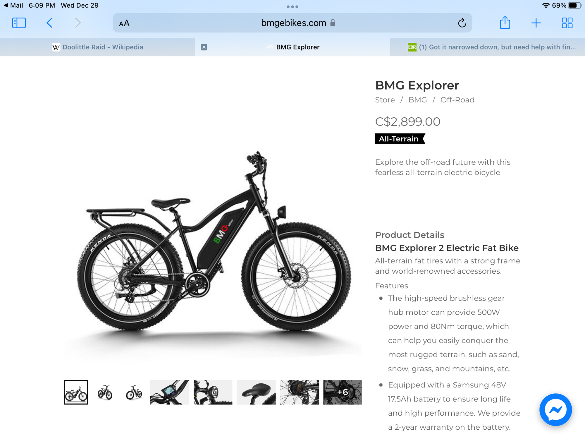

Well I did a test ride on the Pathfinder and this one yesterday. Came up a hill in 3rd gear, pedal assist 5 at 20 km an hour, with very minimal effort. Birth bikes got up to 32 km hr very easily.
I’m hooked, now just need to make it happen $$.
