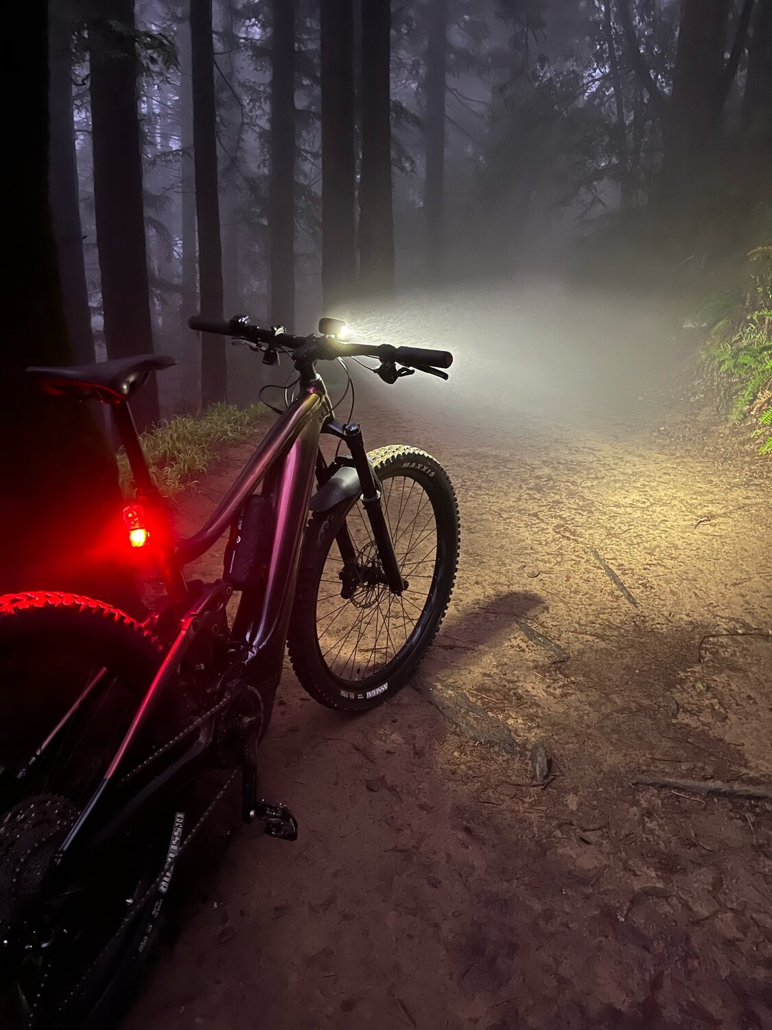

I think Giant has one wiring harness that they install in all their bikes, including Momentum and Liv sub brands. My Momentum Transend E+ didn't come with bike-powered headlight or tail light even though the Ride Control 1 handlebar mounted controller had a headlight switch. I removed the key and lock mechanism for holding the down tube integrated battery and discovered an unused connector that supplied 6VDC when the bike was powered up and the headlight switch was activated. I also discovered an identical connector under the mid drive motor, so I added a Light & Motion Nip&Tuck headlight and taillight.
Here's the writeup on installing a headlight with extensive photos I did back in the summer of 2020:
About a year ago I decided to install the Light & Motion Tuck taillight. Here's the instructions for adding the taillight. I eventually had the time to also swap out the cheap headlight I initially installed for the Nip headlight.
Here's a video of my bike with the Nip & Tuck, along with a lot of other accessories.
I installed a Magicshine 2000lm e-bike light on my 2021 Trance X E+. It was pretty easy, the light came with a Giant-specific cable and it simply plugged into the harness. I had to pull the battery and lock mechanism to get to it. Here's the light I purchased. ME 2000 with Yamaha cable.
