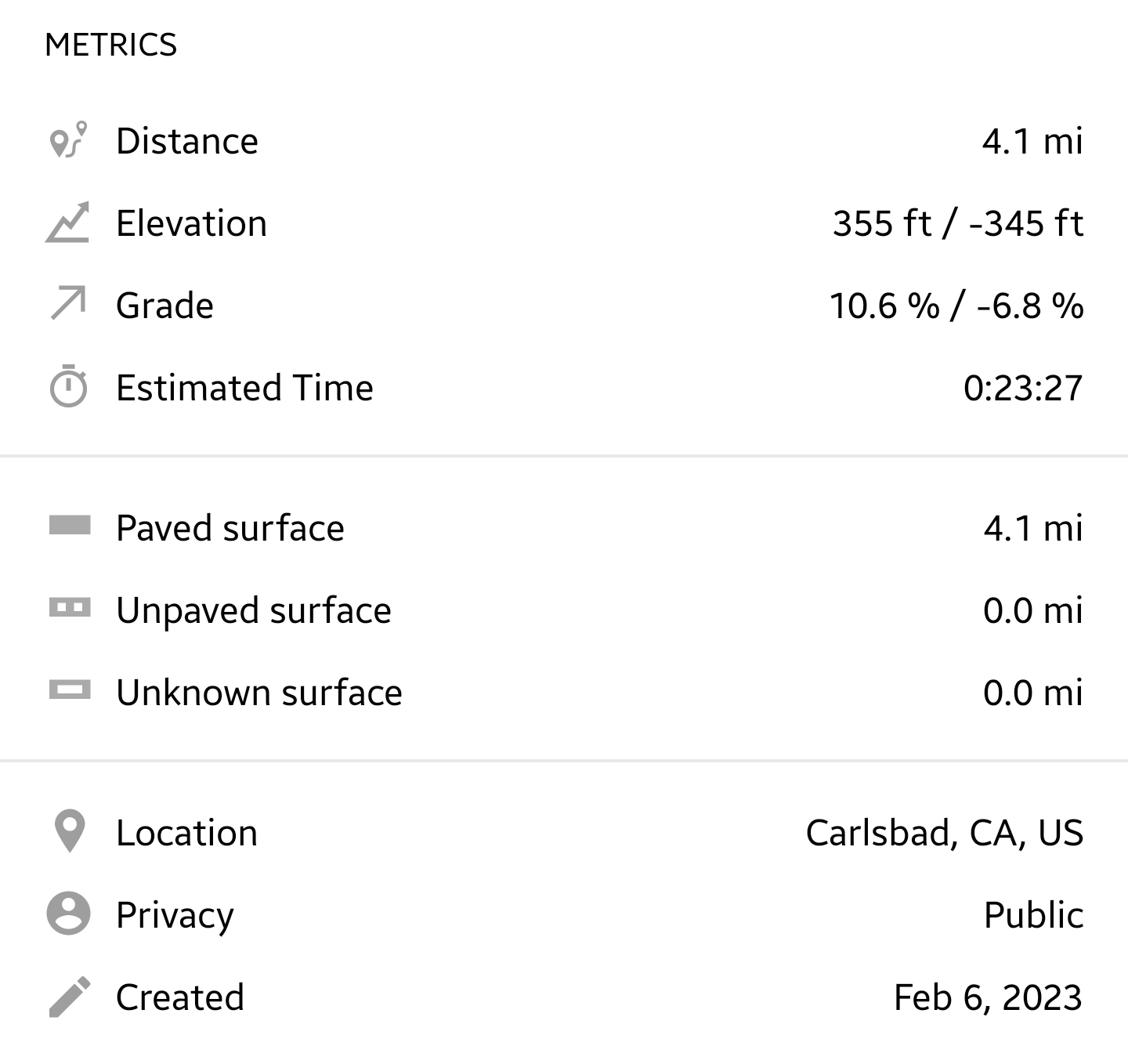

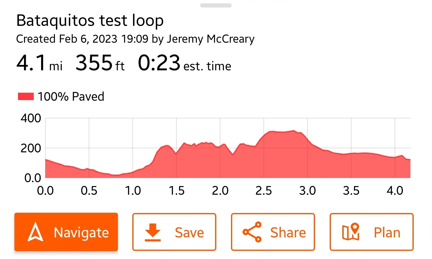

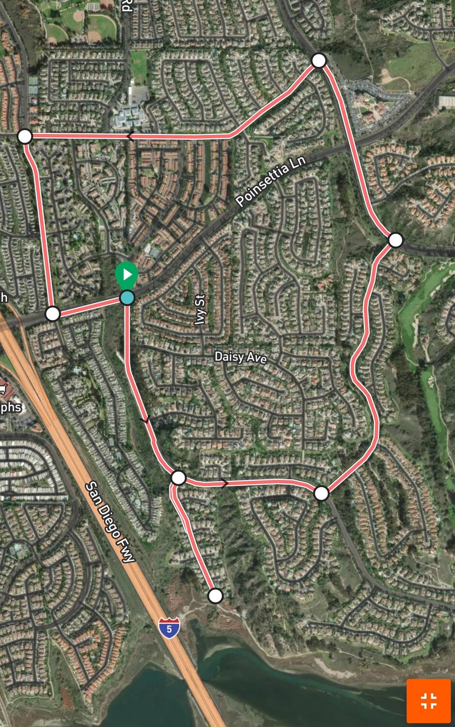

The good news: This thread pried me away from my old-guy old-school thinking and got me to spring for the basic RideWithGPS membership. That opened up all the tools I think I'll need to develop a feel for the grades I'm on in real time.
Toward that end, I planned out a nearby 4.1 mi test loop with 355' of climbing on (now known) grades up to 10.6% when ridden counterclockwise.

Did 4 laps on the loop yesterday -- the first 3 at PAS 1/9, and the last with more assist on the steepest climbs. Having studied the grades before and after, I now have some feel for at least the steepest parts.
If I want the grade I'm on at the moment, I'll have to stop and get out my phone (still waiting for Mous to make a Note20 Interlock case). But would have had to stop for any old-school method anyway, and RideWithGPS is probably much more accurate.
