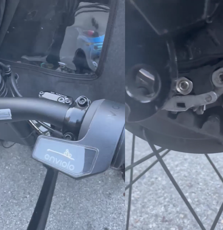

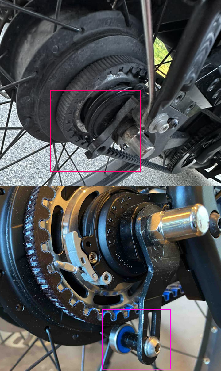

Hello,
This used Triobike Boxter cargo trike sports a Brose mid-drive motor, 50/24 cogs, an Enviolo Heavy Duty gear hub, and a Gates belt drive.
There are three issues:
  1. The user complains about having to pedal too hard up hill, even though someone she knows with the same bike — ie. same motor, same Enviolo, same chainring + sprocket — doesn't have that problem
  2. She also complains that even on the flat, she has to set the motor to Turbo, without even being able to turn the shifter all the way ("flat" position on the indicator)
  3. Lastly, what is that part for? Could it be a missing thingie to keep the belt in place — doesn't look like a tensioner, since that's achieved by loosening the two nuts on each side before moving the wheel forward/backward
Thank you.

On your top half of the photo, the top black thing extending downward with the hole at the botom is a deraileur hangar.
On the bottom hald of your photo, that device is a "snubber", to keep the belt tight and prevent it from slipping off the cog.

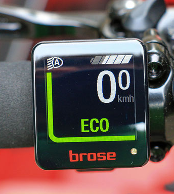

Edit: Is there a way to show the Brose software version on the display?

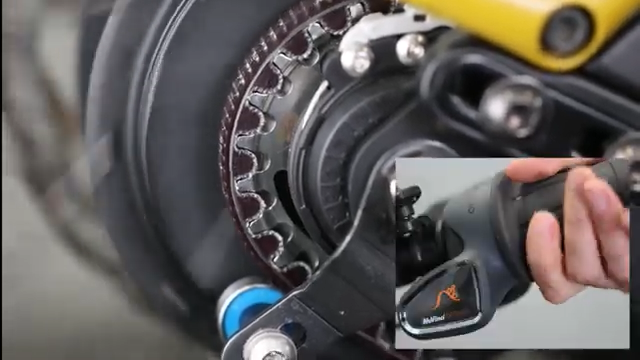

To check if the issue could be with the shifter, the cables, or even the fasteners wrongly set at the end of each cable… is it possible to manually dial the interface, eg. move it to full underdrive before riding up a hill?

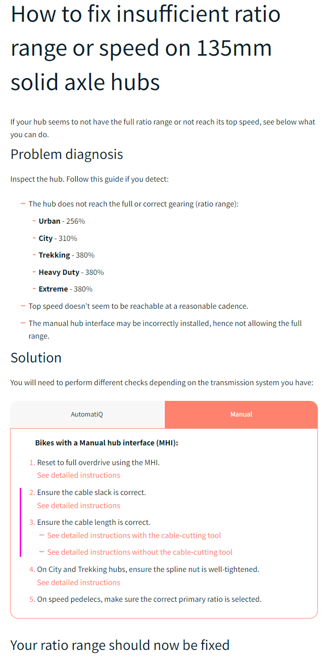

There are a few threads here about enviolo shifting fixes.
It does sound like badly adjusted shifter cables and or frayed cables.
