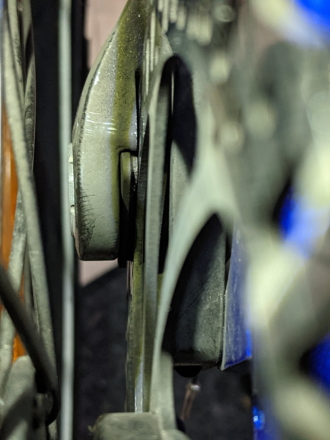

hello all i did major cleaning of my chain and than cleaned my brake rotors with rubbing alcohol. I took the bike out for a spin and didn't notice it until i was pretty long into the ride, but the front brakes were not grabbing at all, just cutting off the motor. I made it home using the rear brakes but i can't seem to find out whats wrong. I can squeeze it and not have the brake handle hit the handlebar, and i tried readjusting the cable at the brake end but that didn't help, it is stopping at about 5% of the total stopping power, almost no stopping. I tried doing the steps to center the brake pads but that did not help. I couldn't really find any solutions easily online, im thinking maybe the brake pad has gone dirty? Could i have worn out the pads already at 1000 miles? I think i tend to use the front brakes more than the rear just because i am left handed and prefer braking with that hand.
edit: i watched the video at reply #6 in this thread and was able to push out the inner pad towards the rotor using the adjuster and was able to fix it. Thanks for the replies. I had a brain fart and couldn't figure out what was going on. I am new to disk brakes and have only had experience with v-brakes.
