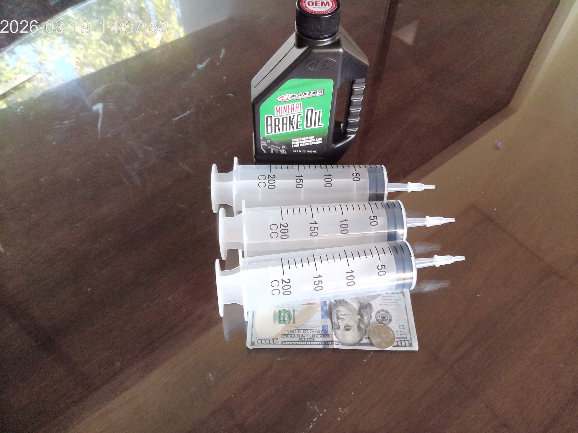

I just purchased these large 200 ml syringes to help. I do not care if I waste a little fluid. I want all the bubbles out fast.

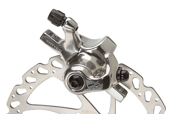

I just sold my analog cargo bike but before doing so stripped off the Avid Mechanicals and installed new Magura hydros. Good riddance.
The electrified cargo I'm building now was the donor of those Maguras, and I'm treating it to a set of Paul mechanicals.
I don't "hate" hate hydros, but I much prefer the simplicity of cable pull. I hadn't even thought about trying to get a long, heavy cargo bike at the correct angle for a proper bleed! Yeesh.
I prefer doing a dual syringe bleed over a lever bleed with a cup. I've found that once the majority of the easy air is removed, using one syringe to pull and the other to push helps get the last of the air out.
Any chance that you could post a step by step tutorial on this method?
Me too. Having both pressure and suction really works to force it through.
Really good mechanicals are really good. Just tighten the inside pad after a big ride until it touches and then back off a quarter turn.
