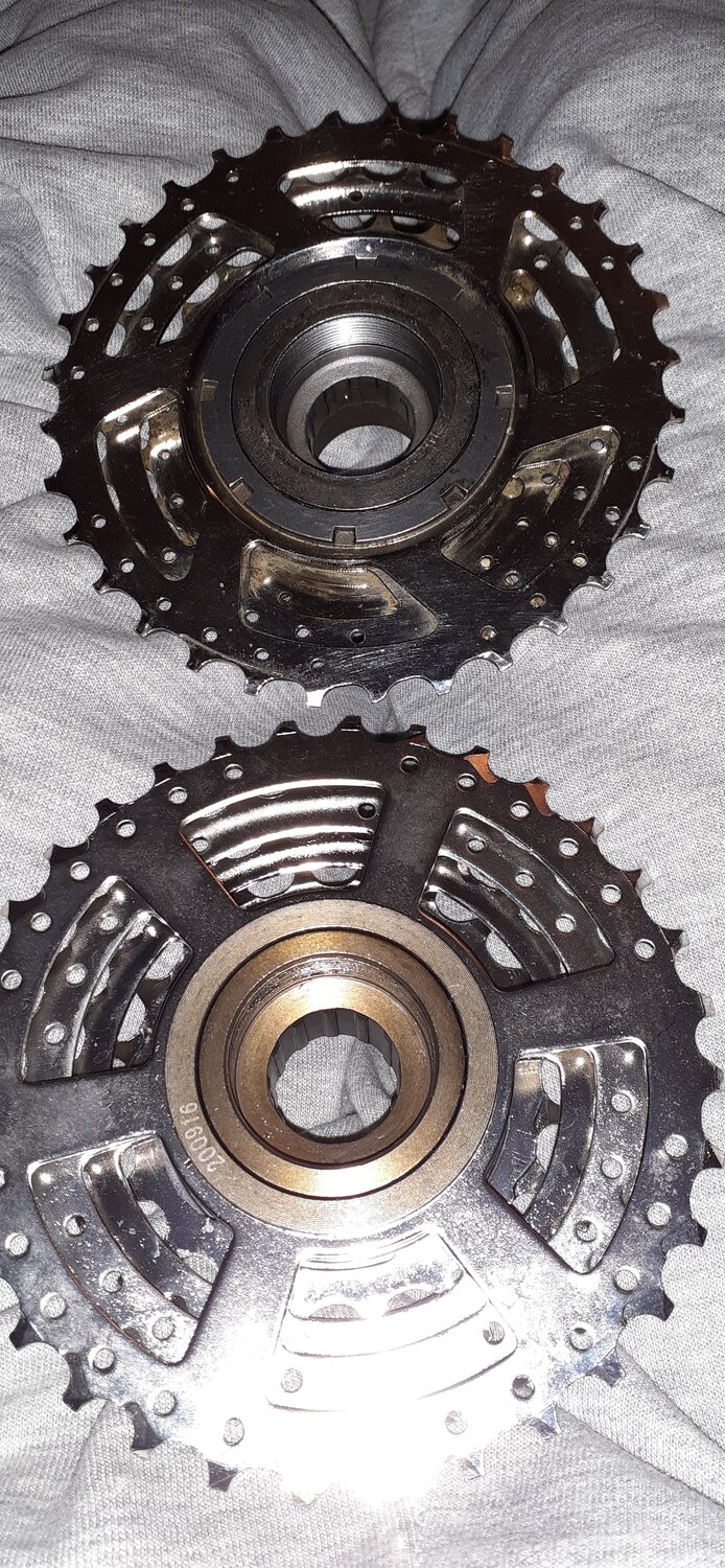

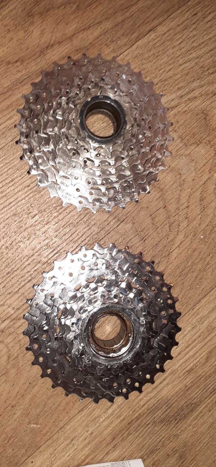

A bit off topic,but wonder if anybody can advise me,just ordered my 3 cassette for moscow+,its arrived,it looks like a part is missing,maybe it will attach & work all the same i dont know,heres the picture of new & old cassette,old cassette at the top(has black part in centre) new doesnt have this,its a drift maniac 8 speed 13- 32,on ordering it had exact same freewheel description,any advise i'd be grateful,thanks

The old one you have there looks like 11-32 and not 13-32. I think that extra piece is only on the 11-xx ones for structure or something. I haven't looked too closely at it. You may want to return for an 11-32 because you'll "run out of gears" 15% faster, or so, with that freewheel so your legs will be spinning faster at the highest speeds than if you had the 11.
Not 100% sure but the one on the bottom looks like it is a 13-32 cassette vs the original on the top which is an 11-32 Freewheel (not a cassette). You need a 13-32t or 11-32t threaded freewheel. Does the bottom one have threads when viewed from the back?
13-32 freewheels are easy to find and cheap ($35) but 11-32 freewheels in 8 speed are harder to find ($60). 11t is a big improvement over 13t unless you prefer cycling with a higher cadence.
Thanks for reply& thoughts,yes i made the error,wasnt thinking straight earlier,what i needed was an 11-34t ,the back off new one has the threads& almost identical apart from it doesnt have the 8 notches on the surround as u can see in picture,new one on the bottom of pic,thanks again for helping me out,i will send it back & hopefully just pay a few more £'s difference to get the one i need
