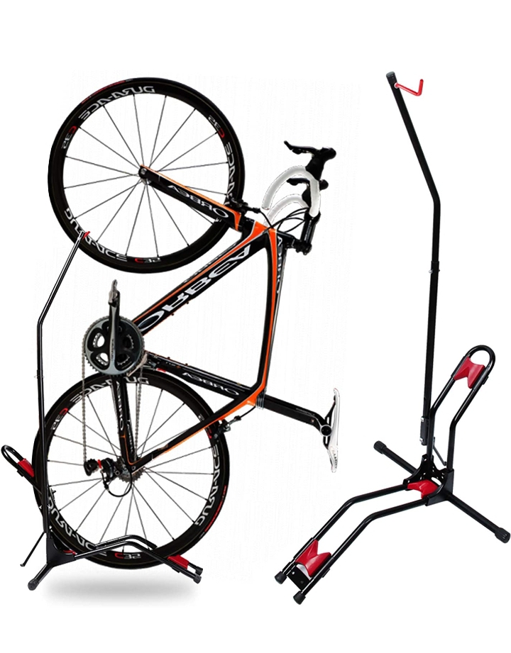

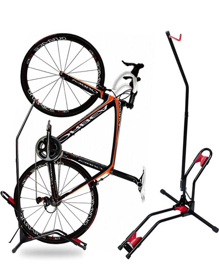

I've looked at this one a few times. Good price, good reviews and has a weight capacity of 66 pounds, 30 kg.
JAPUSOON Vertical Bike Rack Free Standing Adjustable Bike Rack for Indoor Mountain/ Road Bike https://a.co/d/1vQZLTq
I had a close look at that one. It'd work fine for my partners bike. The fenders on my Explore and the 49.5" wheelbase on my e160 knock it out of contention for those two.
Sigh, I think I'm going to have to conceded the product I'm after doesn't exist. I swear - this is how people start their own companies. I can see the design in my head, I just don't have the engineering smarts to make it happen.
