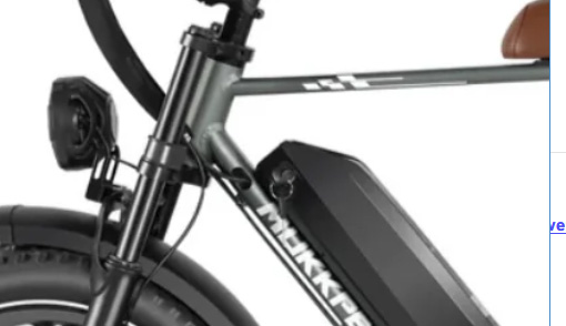

Thianks for listing the name of the perpetrator. US sold bikes risk a huge tort penalty for failures like this. My aluminum frame bike has 12000 miles with loads up to 240 lb. I bet Mukkpet US assets include a cell phone and a website on leased server space - ie nothing to liquidate if you win a lawsuit. Buy a major bike - Giant, Trek, Specialized, Gazelle, Cannondale, Kona . Or put up with junk like this.

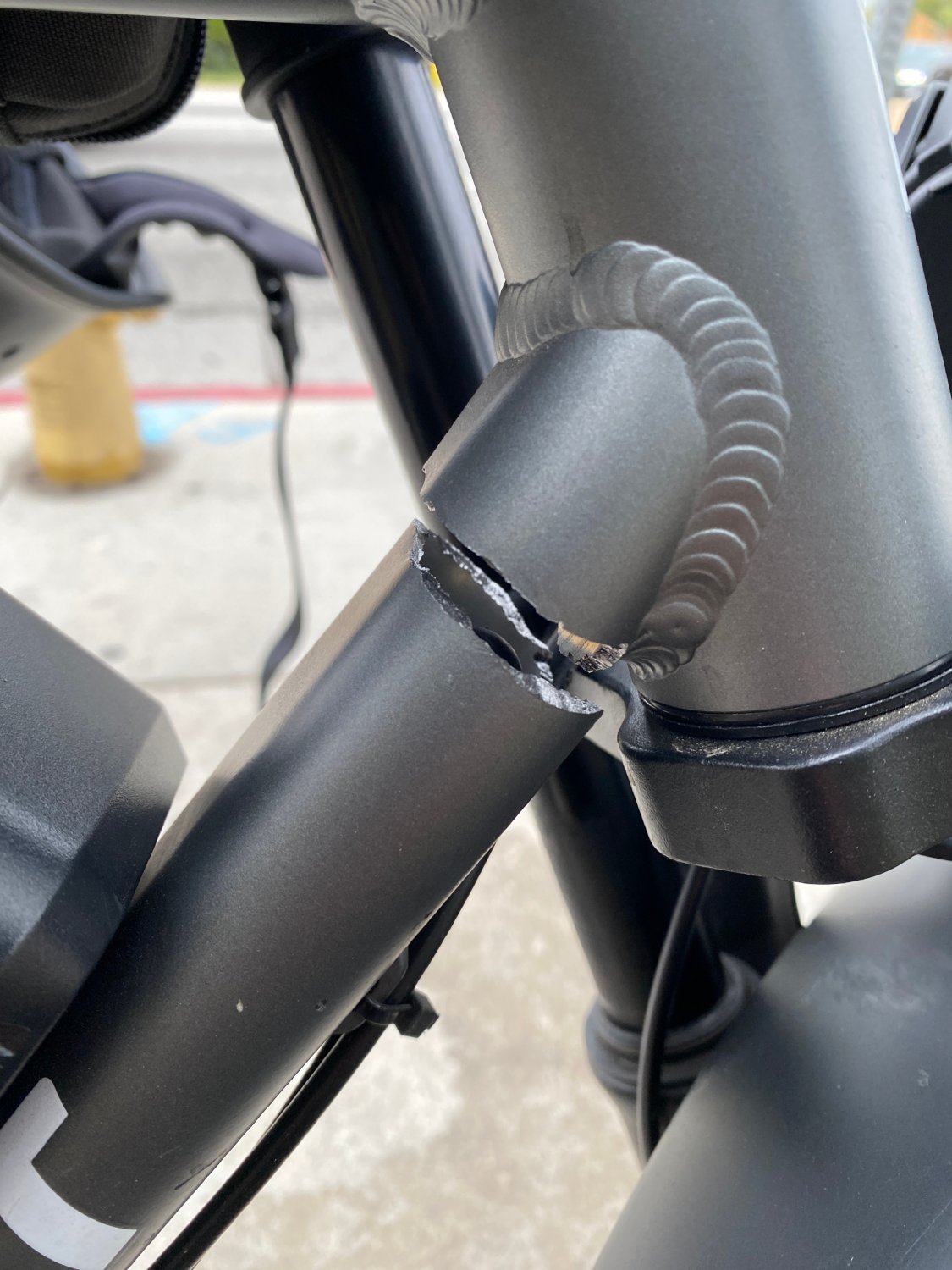

Riding to work and suddently things got way too bouncy! About 6mo old. About 1500km on paved roads. Seems aluminium may not be a good choice for bike frames. Anyone else seeing this happen?
Just because welds are "pretty" doesn't make them strong. The bottom side of that weld is the highest stress point of the tube junction. It looks like that's exactly where it broke. Once there is any kind of movement in a welded joint, no matter what the material, it will fail. In this case, it looks like the tubing failed after the weld broke and allowed movement in the joint.
The better aluminum framed e-bikes use hydroformed aluminum sheet, not tubing, in the high stress areas.
So, @Curtech , it looks like you have a 1yr warrantee.
I agree with what these guys said about the tubing looking not “beefy” enough for a typical aluminum frame. Anyway, good luck with your claim!

yikes that's scary, been biking my whole life and never had a frame crack (just by saying that itll probably crack tomorrow on my ride), good luck with a warranty claim. i'm pretty sure most bike companies offer lifetime warranty on frames and this sure looks to be a quality issue and nothing done by you of excess wear and tear.
Bike replaced under warranty last week. Fingers crossed this one lasts longer than the last one. Looks like the controller and display have been changed. Same otherwise. Offered to take the old bike myself to the local distribtion point to save the company shipping (both ways). About and hours drive each way. They of course accepted. When I asked if I could keep a spare battery for saving them $400 in shipping, they flatly said no. Would have been a nice gesture. Disappointing but I suppose not surprising.
