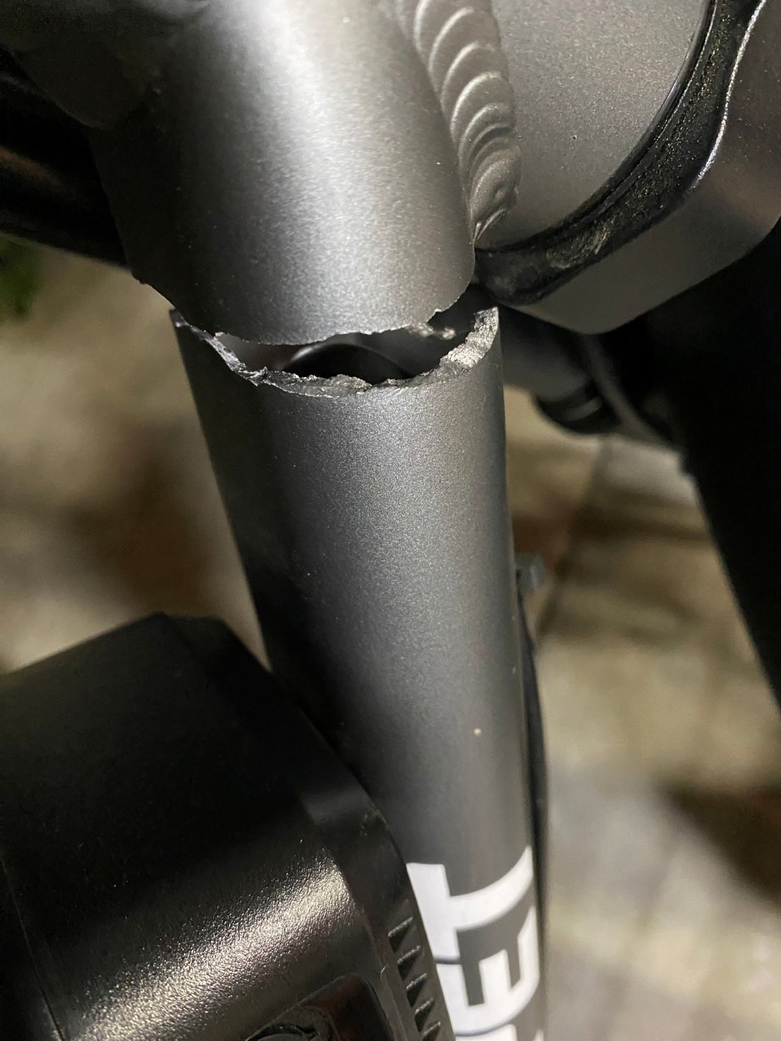

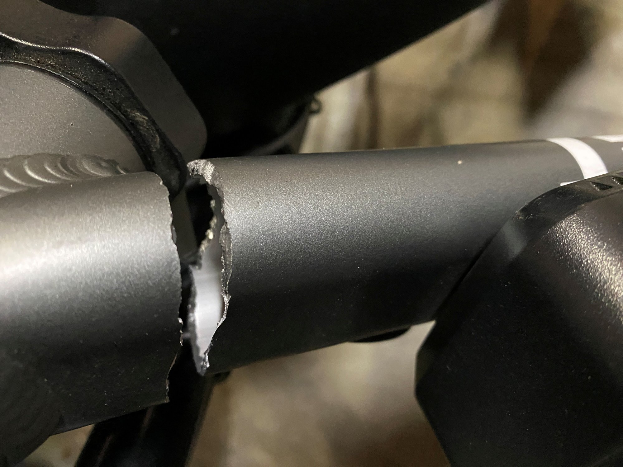

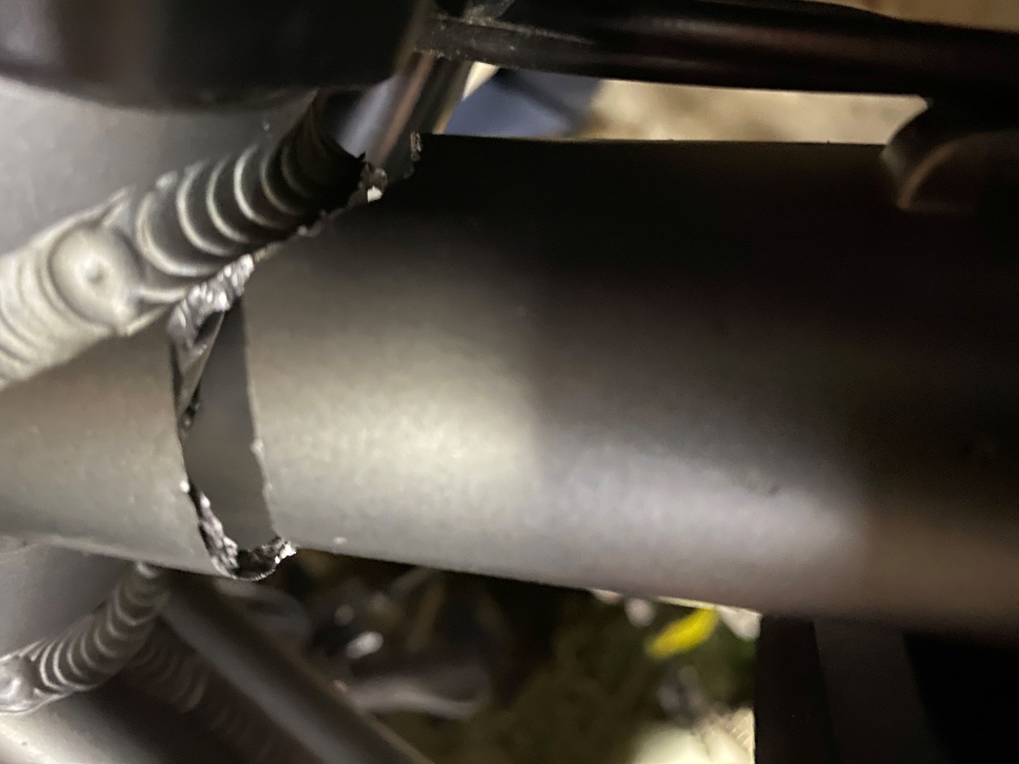

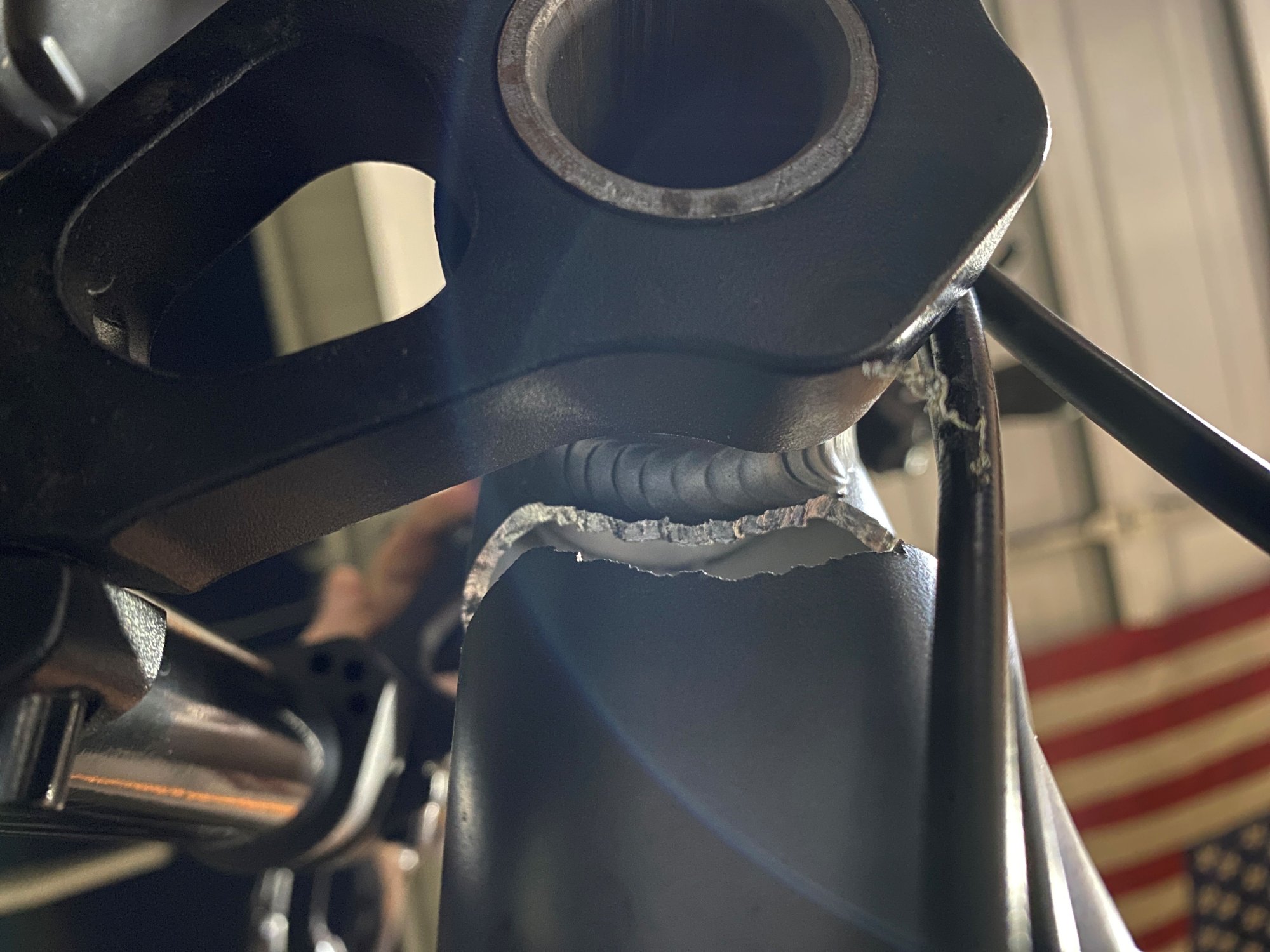

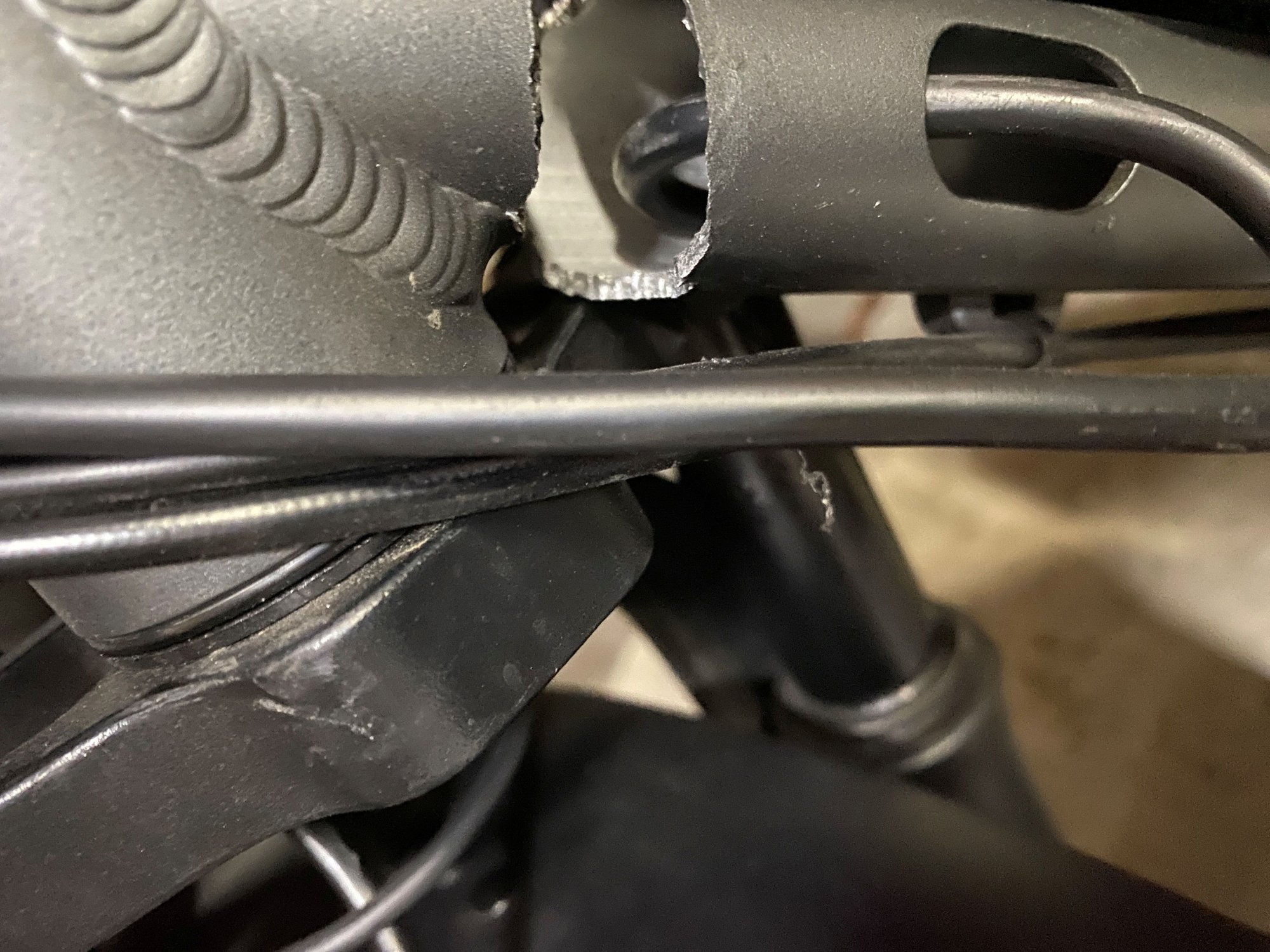

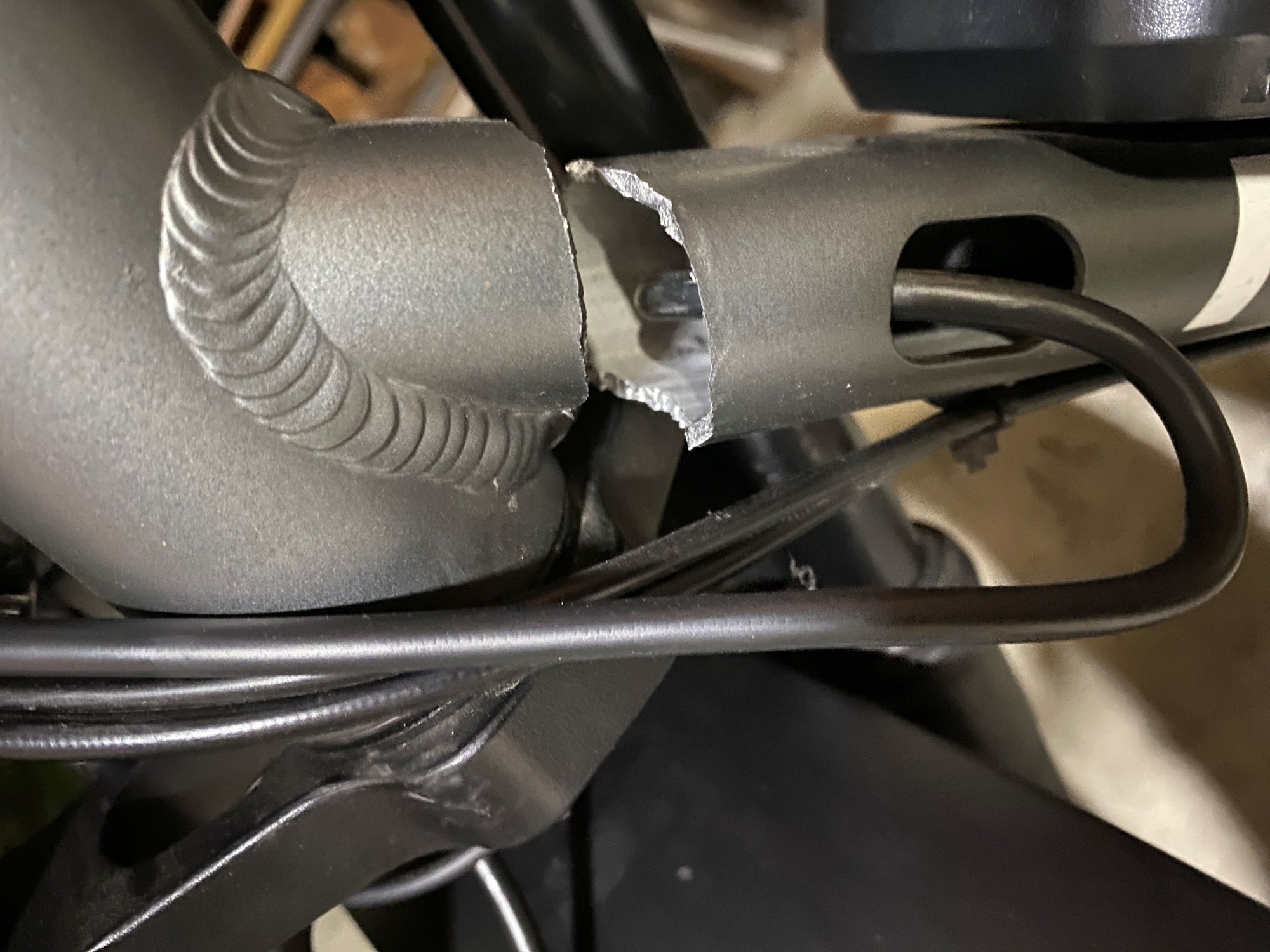

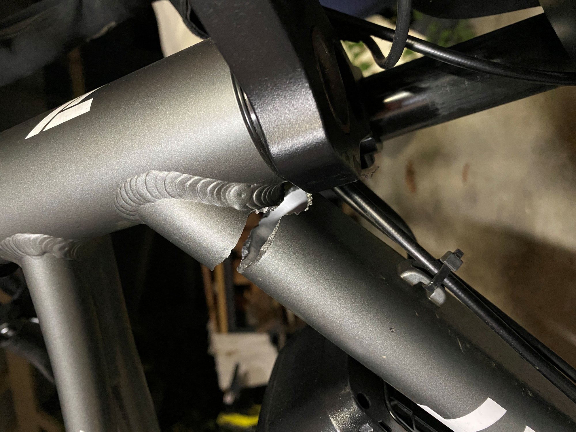

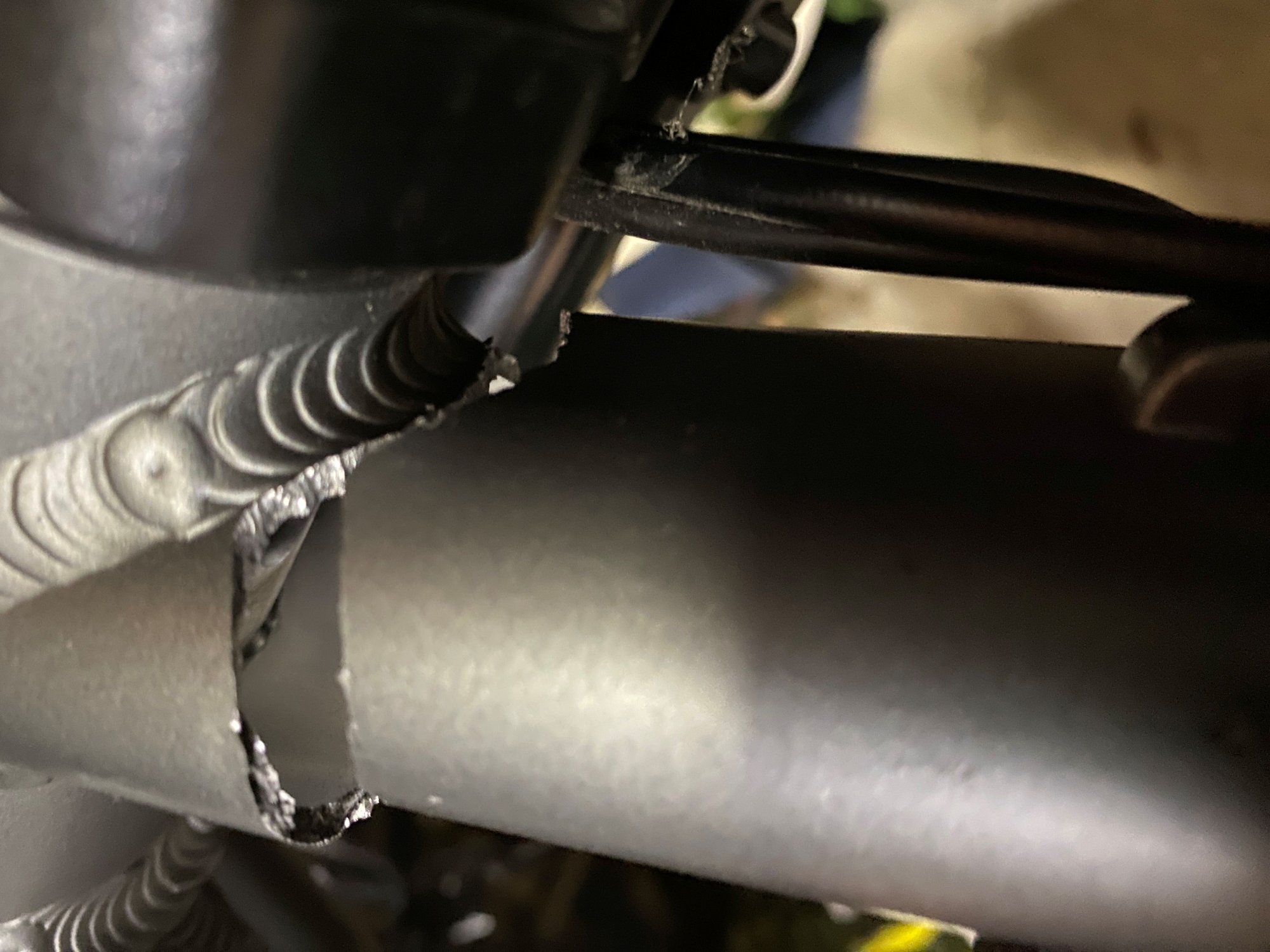

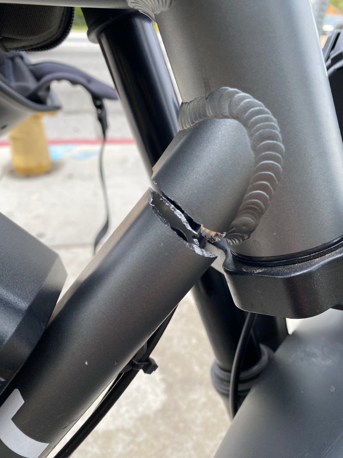

Riding to work and suddently things got way too bouncy! About 6mo old. About 1500km on paved roads. Seems aluminium may not be a good choice for bike frames. Anyone else seeing this happen?
Just because welds are "pretty" doesn't make them strong. The bottom side of that weld is the highest stress point of the tube junction. It looks like that's exactly where it broke. Once there is any kind of movement in a welded joint, no matter what the material, it will fail. In this case, it looks like the tubing failed after the weld broke and allowed movement in the joint.
The better aluminum framed e-bikes use hydroformed aluminum sheet, not tubing, in the high stress areas.
So, @Curtech , it looks like you have a 1yr warrantee.
I agree with what these guys said about the tubing looking not “beefy” enough for a typical aluminum frame. Anyway, good luck with your claim!
