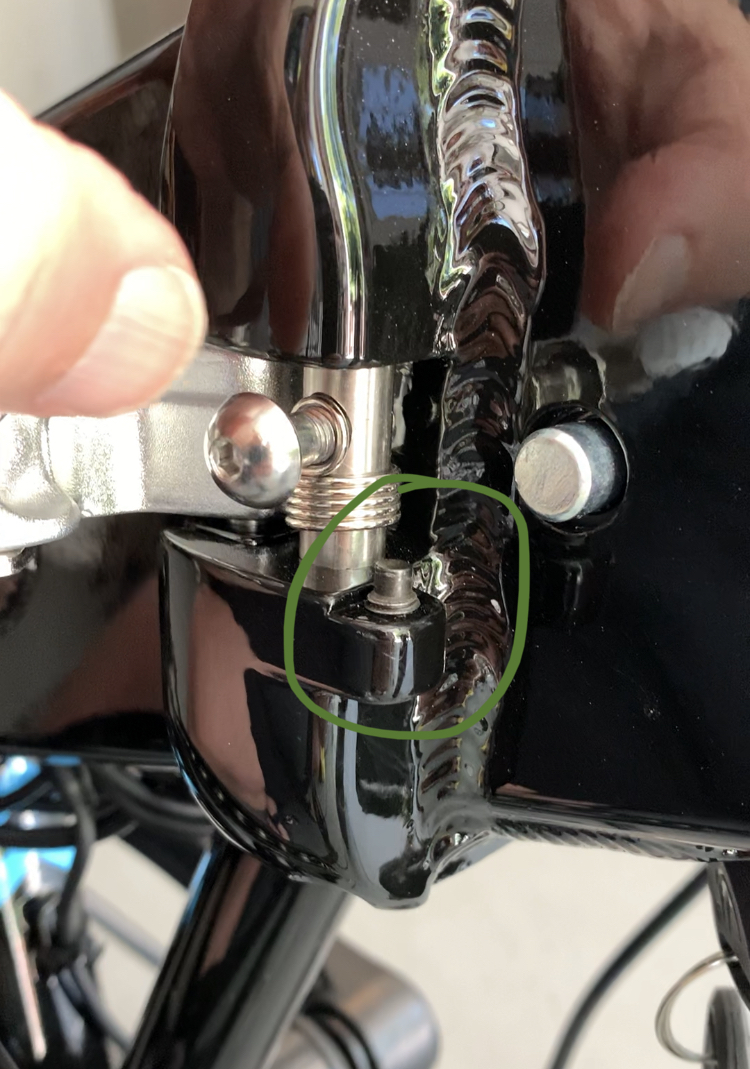

I recently received my bike and while riding I looked down and the bike frame had come totally unlocked. Luckily I stopped and locked it before crashing. I was really careful after that but now I am slightly paranoid. The lock snaps to the frame but moves away after only a few feet of movement. Does this look correct?

Did you try adjusting the screw thats inside the locking mechanism? It looks to be adjustable...

Nonsense! Conclusions drawn on what? A close look shows the same latch on the step-thru, except it sticks out even further! An allen wrench and a few minutes is all that's needed to correct it.

I contacted Lectric and they emailed me pictures and instructions on how to adjust this. They said I should be able to fix it unless the safety pin was broken. Luckily it was not and the adjustment was simple. It took longer to find the allen wrench in my mess of a tool box that it did to adjust :)
I adjusted the nut and now its super tight when closed. Lectric was great, They sent me pics and thorough instructions on how to remedy the situation.

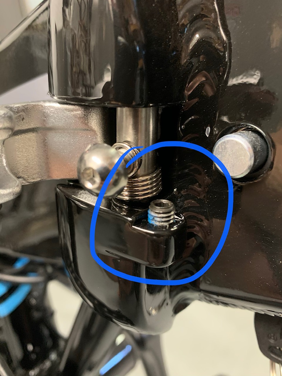

Had the exact same issue, thought I must not have latched it correctly the first time but it kept happening - definitely was not hitting it with my leg.
Went for a 1 mile ride on smooth road and it popped open about 6 times.
Called Lectric, they were great - Do not try adjusting the big silver screw, that doesn't help.
  1. There's a small black set screw, basically unscrew it from bottom with allen wrench
  2. Reinstall "upside down" from the top (leave about 4-5 threads exposed)
Took about 2 min. This provides a little more for the latch to grab onto and it didn't happen again on a 5 mile ride last night.

I had the latch open up on me going 20+ mph . The bike started going sideways like a rear flat but it was the frame opening up ! Thank goodness the bike electrics stopped once the hinge opened up . I made it to the side of the road without wrecking but that could have been bad . I did what you said and put the set screw in from the top leaving 3 or 4 threads showing (that works). Going to pick-up some Loctite too...

Before Picture

Also... Just backing that screw out a little bit made my latch thingy tighten right up.

But I can still pull my latch out like in MrFixit's pic.
