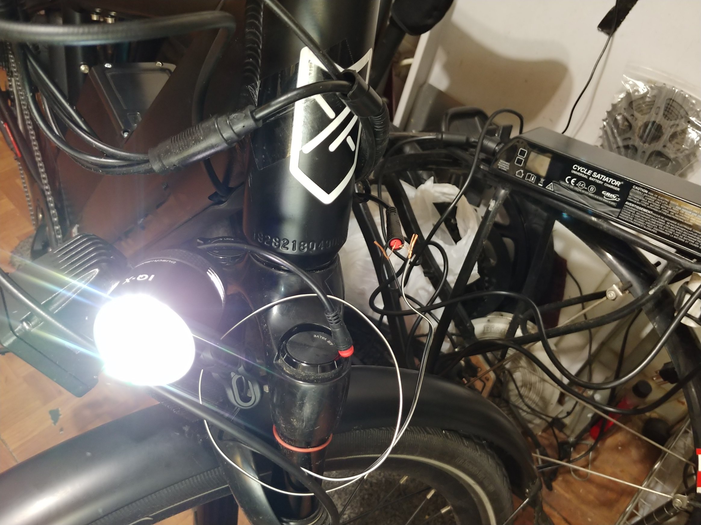

Bought online from one of the German bike shops. This is made in Germany & feels like half the weight of the stock light. Waiting on Higo connector from Ebay & then Harbor Freight for some cheap tools & waterproof connectors to make the connection.

Got connectors in but the wire gauge was really small & they were advertise as for brake cutoffs. Reordered from the guy who advertised here & hope those are bigger. Made a makeshift connection with some needles just so I could use it in the meantime. May do a taillight too some time down the line. I actually have B&M one from my first ebike & tried it, but I think I blew it out from too much volts. There is an extra cable in the IQ-X package which seems to be for a taillight, but the light doesn't have an output for one.
Pros:
Light weight around 100gram vs 260 of the stock light.
Made in Germany
Looks nice & feels like quality.
Beam cutoff so drivers don't get the full blast of light.
I swapped to a Rock Shox fork & B&M offers a special mount for it.
Cons:
The stock mount didn't hold it's spot very well to bumps. Removed the extra pivot points & attached directly to mount on my Rock Shox fork.
The light has no rotational adjustment & with it rectangular beam it can be annoying if it's not square to the road. Can possibly be modded to fix. Also helped a bit by tightening the front ring lens holder more.
The beam is narrow. I would prefer more spread up close. Would be good to complement with a 2nd light.

I ordered Higo connectors from member David E. that advertised on this forum. I just received them today and they fit just like the OEM connectors. I just have to wait until the B&M IQX arrives.
